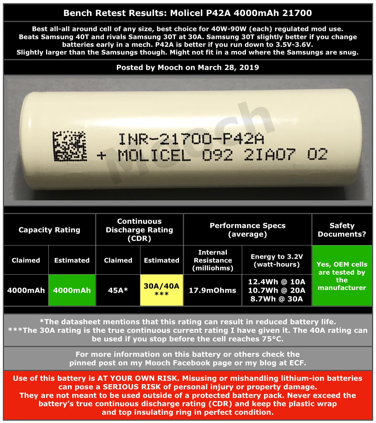

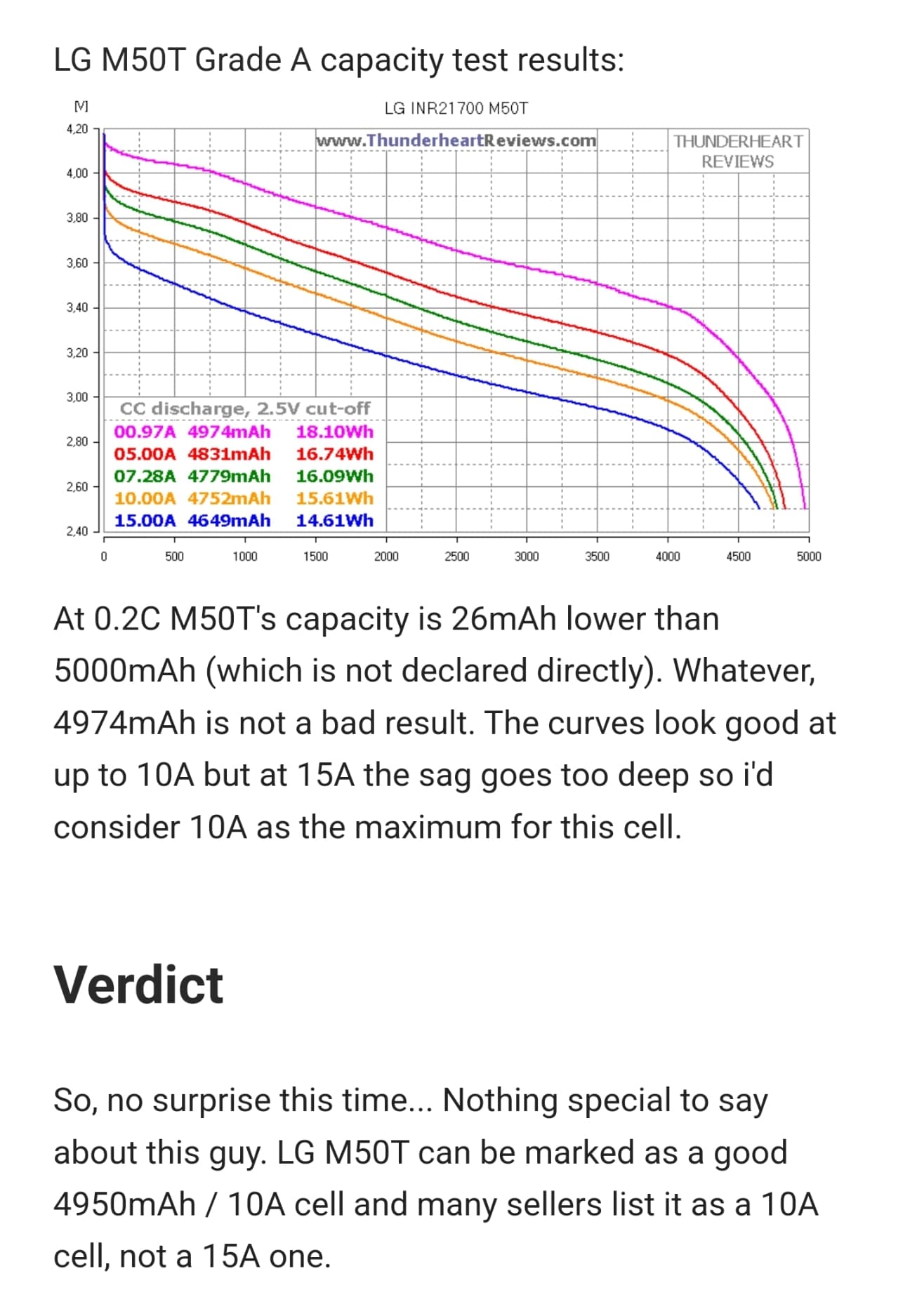

First of all, according to the test data you linked, that “4600mAh with 15 Amp discharge” is if you are discharging all the way down to the cell’s 2.5v cut off. Most esk8 battery systems use 3.0V/cell as the hard cut off, which would give you more like 3100mAh according to the test results.
It’s also going to cause a nearly un-usable amount of voltage sag, so no matter how many mAh it actually delivers, the watt-hours that it delivers will be dismal. Wh (watt-hours) are actually the important spec to look at for building an EV battery, because Wh take into account how well your pack holds up it’s voltage and therefore how much total energy it delivers.
You can use a cell with 5000mAh rated capacity, but if it only delivers 10Wh at the discharge levels you expect to use it at, then you would have been better served by a lower capacity higher current cell.
This is why nearly everyone in the DIY esk8 market is using the Molicel P42A. It simply delivers the most Wh at the discharge levels that we normally see in an esk8.

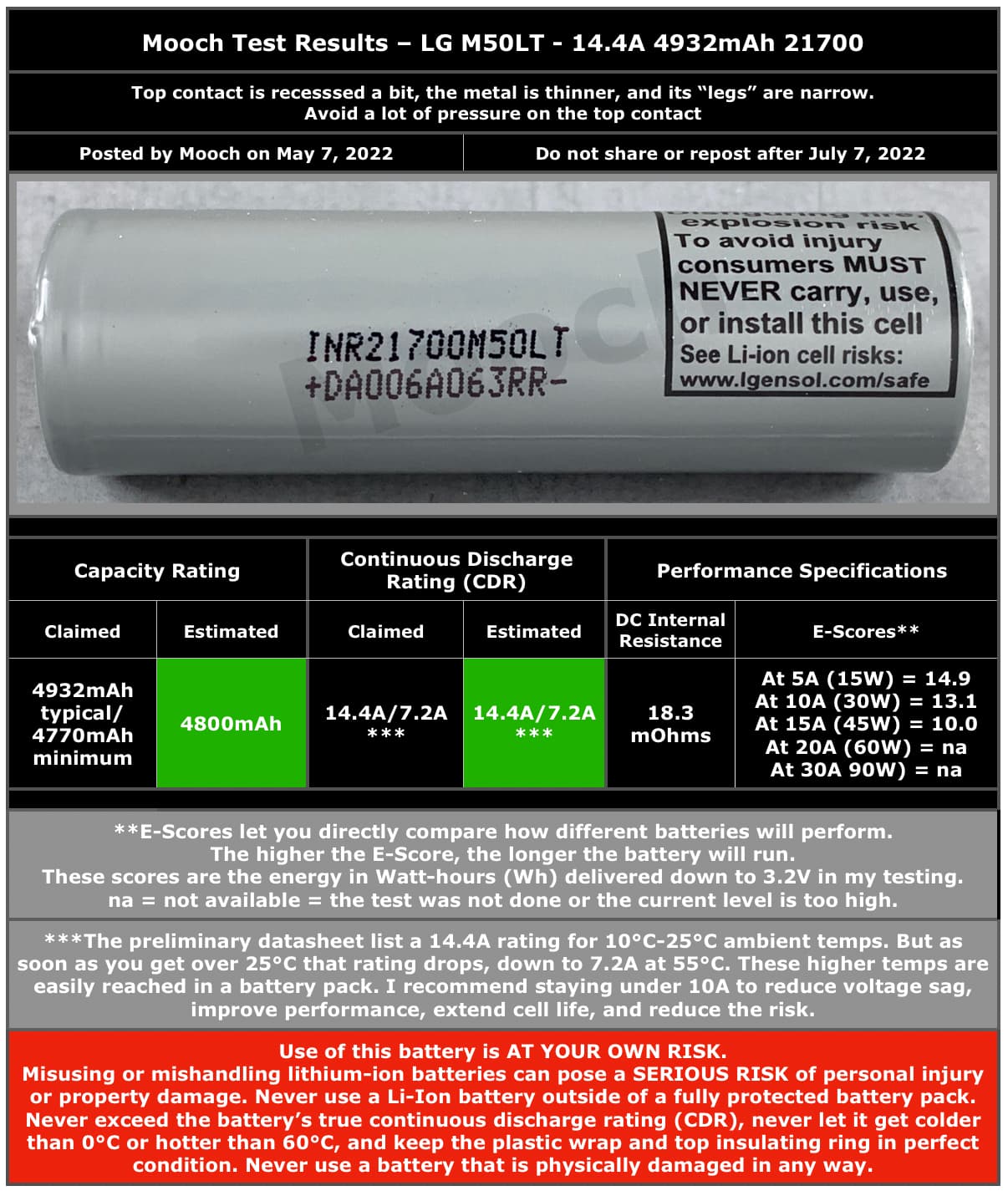

Check out these two test results sheets from Battery Mooch:
First off, the M50LT is actually only rated by the manufacturer for 7.2A discharge if it’s over room temperature (25°C). Inside of a battery pack (unless you are installing active cooling) it’s pretty safe to assume that your pack’s running temp will always be at or above 25°C.
If you disregard that rating and run the cell at 15A anyway, not only will you be degrading the cycle life of the cell faster, you will also be getting a massive amount of voltage sag and a very poor energy efficiency from these cells. According to Mooch’s test, you will get 10.0Wh delivered @15A discharge.
Compare that to 10.7Wh @20A discharge on the P42A, and you can start to see my point.
To your point of this build using small motors, if you built a 12s4p with M50LT’s and ran them according to the manufacturer’s rated 7.2A/cell, then you would have a pack which performs ok at 28.8A max discharge. That’s 14.4A per side. I doubt that would provide a thrilling ride for the user, small motors or no.
Turning up the current above that safe manufacturer’s rating may result in a slightly more fun ride… as long as the pack is fully charged. As soon as it starts getting a little lower in the discharge cycle, the voltage sag will outweigh the higher amperage you programmed, and you’ll end up right back in the same boat.
Your M50LT cells are not garbage. They are an excellent cell. Just not in the pack configuration that you are considering. You will be much better off saving these for a different pack configuration, or for an application that has a much lower current draw than esk8.
