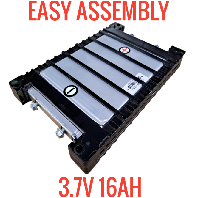

Hi guy’s long time no see but back I am with question about a battery build,so long story short I am building a 2-wheeler and am looking for a battery DUH lol so I’m looking for some sort of pouch battery with at least 20Ah and that can do 50 or so amps discharge continuous.
I would go with P42A’s but I want to try something else so I want to see my options in price/performance so maybe you’ve got a trustable seller/site for those, if so I’d love to know which one you might have in mind!

SPIM08HP are probably the best bang for your buck in terms of capacity per dollar. Two 8AH cells in parallel for $8.50, plus cell holders and bolts included. Rated up to 200A each/400A for the pair.
Im building 3 packs right now with the Lishen LR2170LA (4000mah, 35A peak) and I got them for 66% the price of P42as and they’re supposed to be about 15% worse than the P42as. No logs as of yet, but can get back to you.
I considered it one of the best option but being ‘second hand’ kinda scares me to be honest.
@itsrow if they end up being nearly as good as P42A’s might consider it for another build :man_shrugging:
I’ve never used the spim08hp cells, but I bought a bunch of e-scooter packs with LG M26 18650s from batteryhookup, and they performed exactly as advertised. According to them the spim cells were only used for battery backup so they have very little mileage on them and should be close to brand-new, perforance and cycle-life wise.
If I ever get around to building an e-motorcycle like I keep dreaming about, I might very well use those.
only down side I’ve heard from other groups on facebook (e-bike/e-moto) about the Spim08hp are that they can degrade very fast, it can be either a hit or miss. maybe it was only from a bad batch or just badly built battery packs, just gave me a slight ick tbh.
