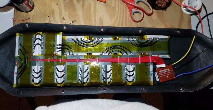

Hello, a friend had got a new Hurricaine and basically his maiden voyage was at esk8 con. Several times the power would just cut off. He had some other battery with him. Swapped it out and all was good. He ended up getting a new battery from Meepo and no problems. I offered to take a look at the battery/ esc for him hoping to see something obvious. I opened her up I did not see anything yet. I did not take it apart apart just enough for a basic visual. Battery is reading 44.7V. Still have to hookup a meter and twist it a bit to see if voltage changes. Here are some pics.
Looks like the whole thing may be welded with copper. Balance wires overlap and are thin as shit and main leads are
12ga

Does anyone have any suggestions to test this Hurricane battery? I did not check voltage of the individual P groups yet. I was hoping not to have to take it further apart but it looks like I have to. I was thinking if P groups check out and all welds look good maybe just replace the BMS and bypass it.
Uploading: 20220529_152312.jpg…
Here is the original BMS
The busbars :exploding_head:
Would be curious to see a full teardown :sweat_smile:
You’ll be able to check individual cell voltages by very carefully measuring those exposed pins with your multimeter
Yall must have steadier hands than me. I know if I tried that it would 100% end with a burnt balance lead if not worse.
Lol if you slip, there’s every chance that you’ll cook some bms components. Not for the faint hearted, that’s for sure
Thank you! I will give it a go. I’ll actually wrap thin wire around a pin with some heatshrink and wrap other end of the wire to the meter probe end and still use a lighted magnify glass lol. Yes dont want sparks.

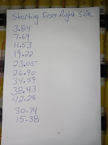

Could balance leads be mixed up. These are the readings starting frim the right. Double checked they’re correct
