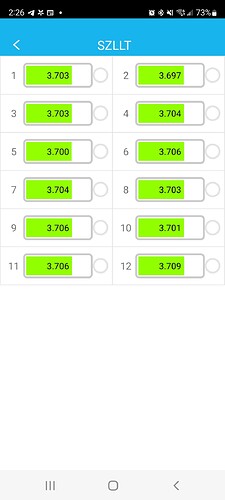

Is there a better app for the LLT BMS, or does it make any sense to go for the paid version of this one?
I use Carplounge.

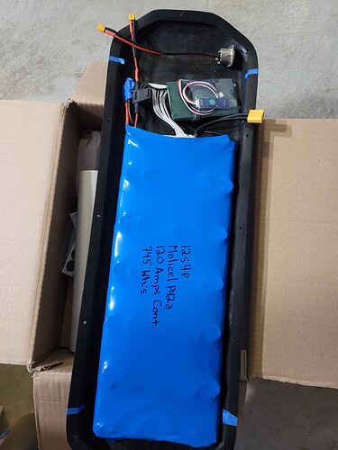

This is the third battery I’ve built and I’m pretty happy with the results. After the theft of my daily driver and the build I was 80% done, I’m really moving on this build. Need to skate… so fookin badly.
12s4p
Molicel P42a
Charge only bms
Loop key on main neg terminal

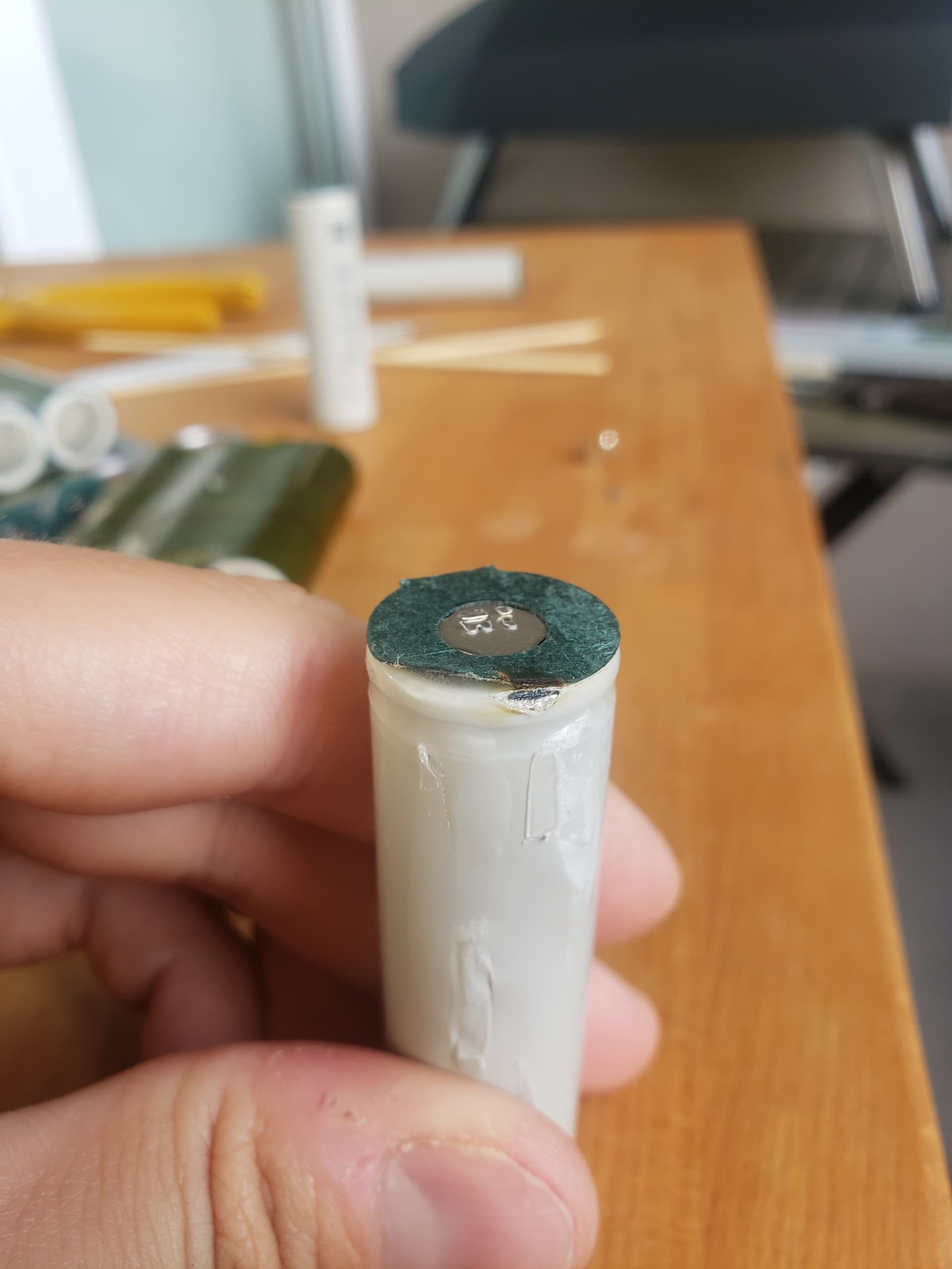

I was dismantling a battery pack and accidentally shorted 2 cells when I was cutting the nickel strip and nicked the wrap on the negative shoulder of the cells. It was really short time. I just saw a spark smelled some burning and that was it. The cells didn’t get hot or anything. Can I
still use those cells or should I Just trow them away?
There’s no way to know for sure the internal condition of them, but the odds of significant thermal damage are probably fairly low, both due to the rapid nature of the event, and also the fact that the cell shoulders are somewhat distant from the more sensitive internal bits.
That said though, best practice would be to not use them. Only you can make the judgement call whether or not to accept the risk of using anything but mint-condition cells.
Well. I wouldn’t think of using them if I could get my hands on spare cells.
Nkon.nl is fresh out of Molicel P26As.
Anybody know of another store in the EU that has them in stock.
I’m going to use the cells with the NESE system and will use a smart BMS from LLT so i can keep an eye on the voltage, ect… Does that make it safer to use them?
It would help a lot to see the cell itself. Could remove the top fishpaper ring?
I’m at work now…I’ll post a picture with the ring of when i come home.
I’m curious, what can you tell from the top view of the cell?
Whether you have pierced the metal down into the top seal or any other possible damage. Not to view the actual cell means we can’t possibly know if there is any damage that might be of concern. This is on top of not being able to know if there was any internal damage.
It would be like you throwing a tarp over your car after an accident and then asking someone how much repairs would cost. They would really need to see under the tarp to answer that. :slightly_smiling_face:
Gotcha. I’m gonna post them later, and probably just wait to get some new cells.

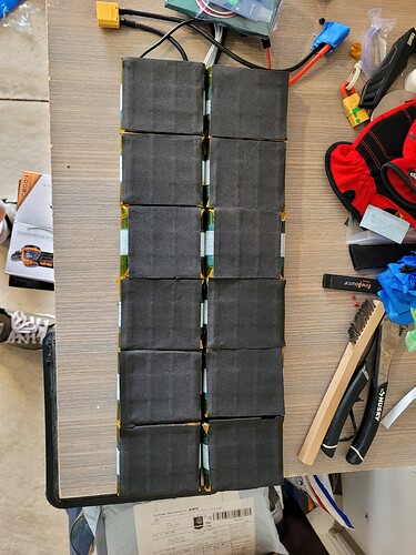

Fellas, is this an accurate way to calculate shrink wrap size? A formula that I see thrown around a lot is width x height + 10mm. This doesn’t seem to account for the total volume tho. Based on this formula, the 12s6p double stacked flat pack I’m building next would require ~200mm wrap. I just used 220mm on a 12s4p pack and it was about right.
Measure the perimeter of the thing you’re wrapping and make sure the shrink is larger than that. The perimeter of the shrink is (diameter * pi) or (flat width * 2)
Also there are different kinds of shrink wrap out there, some advertise 20% shrink rate, some 50%.
