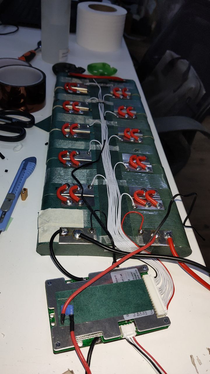

That would technically be a full metric chonk. 12s3p a123 doesn’t exactly fit… @hummieee did you just use thick gaskets?
For once in my life(po4), I actually need a 12s lifepo bms instead of lithium ion. Any good sources where I don’t have to play lifepo/li-ion shenzen roulette?

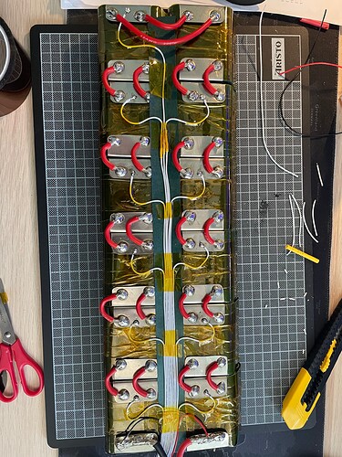

Ok, so I’m ready to close this beauty in a shrink wrap. I just need to solder the BMS (charge only) and I’m also waiting on some xt60ies for the charge port.
I’m also going to add an inline fuse on the charge positive line. What fuse should I use? I will be charging with a 4A charger.
10A is what I use usually. Pack looks nice!
Looks so much like my recent battery.
Which is to say, nicely done!
How do you guys shrink wrap flexible packs? do you just shrink each individual section and have the series wires jumping between them?
I shrink them. The method depends on the spacing. For a Prototipo style battery, each segment gets its own wrap, and then I flatten the edges inward on the faces when the shrink is still warm.
For some packs where the whole thing has to be flec tolerant in a single compartment enclosure, I’ll wrap it and then carefully slice along the segment seams to allow the flex of things to happen.
