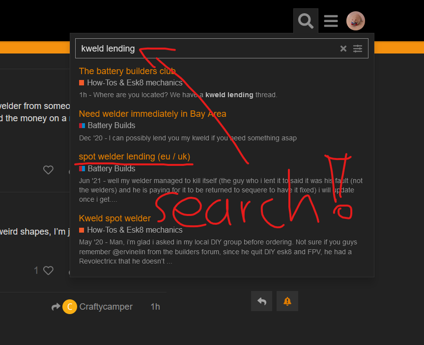

Where can i find this thread
Damn eu/uk only. Oh well

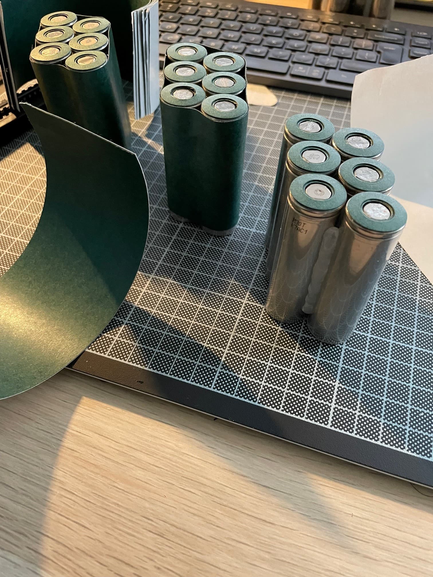

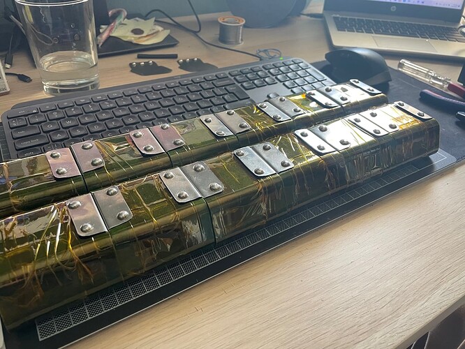

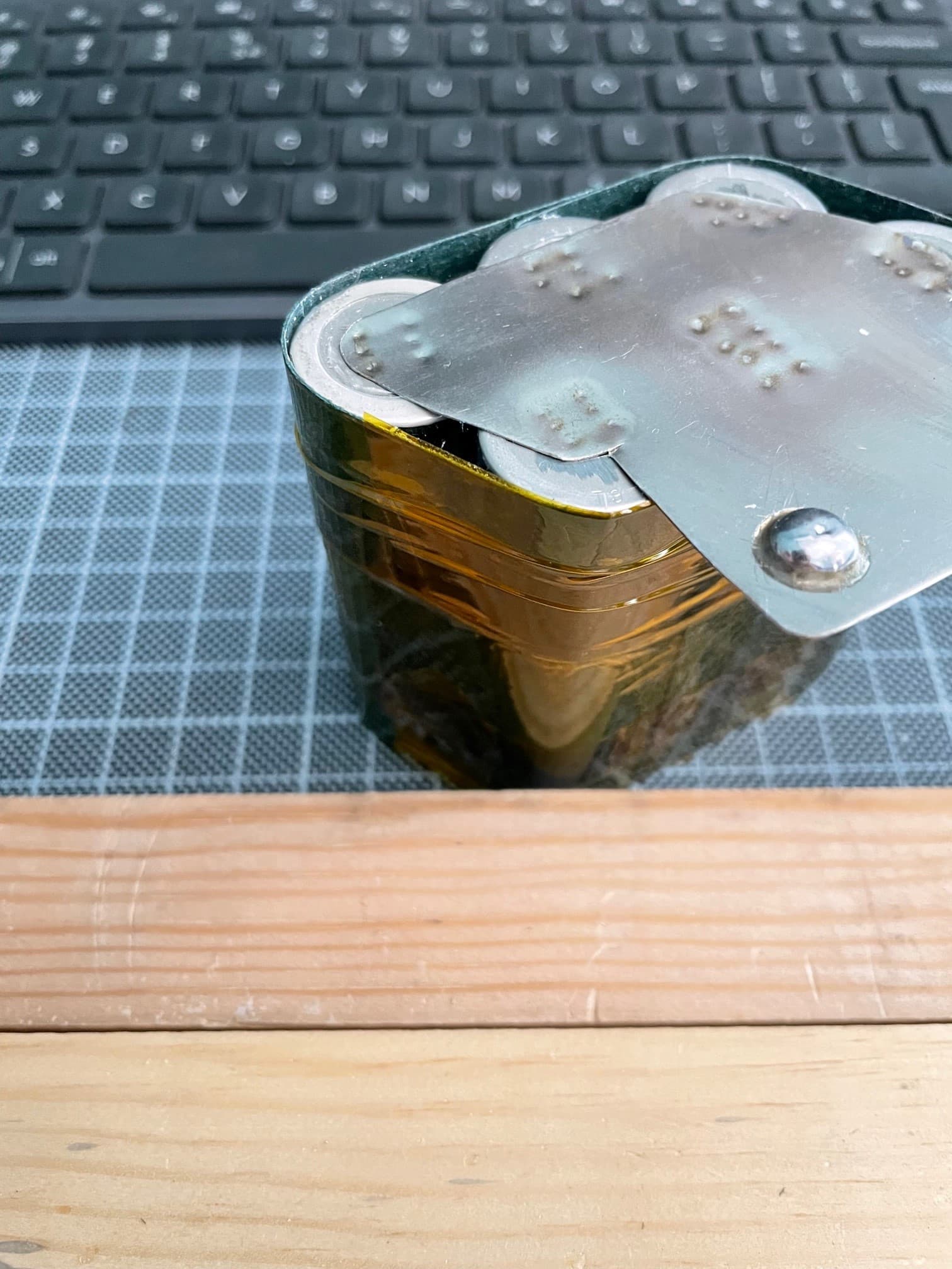

After reading a lot around here, I’m building my first battery. It’s a12s6p with reclaimed Samsung 30Ts and would like for the Gurus in here to evaluate my first try.
So far, I have glued and insulated my P packs together and have spot welded everything with 0.2 nickel tabs that I made.
I have prepared 8 gage wires for main positive and negative lines connected to an XT90s and 12 gage wires for the series connections.
So, do you see any explosion ready to happen here, or do I move forward as planned?
Looks good so far, but 8awg seems a little hectic. 10awg is generally PLENTY for esk8 purposes
Since they appear to be bare cells, I’d definitely like to see some extra insulation attention given to the positive-end shoulder, where there’s a gap between the fishpaper ring and the fishpaper wrap. It would be a Very Bad ThingTM to have one of those nickel tabs make contact with the exposed metal there, say from an accidental impact or inadvertent pack flex.
Other than that, looks really clean.
They are actually individually shrink wraped with clear plastic wrap. They came like that from Nkon.
So do I need to remake my positive and negative wires with 10awg, or stick with my 8awg overkills?
It was a real pain soldering those to the XT90s​:joy::joy::joy:
I use the dots from the middle of the fishpaper rings for this. A small strip of fishpaper would also do the job
Overkill is fine, as long as your solders are good, she’ll be right
Aha, I was fooled! That makes me feel a lot better about it. A small strip of fishpaper (or the dots from inside the rings) wouldn’t be a bad idea: Extra insulation in that area wouldn’t hurt any (it’s the closest point between positive and negative, so highest risk of an ā€œenergetic eventā€), but I wouldn’t say the current situation is actively dangerous if there’s shrink in there.
On the subject of extra insulation I’m thinking of putting some foam or plastic insulation in the middle (lengthwise) to separate the two halves.
A solid idea.
At the output-end of the battery, there will be basically the entire series voltage (up to 50.4v) between the two halves right next to each other. Yet another area where ā€œenergetic eventsā€ are more likely, and more likely to be extra-exciting.

If your willing to pay shipping then you can borrow

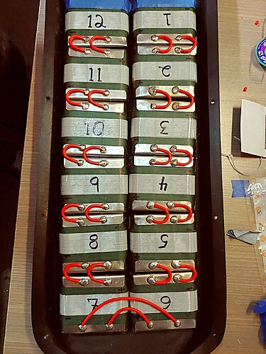

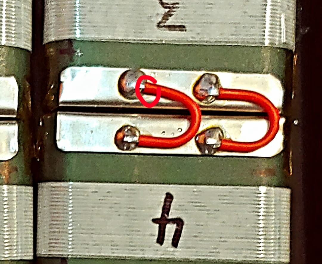

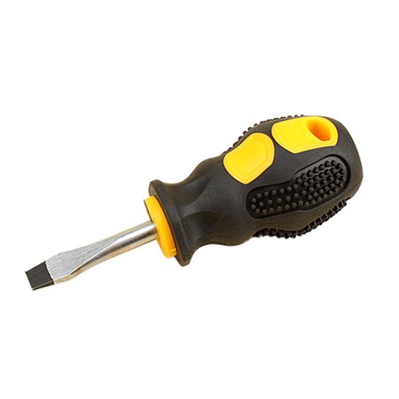

  • Having something flat w good leverage to push the wire into the solder pool.
Personally, I like to use a short-handled flat head screwdriver like this. A regular flat head is fine too but the short handle just allows for more precise movements in my experience.
6cb13357-9877-47bf-a9d8-162fff319540.30342c7c8a9e2f1adee208318f4b3d61
Pressing on the wire in a particular spot- jist past where the silicone ends is also important. Like right here:
Last and equally important as all the above, count to 3 Mississippi before you move a muscle after the iron has been (carefully) removed.
This is my 3rd battery and I got excellent joints with all this in mind
