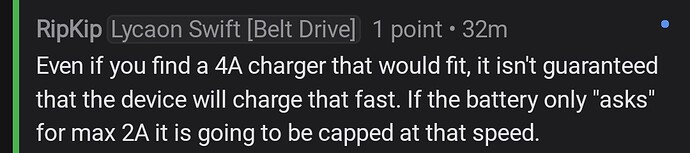

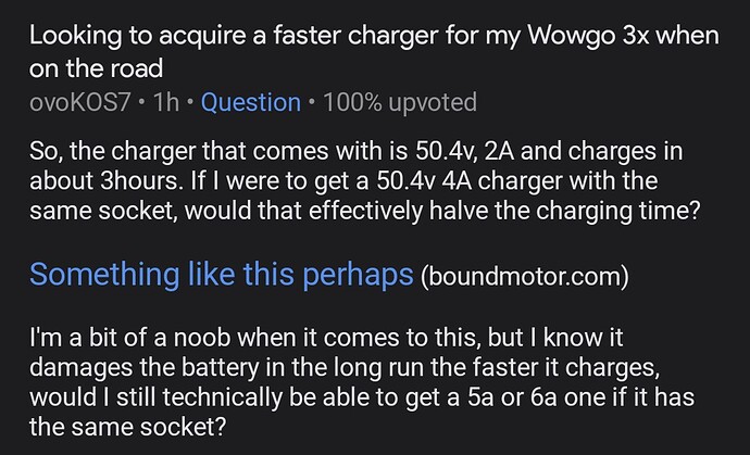

Obviously, the battery doesn’t “ask”, but the BMS can basically say fuck off if it’s set up to only allow a certain charge current right? I’ve never tried to charge at above the max charge current before, but it basically will just disconnect the charger ever 10 seconds or whatever your charge overcurrent delay is, then keep doing that over and over right?

Yea, not great the way it’s phrased.
@chr1spe is right though if the BMS is set up at that low a current level. But having the charger cycle on/off like that is not a great way to do things. :joy:
