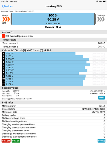

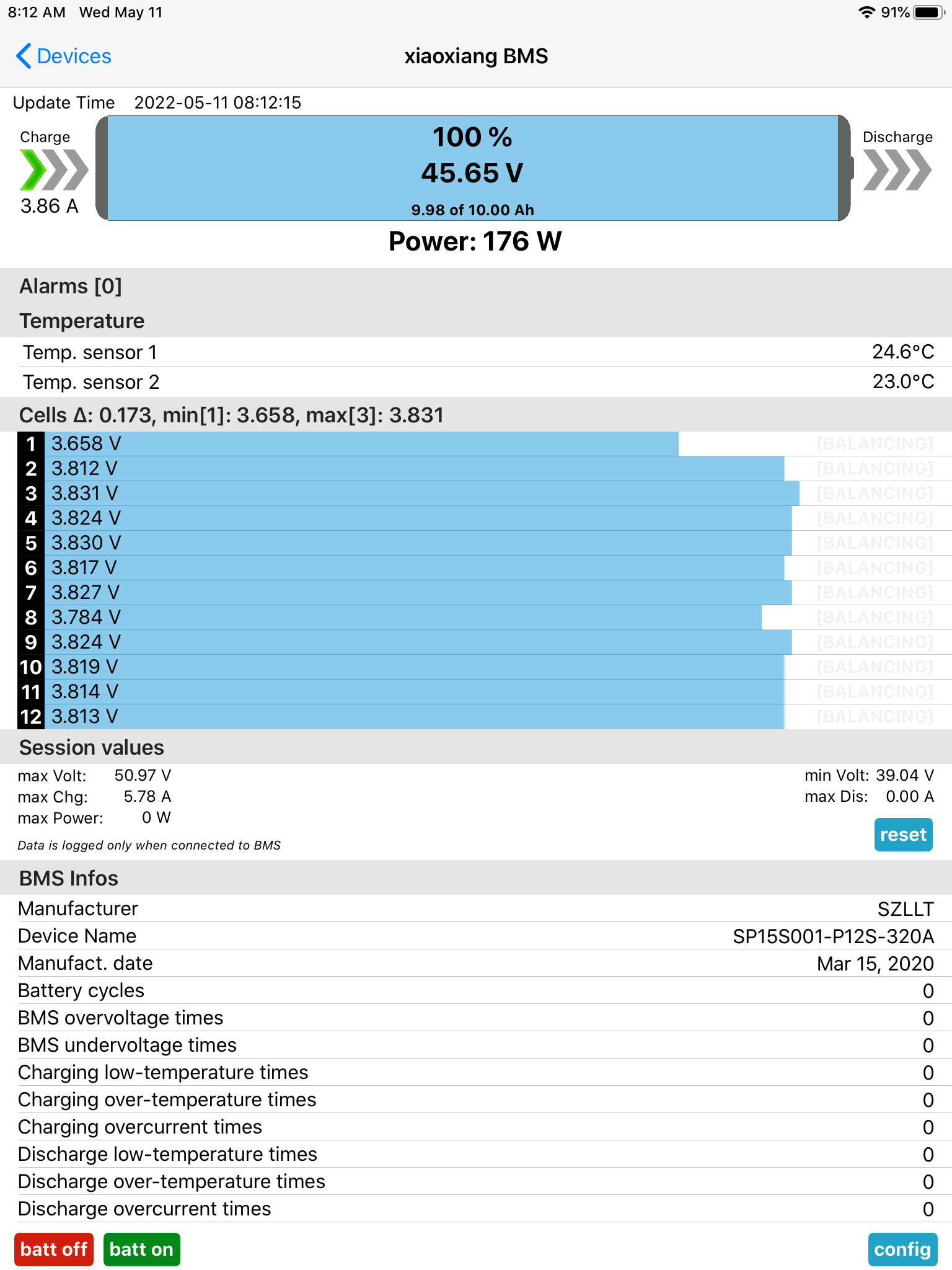

Hey guys.

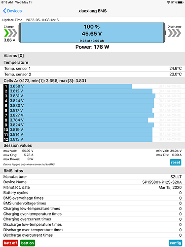

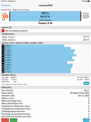

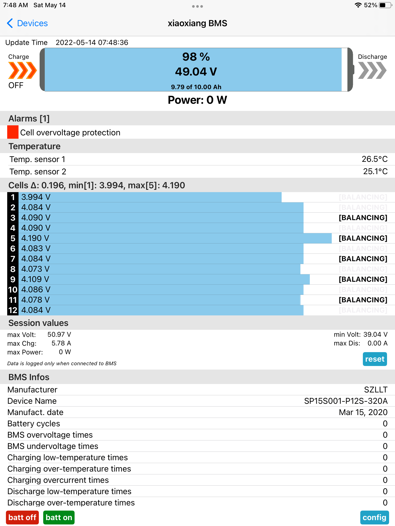

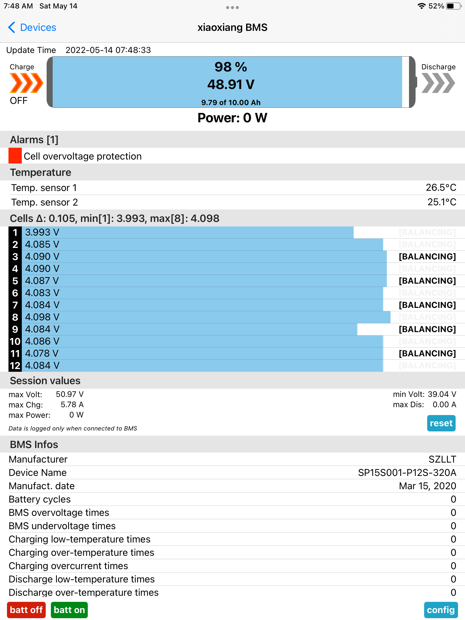

can we talk a bit about the status of the pack I built for my flux?
I am curious about it’s health.
I am more curious if I need to change any behavior.
Should I consider different ESC settings?
Should I charge differently?
Should I change any BMS settings?
This is the biggest pack I have built…
It is a 12S10P30Q
It is almost a year and a half old.
It is on my favorite board so it has seen a lot of miles.
At one point I got 31 miles out of this board.
Probably more around 27-28 now…
I have concerns about P groups 1 and 8 that usually are sitting lower than all others.
Also a couple are seem to usually sit higher.
I’m going to show a bunch of screen shots of the BMS and hope they make sense.
These are at various different stages in recent days.
Here is today.

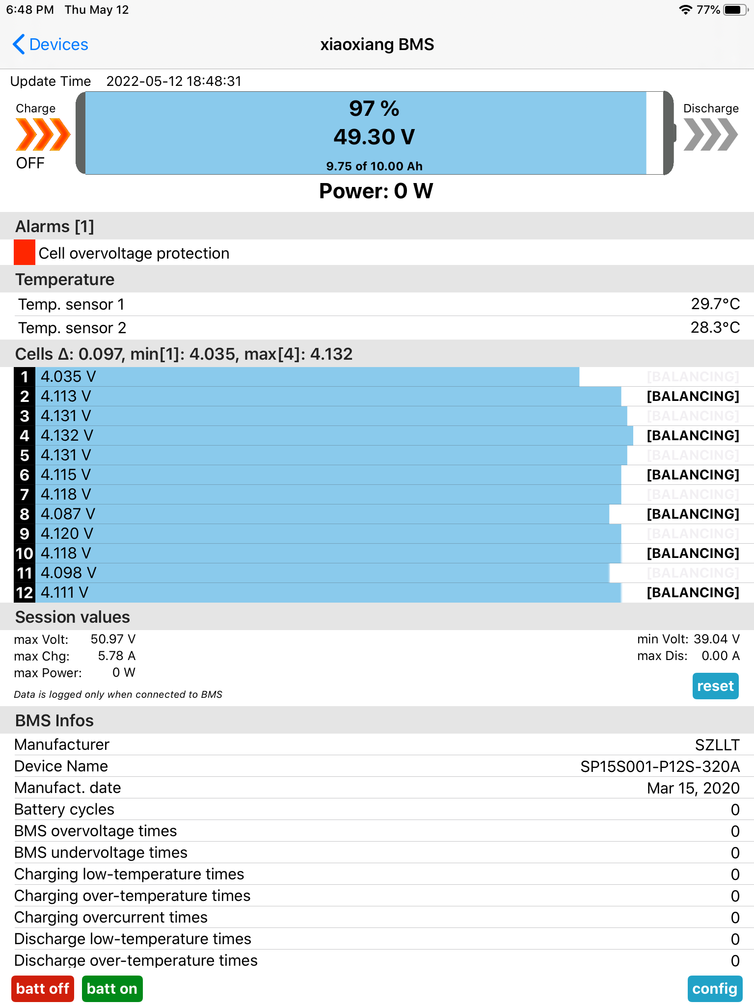

Been sitting charged a couple days. The delta jumps back and forth.
I have it set to balance when not charging.
Here is the day before yesterday.

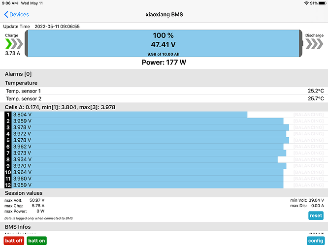

Here is what it got down to on a recent ride and then what it charged to.

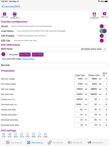

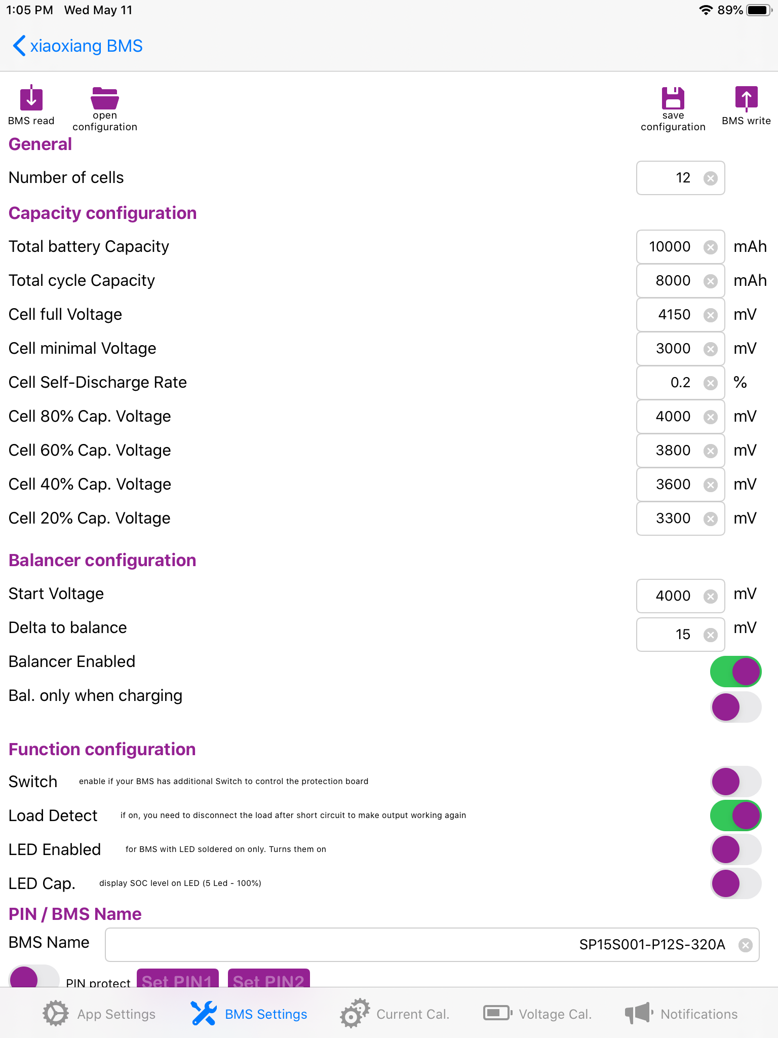

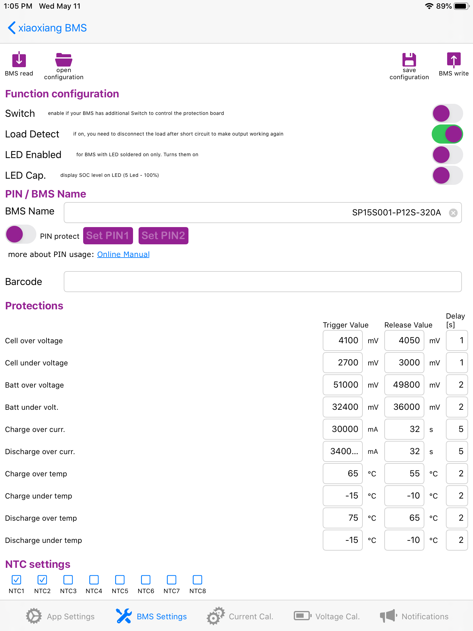

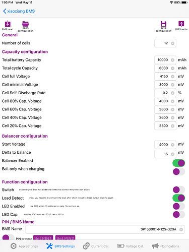

Here are my bms settings.

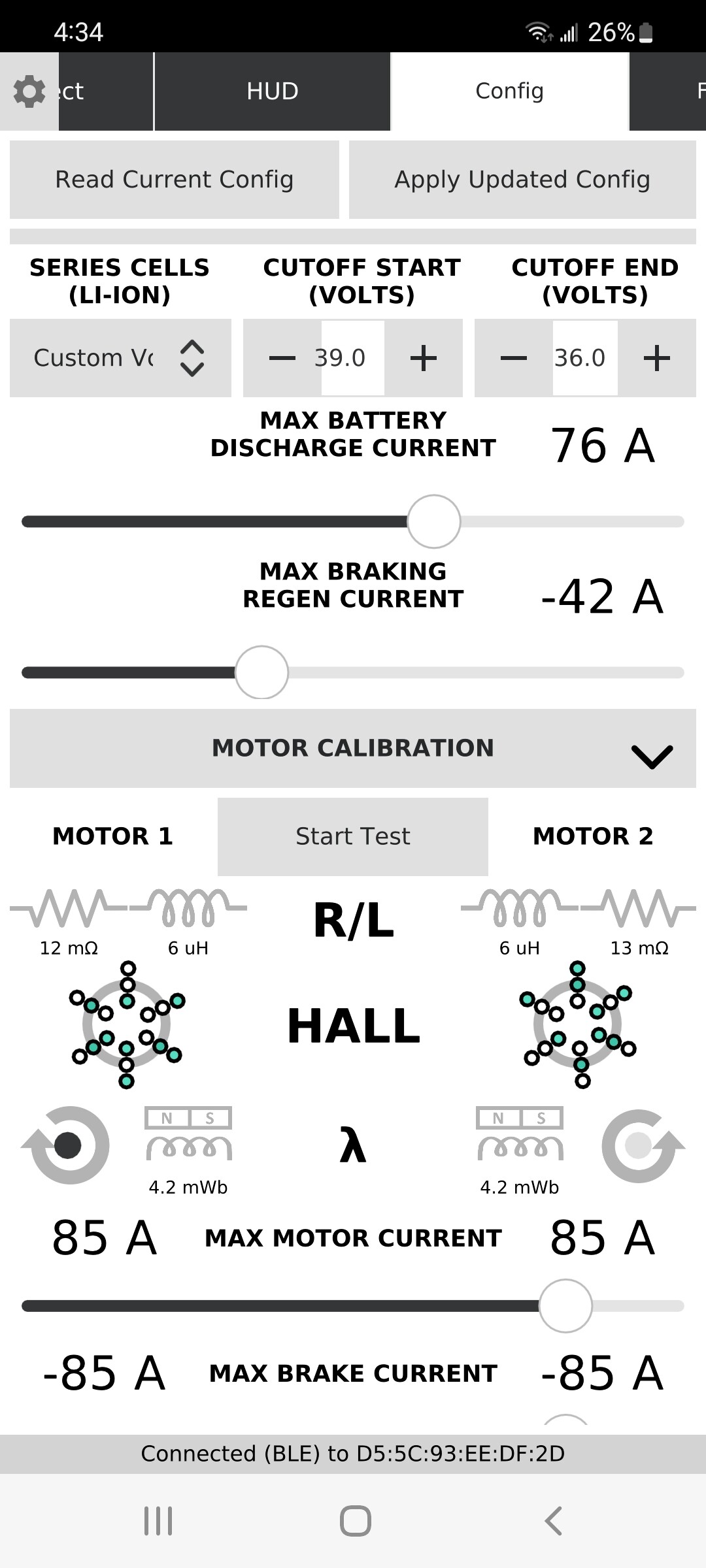

here are my ESC settings.
here is my baby…
0.2v is a massive voltage delta, group 1 is very likely to have a dead cell, its way more than 10% difference in seemingly every screenshot
Might be worth trying to manually bring group 1 up with a cc/cv bench top power supply and group 5 down with a resistor, then see if it stays balanced over a few charge cycles. If not probably a dead/dying cell.
so say a cell is dead.
does that create a dangerous situation?
or can I still use the pack and just have slightly reduced capacity?
I guess what I am truly after is if there is a lazy man’s approach to keep using this pack?
the thought of really opening it up physically super bums me out.
It could.
Assuming a cell is actually dead, you’re pumping energy into and demanding energy from a chemically damaged cell. This will stress it more, and since the condition of the cell can’t be known, it’s hard to say what will happen.
Or it could be that more than 1 of the 10 cells are underperforming.
Or that welds are broken.
Hard to say unless you physically go looking.
You can of course continue to use the board normally, and just roll your dice.
The real likelihood of it ending catastrophically is unknown, but I generally tend to doubt it’s a high risk. I say that because of the continuous stream of scary trash batteries I see that keep on running somehow.
As for a lazy approach…I’m not personally the type to approach a battery of 120 cells in a lazy way. There are of course ranges of tolerance between convenience and risk, and you’re the only one who can make those choices.
“I don’t want to” is usually a decent enough reason for most folks to just leave things as is until they fail. However that may be.
The 12s4p 30Q pack in my Sportster still runs…and to be perfectly frank, I have no idea what the cell groups look like. It’s 2 years old, I get 9 miles, and it’s probably a functional pile of trash. Who’s to say?

I would vote for this option, even though I understand it’s not ideal. However, it’s worth pointing out that groups 1 and 8 are not the only groups getting out of balance, they are just the worst ones. If I were you, I would open up the pack and check the welds on every single cell, as tedious as that sounds. If all the welds are solid then it’s your cells which are bad.
