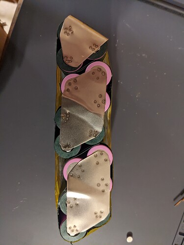

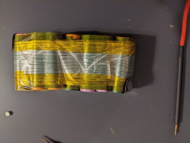

Comments, suggestions, and beratement welcome. This is my progress on my first pack and it isn’t coming how I’d envisioned. The groups wanted to shift around while I was taping them together and it bent the nickel some. I guess I didn’t align then well enough while welding. I should have 3d printed a jig or something. I almost just went to start over from scratch, but I think I’ll just try to finish it the best I can and do better next time.
photo spam
Should I take the lack of comments as “That’s so bad I don’t even want to speak of it” or “Meh, there isn’t really much to be said about that”?
It’s a bit soon to think no one is commenting.
You posted around midnight EST here in the US and some folks don’t check posts every day. Wait another day or so. Especially since no one has posted here after you.
Your post does wrap things up pretty well too…you know the pack isn’t great, you’re going to use it anyway, and you’ll do better next time. Not much commenting can be done after that. :slightly_smiling_face:
Asking for general feedback is also asking for everyone to take a bunch of time…which no one seems to have these days. It can help to ask a single specific question, perhaps about how to best stabilize cells before welding? Or something related to that to help keep things from shifting around as the pack is assembled. I think more people would respond since the answer can be short.
Glue the cells together before welding, in a jig for example. Use hot snot or neutral cure silicone. If you don’t want glue, use cell separators (cheap on ebay or print them yourself). Then wrap the p-groups. If the pack goes into a high vibratory environment, f.e. a longboard, make sure to avoid balance wires crossing, and where unavoidable, put fishpaper in between. Also weld on little piece of nickel as tabs for the balance wires, that way they don’t have to go around corners.
Also make a perfect nickel piece to use as a template for more even nickel plates without crinkles.
And yeah, your pack looks like shit, but should be functionality-wise totally fine. :smiley:
I did glue the P-groups together and then wrap them. The problem was more the separate P-groups sliding around once I had welded the series connections and went to tape the entire sides together. They all wanted to slide against each other in opposite directions. Also, I did plan poorly on the balance wires, but I have tabs cut, bent, and tinned to weld on top of the nickel that is there. I just haven’t done that quite yet. My welder seems to be mostly okay-ish, but the leads and electrodes are cheap and small so I have to take a lot of breaks.
As far as specific questions like mooch mentioned, I guess I’m just wondering how unsafe is this going to be if I do a reasonable job finishing it? Also is there anything short of starting over from scratch that I can do to improve it at this point?
