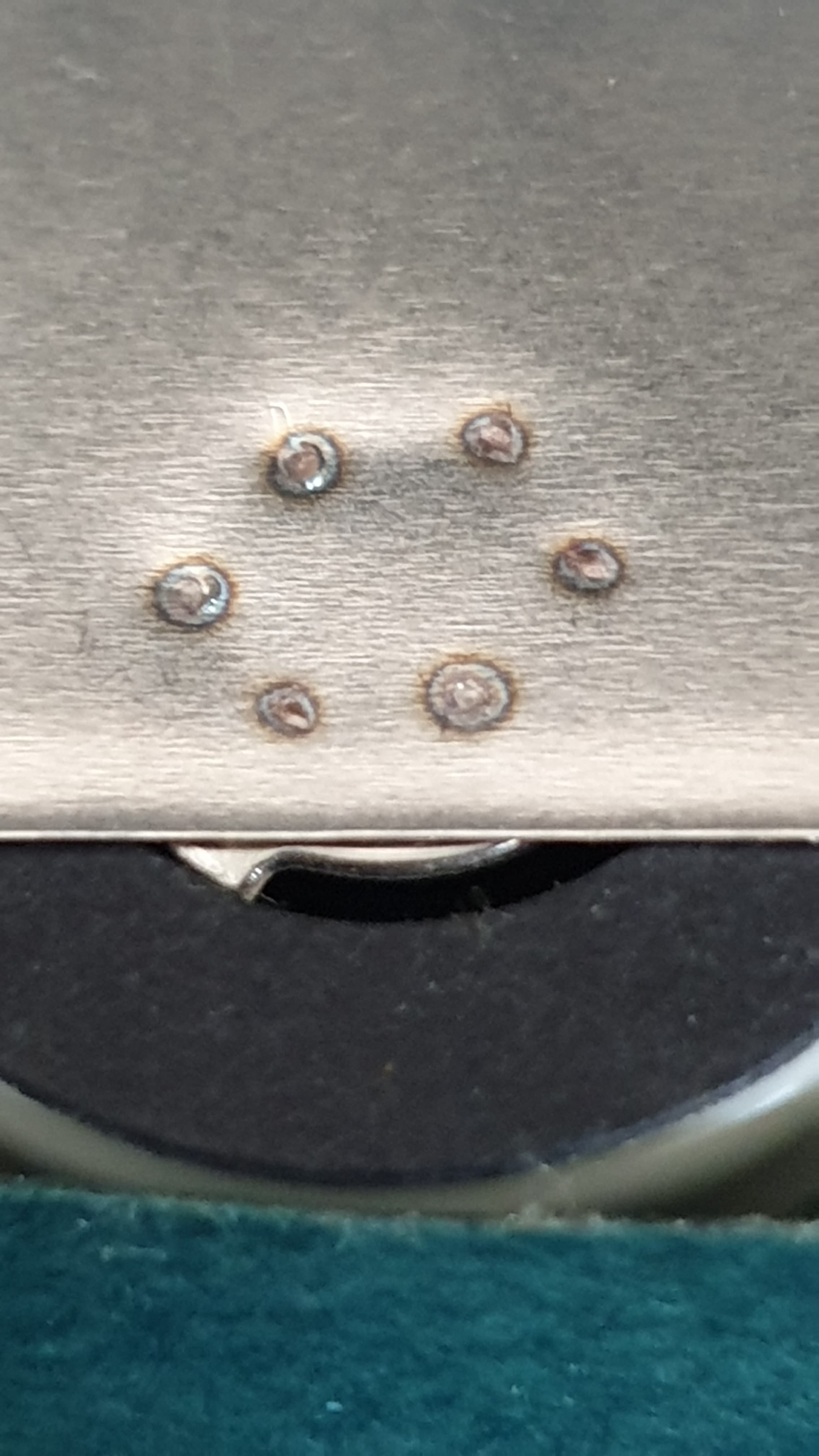

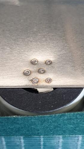

Hi, just starting to weld my first pack. Using sequre sw1 with 0.2mm nickel.
Do either of the below look OK?
30ms
25ms
On test battery they both leave a tiny bit on the battery when torn off
Both look okay, 30ms maybe slightly too hot on that bottom weld. I think somewhere in the middle of the two would probably be perfect, do 27ms if you can :slight_smile:
Thanks @rusins will give that a go
