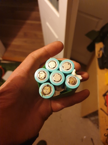

Why are some of the parallel groups 4p and some 5p? Or am i looking at it wrong
I’d say they are all 9p

I’m guessing those are all double stacked?
your right, didn’t see that

Yes those are 9p staggered with 5 cells on the bottom and 4 on top then it’s the same thing by flipped next to it
How many joules you running?
33.3 on 1.5mm nickel
Maybe 30? I found that the negative ends need a bit more power…so I’d do 30J for positive and 35J for negative maybe? It’s all close enough that it doesn’t really matter
totally dude, I noticed this as well. I’ve started changing the J just slightly between neg and pos sides. I’m getting better–this whole art really is just practice. I’m glad I have these salvaged cells and thin nickel to practice with. Perhaps I’ll give away this 13s practice battery when I’m done…
IF IT BLOWS UP HEY IT WAS FREE
Turn up the current untill you see heat marks, then dial it a bit back more heat is better then less when welding
