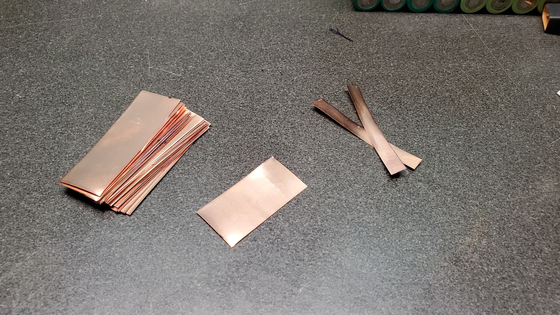

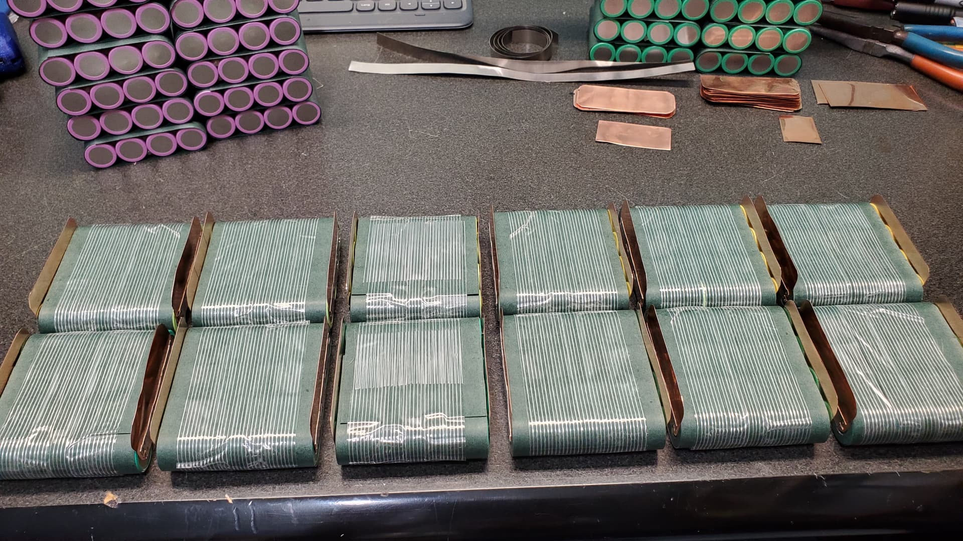

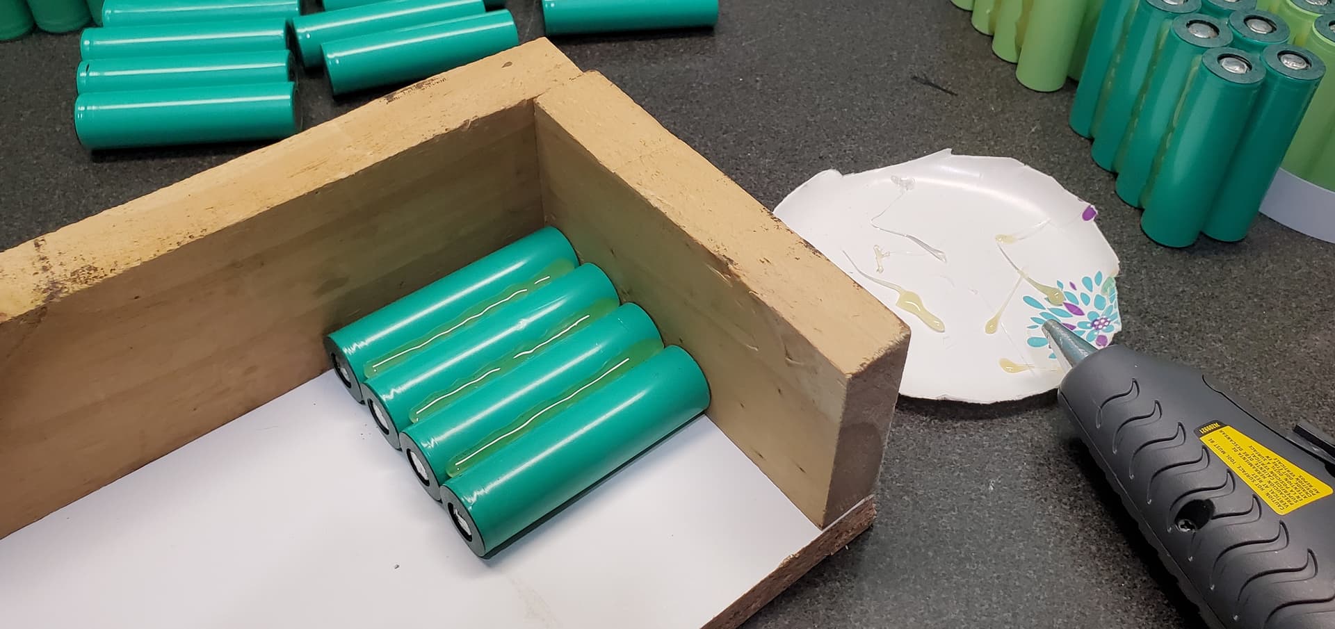

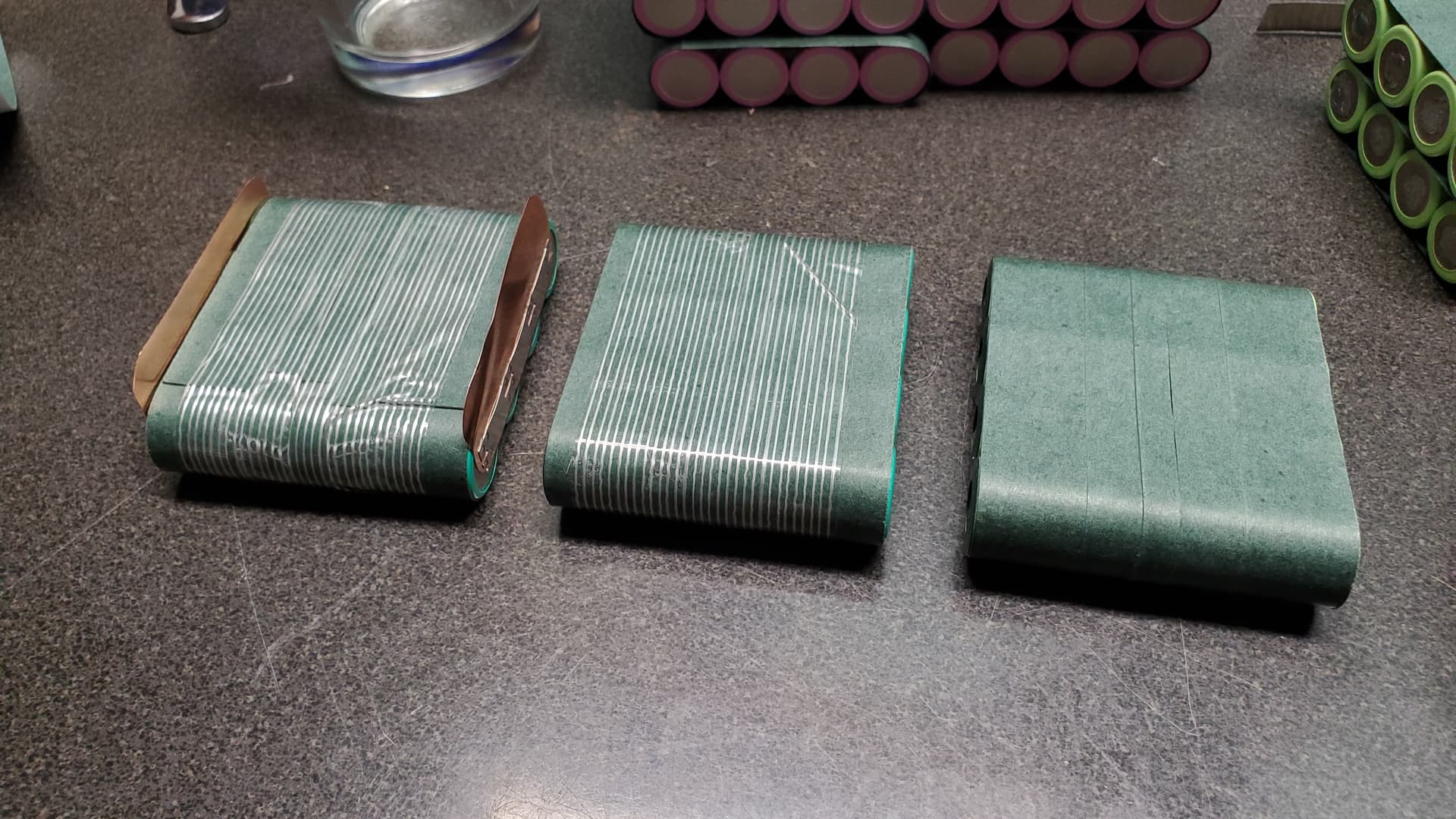

I’m in the process of tearing down my 5 year old soldered 12s4p 25r pack and rebuilding it based on all the new techniques I’ve seen here and on endless sphere.
Cells were stripped, cleaned of any surface rust and rewrapped in two different colors
Fish paper rings under the re-wrap and a second one stuck on top.

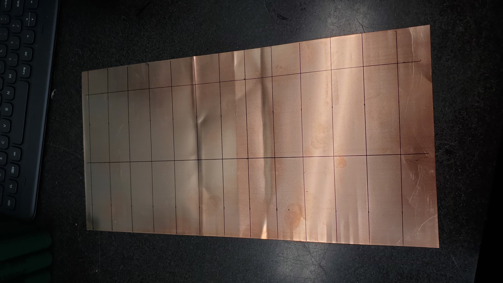

34 gauge (0.15mm) copper sheet
Using up fish paper scraps & wrapped with fiberglass reinforced packaging tape

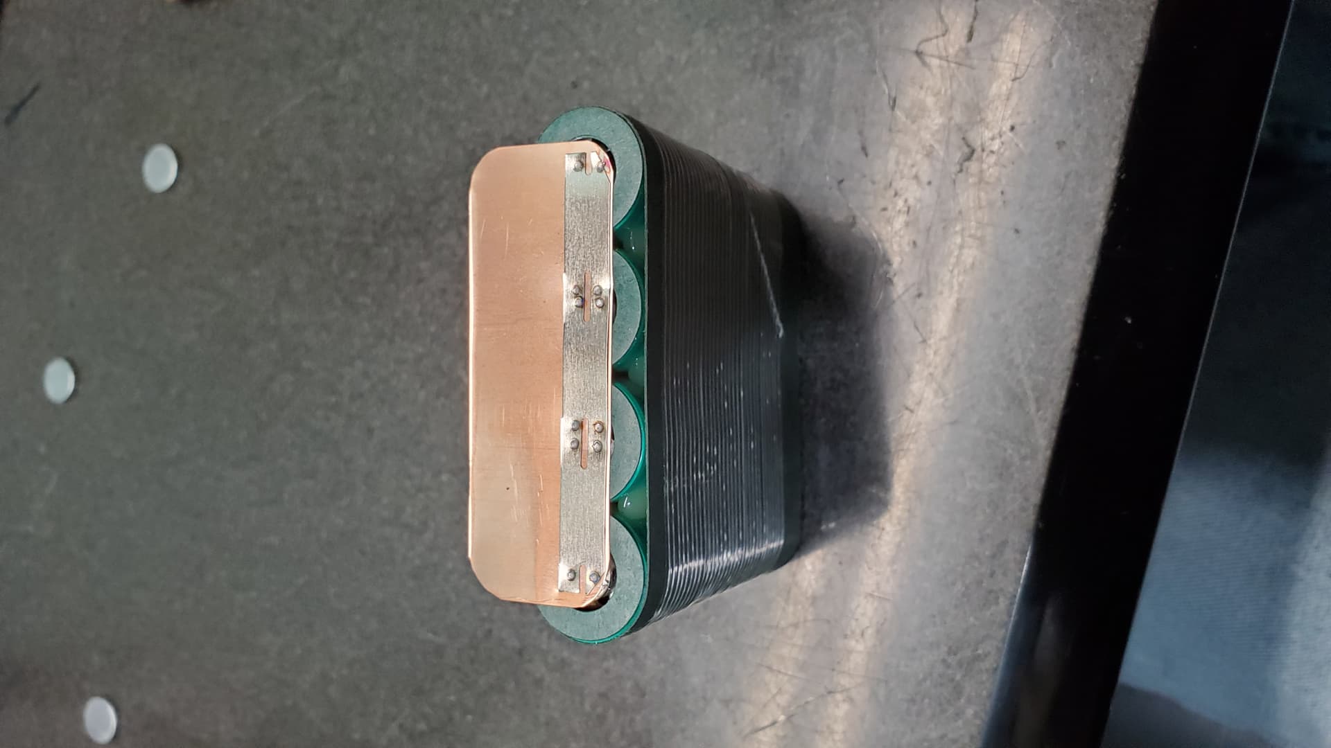

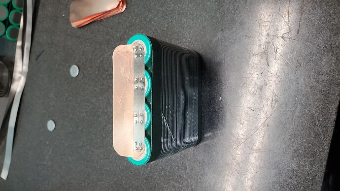

0.15mm nickel plated steel on top of 0.15mm copper. KWeld 100j @ 1650A. I tried using pure nickel strips on top of the copper, but couldn’t get a good bond on the test cells.
Negative side

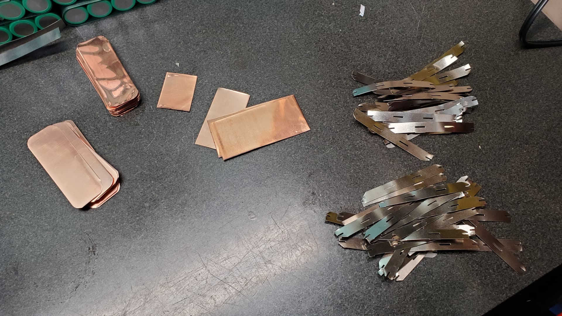

Rounded corners, and cut nickel strips to size & rounded
Eventual pack layout
Copper folded

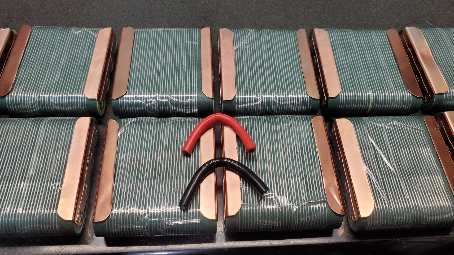

Next step will be to solder 2x10awg silicone wires for each of the series connections directly onto the copper sheet.
Mate, that is a lot of fucking work for batteries that are five years old, and previously soldered. I don’t want to tell you it’s not worth it, but you should very seriously consider getting new cells at this point.
Likely capacity damage from heat during initial soldering + however many cycles you put on it in five years probably has those already puny batteries near the end of their life.
Agreed - this pack will end up being a spare or range extender. I wanted to do a trial build before I tackled these two packs with new cells
