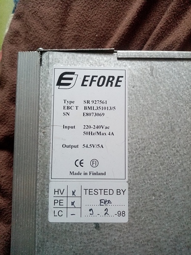

Hi guys. I have a 12s 4p battery. Îs ok to charge with this Power suplay.
my charger îs not arrived. IT takes a little longer . And i want to charge de board.Generally no. At minimum you need a supply the limits current (The CC part of CC/CV). Otherwise the battery will request like infinite amps (determined by the resistance of the wires and the IR of the pack), and the psu will try to supply it, hopefully tripping overload protection or a circuit breaker and not catching fire
EDIT I found out “limit current” can mean a protection circuit that shuts the PSU down when the current limit is hit. So there’s some semantics to deal with. If you see Constant Current it does what you want.
Dont forget your battery is 50.4v at full charge. Your charger can overcharge your pack
