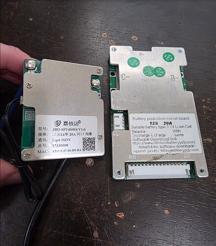

Hey guys,
Has anyone here used these small JBD Smart BMS units in their battery builds? I found them on AliExpress for under $10 each, which seems kind of wild.
From what I can tell, these are:
  • JBD / Jiabaida Smart BMS
  • 12S, 20A
  • For 3.7V Li-ion
  • Common port (charge & discharge same)
  • With balance leads (up to B15 visible)
  • UART / Bluetooth capable (label shows UART + MAC address, so smart features should be there)
I really like the idea of a compact smart BMS for a 12s2p pack I’m putting together. Size-wise they’re way smaller than the usual JBD bricks, which makes layout a lot cleaner.
Before I commit:
  • Any long-term reliability feedback?
  • Balance current any good, or super slow?
  • Any gotchas with these smaller JBD boards (heat, current limits, app quirks)?
Curious if anyone’s actually run one in an esk8 setup rather than just bench testing. Appreciate any real-world input. :heart:

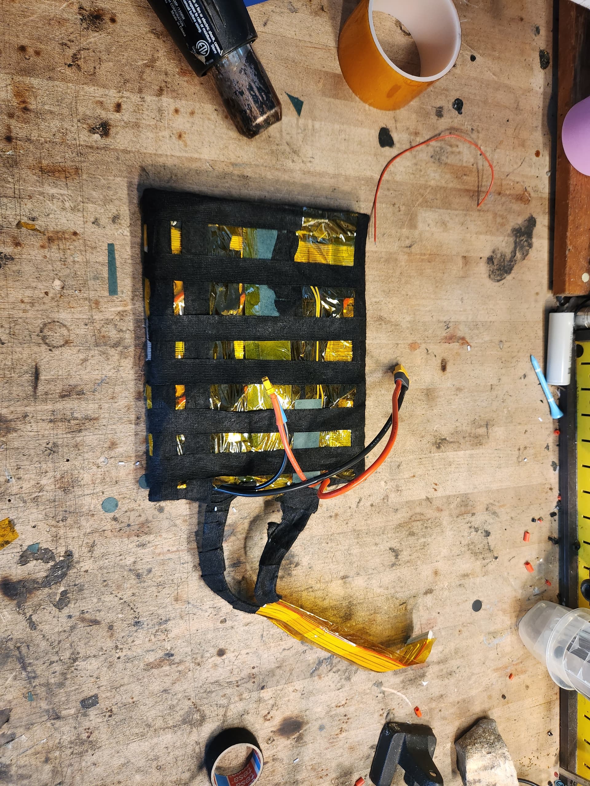

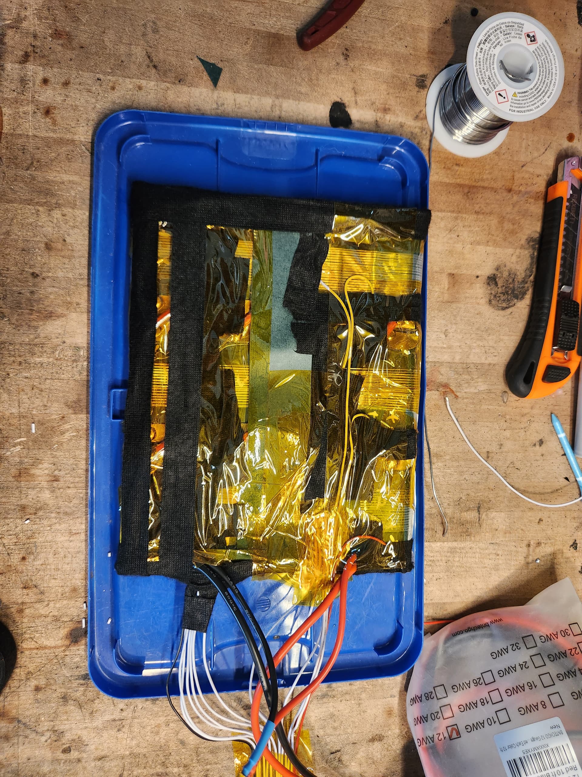

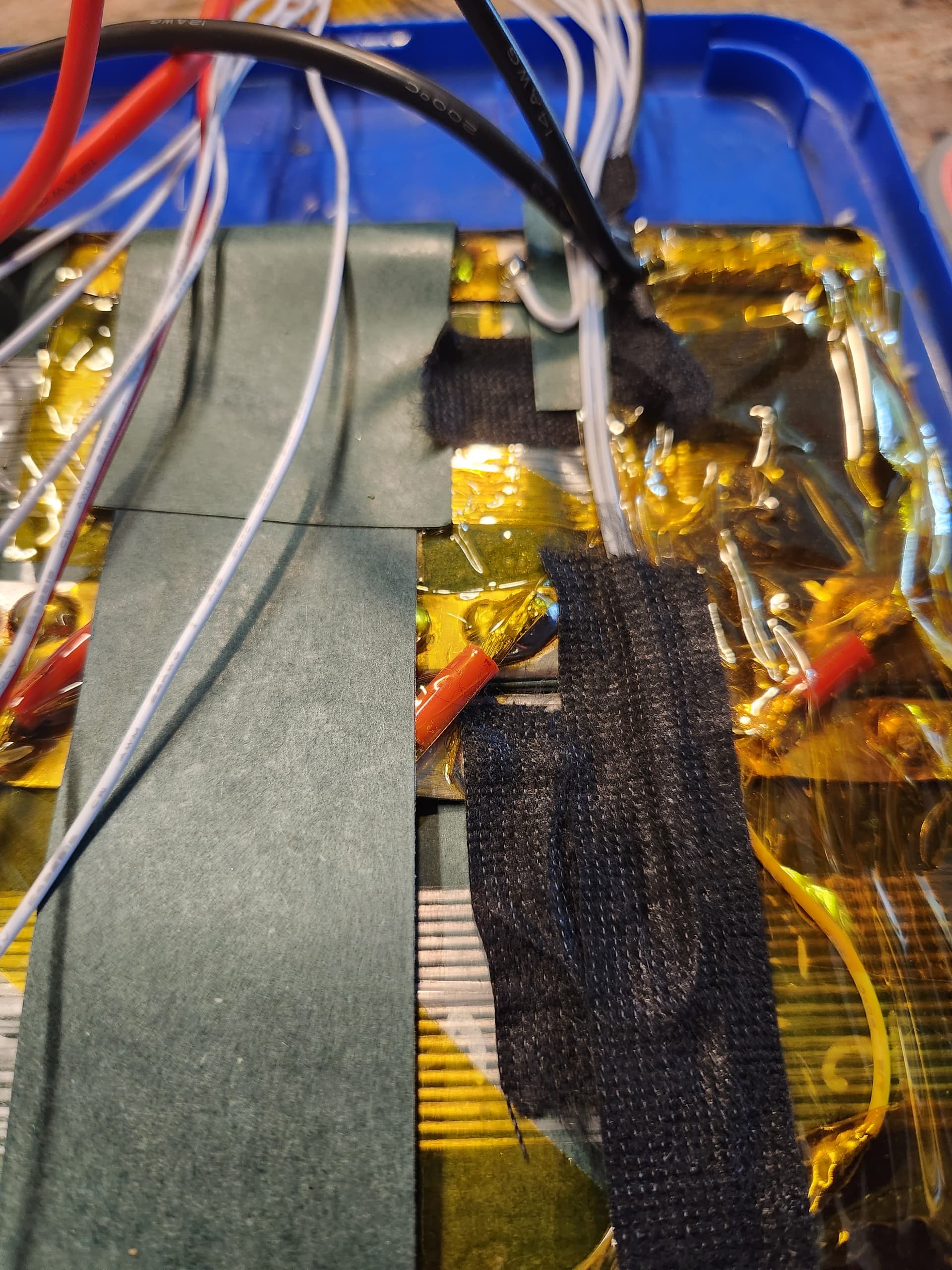

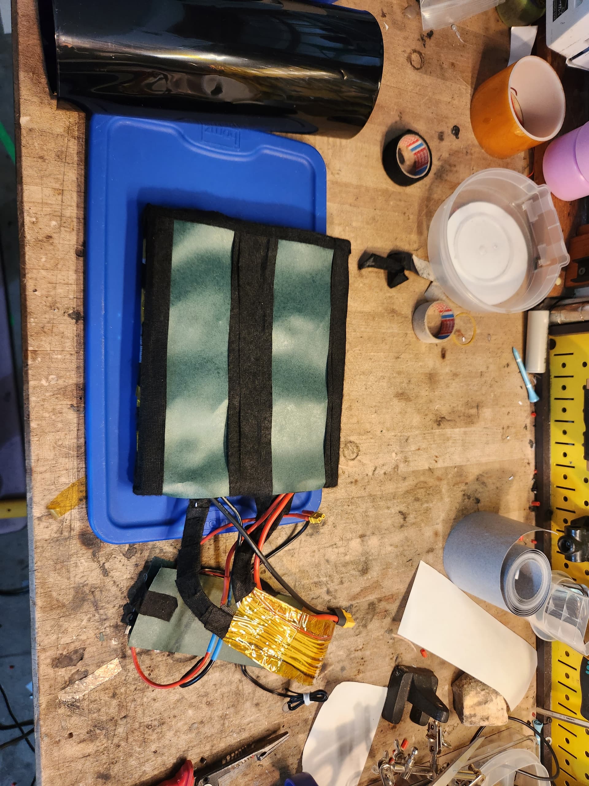

I’m not very good example. But here it is nonetheless @fearlesstvn
Thanks, Rafael! :slight_smile:
I couldn’t find any photos that clearly showed the BMS — was it one of the smaller JBD-style boards? Also, do you happen to remember which cells you used?
I’m also stoked to see you running a single 12-gauge lead between groups. I’m planning on a single 10-gauge, but all of my previous builds have used dual leads, so I’ve been a little cautious about it.
These have been pretty much the standard for the last couple of years for 14s and lower..
@Tony_Stark has employed these in all of the 2024 mach ones, I don’t know if there’s any real gotchas, I haven’t paid close enough attention to mine to notice any significant idle drain..
I think @Pecos warned against using them at their upper charge limits due to heat, if you plan on much more than 10a charge it might be better to get a higher specced one. I think they come in 20, 30 or 50a
This is exactly what I was hoping to hear, thank you!!! :grin:
Good to know about the charge limit, though. I will plan on keeping to my dinky 5a charger for this one.
Take a look here.
I have not used these bms myself. I have 2 of them here for future packs…
edit, I think balance current is around 50ma.
I have 10 of the SP14, and a couple of the SP17 models
They seem to have a fairly low standby current, and seem to evenly drain from all cells as opposed to just the first few.
I do disconnect the BMS if the pack is going to be unused for more than a month or so.
Last year I experimented with ldle drain current, I don’t have exact numbers, but it took roughly 6 months to drain a 13s ~300wh battery from 3.8 volts per cell to 3.0vpc.
Note that an active BT connection will pull more current, you can tell if BT is active when the blue LED is flashing on the BMS.
You can use the OverkillSolar app to get access to all the settings on the BMS.
JBD’s app after about version 3.1 is neutered to only allow access to the most basic settings.
JBD’s communication protocol is very well known and documented online.
I have a project that implements an ESP32 as a bluetooth esp-now bridge to get battery telemetry into any VESC based controller with a VESC-express.
This is exactly the kind of info I was hoping for, thank you!! :smiley: Stoked to hear this model is so commonly used, think I am going to have to pick up a few more.
As for the idle numbers, that does sound reassuring. I can’t imagine a board of ours going more than a month without use.
Shame to hear about the JBD app, especially because mine is past 3.1…. but damn you go all out on the battery details, huh!! I have a ton to catch up on, but did you get the bridge working?!?! That is some next level stuff, for sure!
