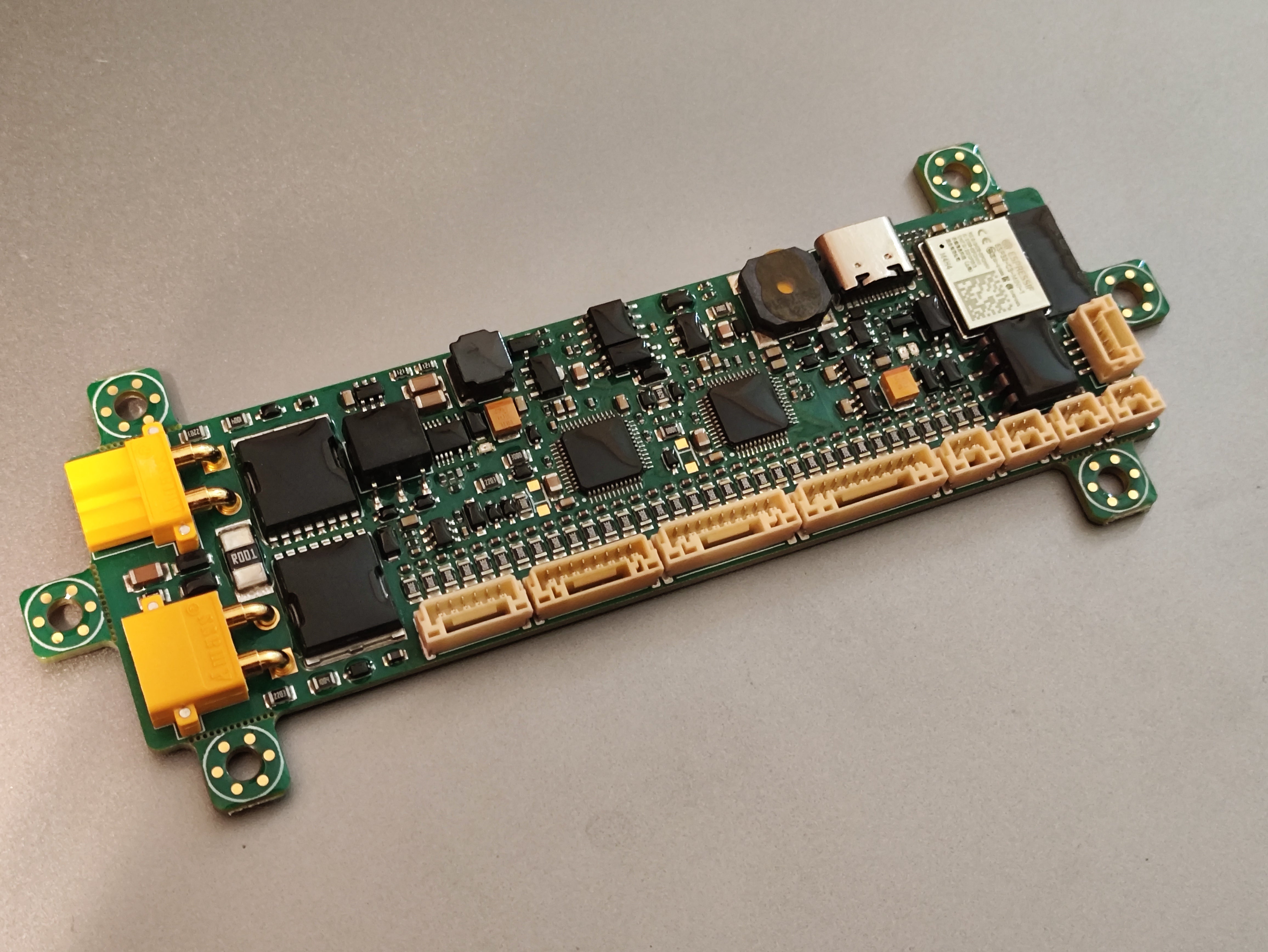

Anyone use this BMS?
No, but I’m curious about these other form factor bms especially any that have higher balance currents.
What makes this desirable to you?
Charger spends less time at the very top of charge balancing the cells? Idk
I could have the wrong idea, but for larger P count packs where I’d prefer to charge at 10A-15A it seems like this would help keep the pack better balanced if I’m not leaving the pack plugged in overnight.

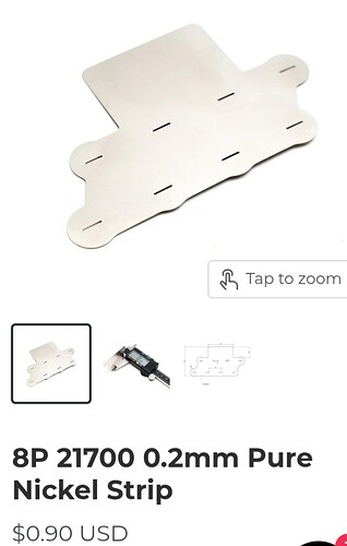

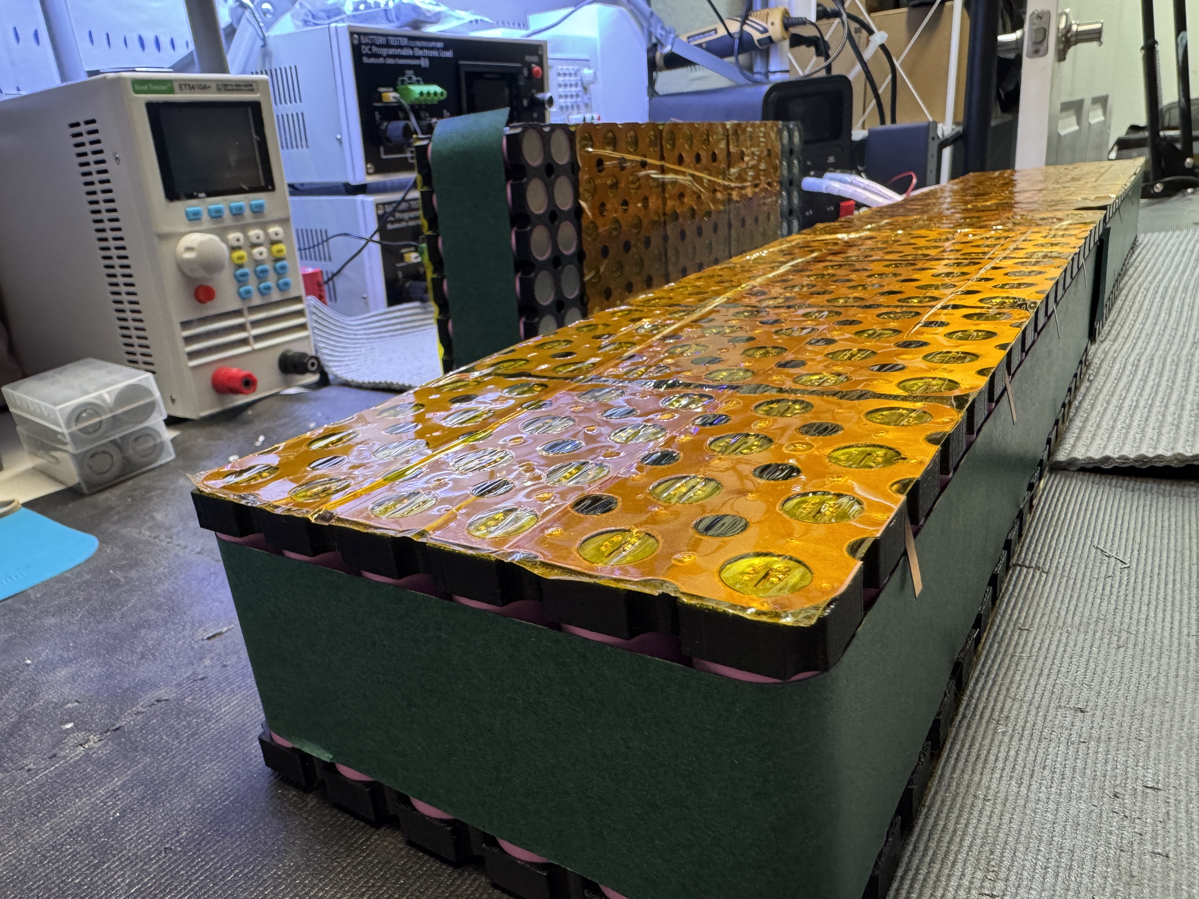

So, I’m in the designing stages of building a 12s8p Bak 45D pack. While the cells should be able to handle something insane like 480 amps, the current plans for the build only require about 200 amps. I’m not sure how much I should overbuild it in case I decide to try to pull more power, though. I thought about going the precut nickel route, but something like 8P 21700 0.2mm Pure Nickel Strip — MBoards is only good for about 120 amps, from my estimation. Does that seem right? It only has about a 40 mm width for the series connections.
Are there any places with precut nickel with more area for series connections? I figure since I’m doing 8p double stacked, if I do the full ~80mm width of the groups for series connections that should handle ~240 amps, and if I did it top and bottom, it should handle about 480 amps, at least as far as 0.2 mm nickel. I guess I just need to decide if I want to have series connections on one side of the battery and be limited to ~240 amps, or go wild and do series connections on both sides and be able to fully use the cells if I somehow end up with the ESC and motors for it.
I guess I just wanted to check and see what people here think and sanity check myself.

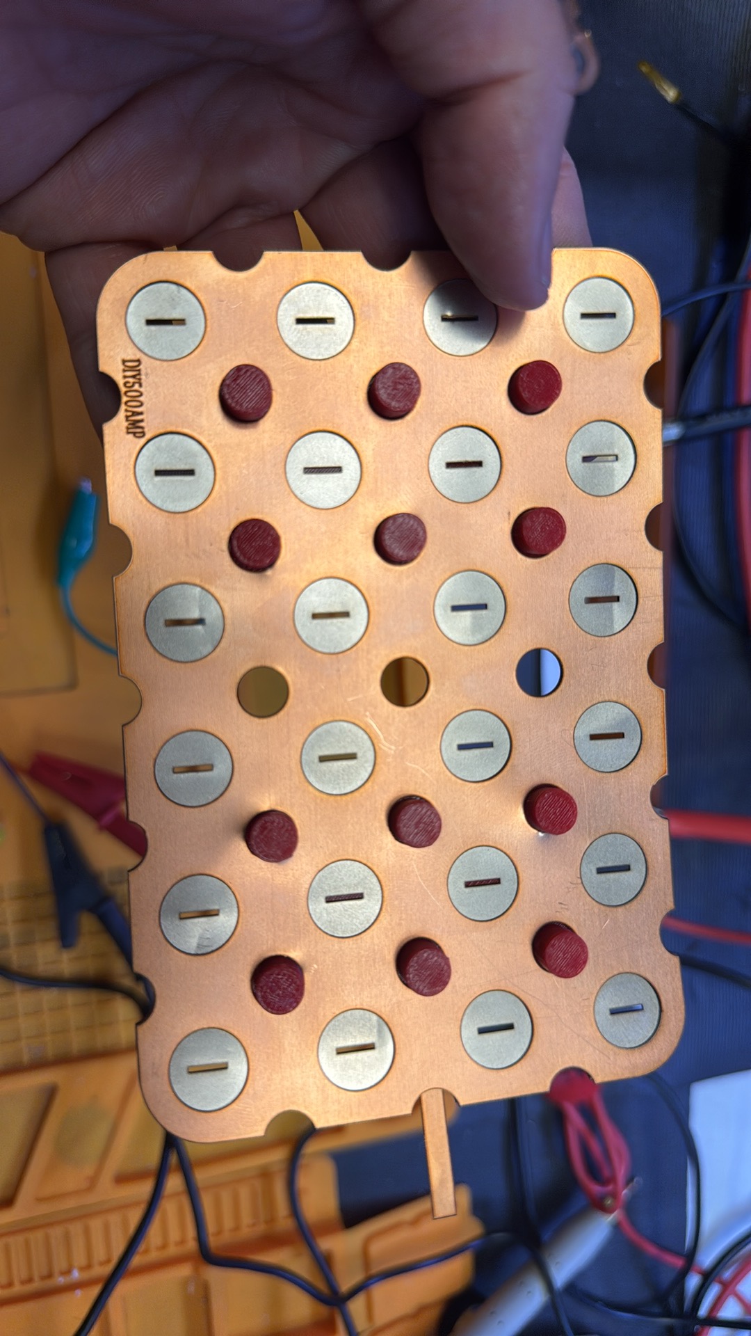

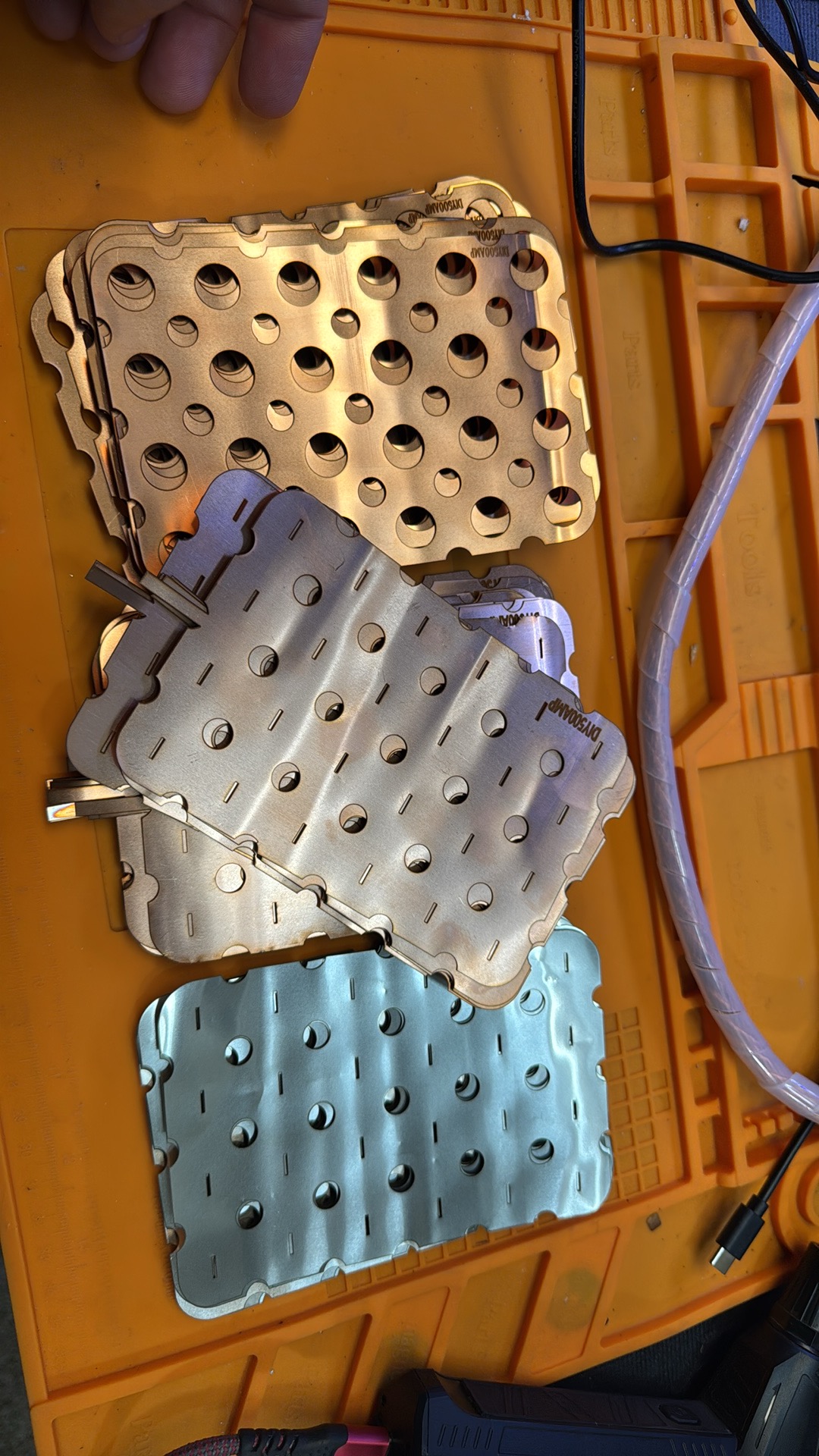

You can reach out to Nelvick @DIY500AMP.COM
He has a laser cutter, for nickel or copper or stainless steel.
I really need to see the layout and cross connections. For high amp I recommend using copper/nickel or copper/stainless steel sandwich!! Examples
I and few others use it for more than a month. It works great.
This depends on BMS some BMS keep balancing also when charger is disconnected until they reach their setpoint. You do not need high balancing currents for fast charging.
He was wanting a near full width tab, not the ~40mm wide one shown
Yeah, I’m still not fully decided, but I want at least one full-width tab. I’m considering doing full-width tabs on both sides because, at that point, if I build the rest of the battery out enough, it should be capable of fully utilizing the cells or close to it, even though, for now, my plan requires less than half that.
I’m more of a minimizing resistance mindset, rather than what can I get away with.

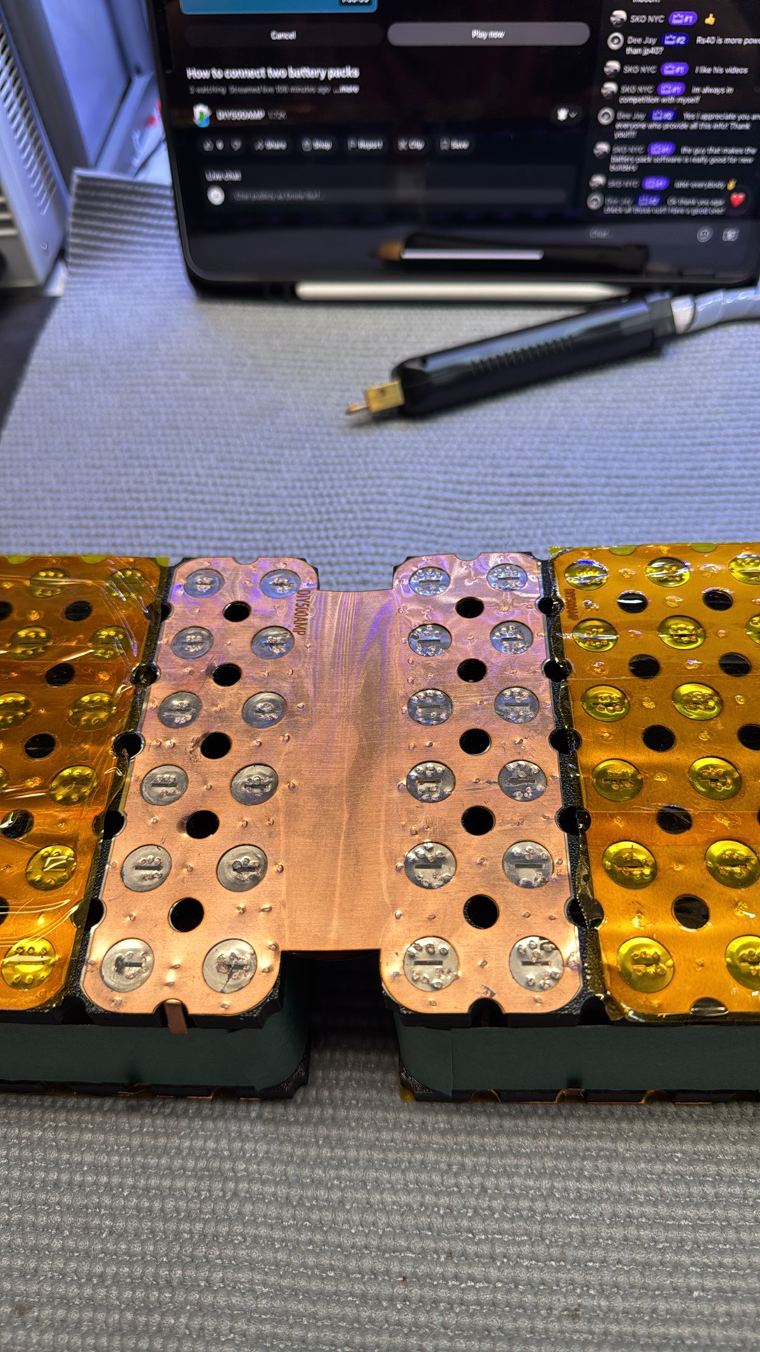

I recently found I can weld 0.35mm copper under 0.1mm stainless steel with my AwithZ P20b14.6kW welder at near max power, using brazing paste/welding flux, and will struggle to use anything less than 0.25mm forever after.
My 10s2p BAK45D currently in my enclosure is 0.1mm copper, 0.1mm nickel plated steel sandwich with dual 14awg series connections and 10awg to an XT90s, and my ESC is just a lingyi capable of 24 battery amps. So I like overkill, But can also easily feel voltage sag as I’m almost always accelerating at full throttle, and my old battery was difficult to keep under 60C when it was retired, and had nearly 6 volts of sag at full throttle. The BAK is about 0.8v of sag and has at least 20% more torque.
That BAK pack was done with a 21$ purple spot welder with a 36$ zee 3s 5.2 ah weld battery at about 85% max power.
The BAK Battery stays cool, but I wish I could have used 0.2mm copper. I want my parallel and series connections to be a heatsink, not another heat source.
The 45D is an impressive cell. I say find the maximum thickness of copper your welder can weld under 0.1mm stainless steel, even if you never approach the cell’s maximum temp limited rated current.
