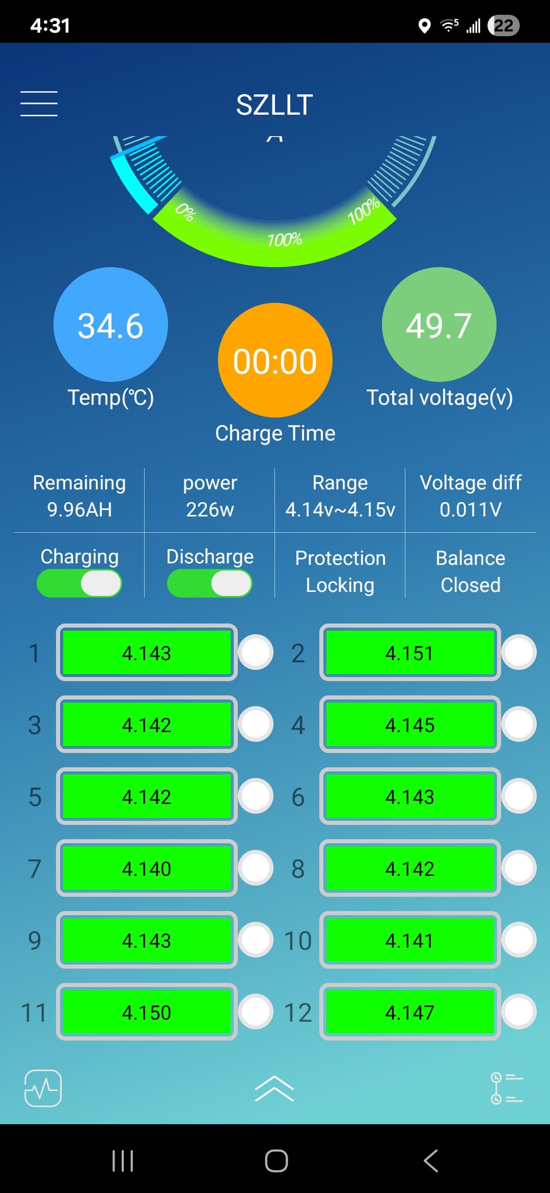

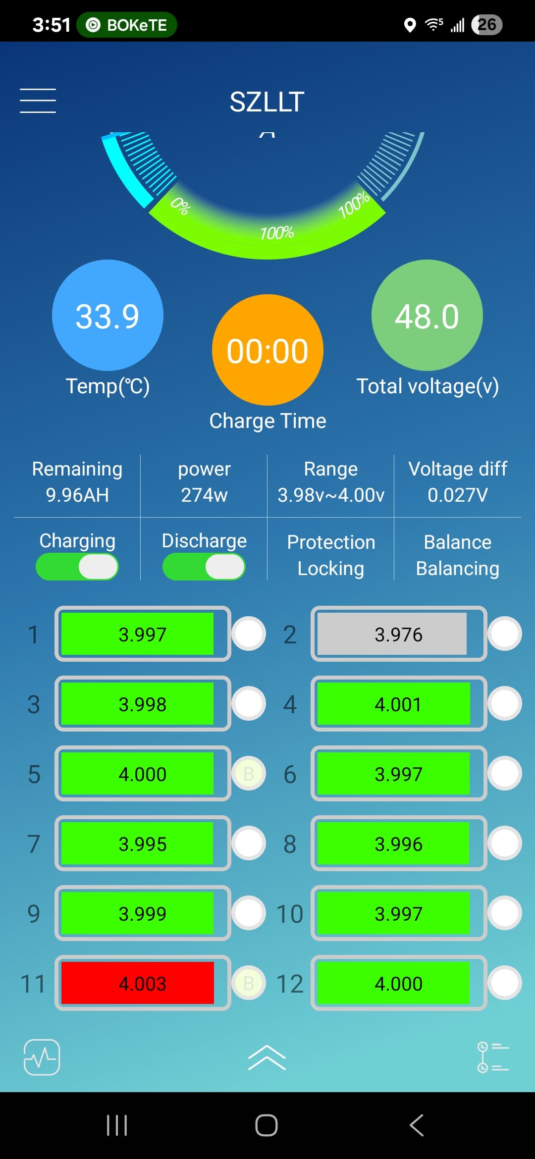

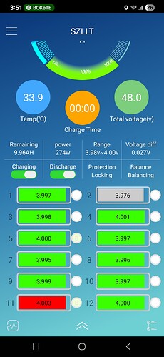

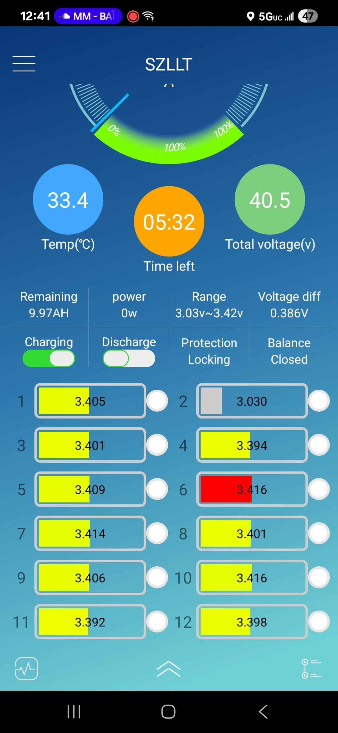

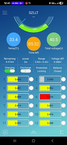

How dangerous is it for me to run and charge my old 12A7P pack with a suspect P Group?
Cell group 2 having less capacity , with the BMS bypassed for discharge, would only become dangerous, I think, if the other P groups kept total pack voltage above the programmed vesc cut off voltage, and allowed cell group 2 to be discharged below 2.5v.
The BMS probably would just refuse to allow the battery to be recharged at that point.
So I don’t believe it to be dangerous, unless/ until pgroup 2 is discharged below 2.5v, but that might happen after a few more cycles if that Pgroup has a cell which jumped off a cliff, or perhaps a broken weld.
But wait for more experienced answers.

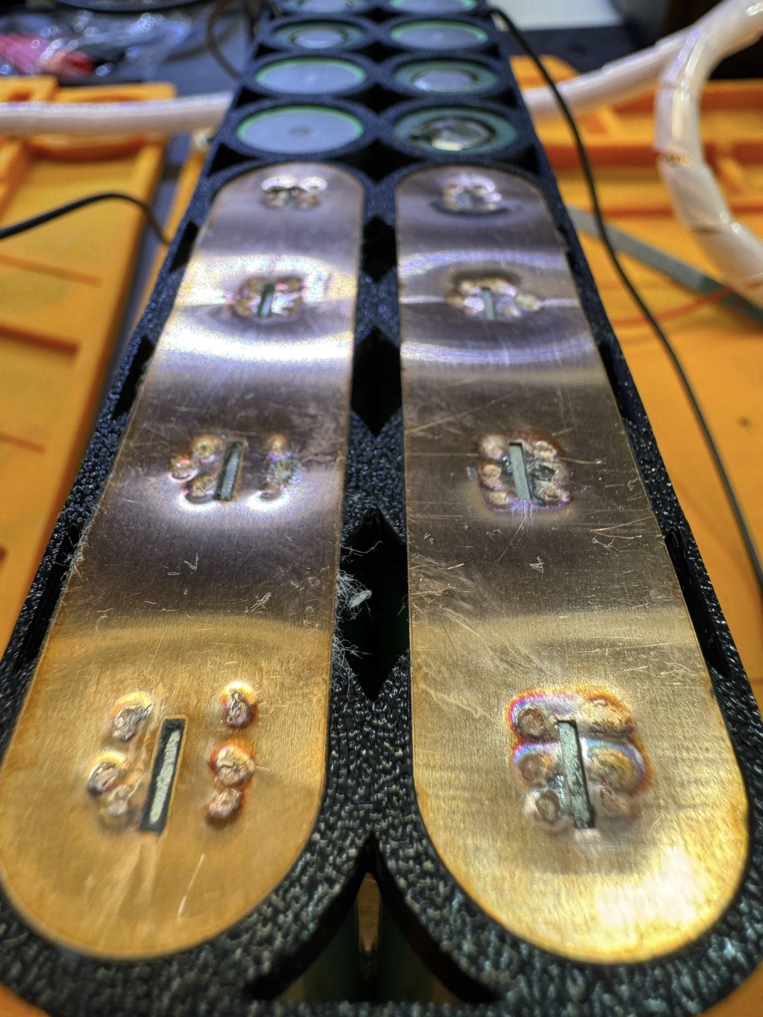

anyone got any tips on how to create this slits so the weld is better? @SternWake how did you weld the 0.35 copper (with flux) but no slits?
Was thinking about some sort of slit maker like a metal punch in this shape. but havent found a good one yet on aliexpress.
I just upped the power. The slits do force the welding current to travel through cell can, and thus reduce the power required to achieve the same strength weld. I’d probably use it if I had the ability to easily achieve it.
With tabless cells, I kind of want to use a round hole instead of a slot, because one should not weld on the center weld spiral that exists on the EVE 40 and 50PL, the Ampace JP40, and the Reliance rs40 and 50. I avoided a similar size area on my Bak 45D’s too.
Got to make sure the electrode does not slip into the slots or you can blow a hole into the can.
Do a search for ā€˜infinite slot’ over on endless sphere.
My first battery build I tried to use infinite slot, but had issues not using enough power. the settings i established on test cells with the nickel plating removed, did not translate to cells with virgin nickel plating. infinite slot was time consuming enough I just used thinner copper and more welder duration, and have said screw the slot ever since, but it definitely has merit.
I have been looking into round hole punches the size of a weld spiral, but should probably learn some CAD and send some files to Nelvick to cut on his laser cutter
