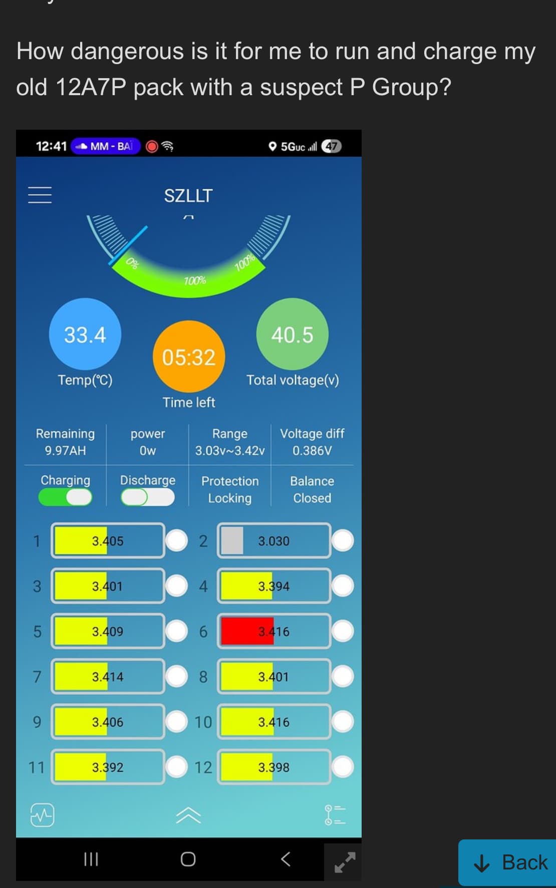

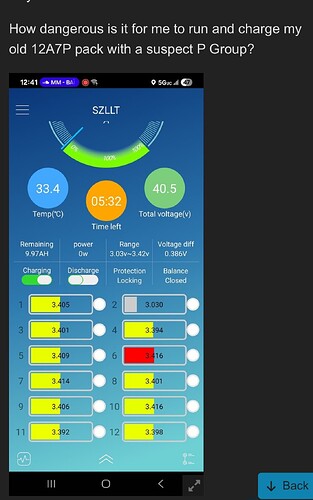

It should be ok to charge.
you’ll want to watch how it discharges. and you’ll probably want to raise the vesc voltage cutoff
start and end to avoid dipping that cell too low. (it will likely drop faster than the others )
if it stays out of whack you’ll want to figure out why. broken weld to one of the pgroup? breaking balance wire?
That group discharges faster regularly. It’s not a new thing.
Has been at least a couple months.
So probably broken weld.
Or more likely one bad cell out of a group of 7?
Broken nickel and a bad cell have the same tell if the cell isn’t self discharging. Id crack it open and check the connection very thoroughly hoping for the easy fix. Much more likely on a flat pack vs a brick though. Otherwise definitely up the cutoff start if it’s not going on the bench soon
What should I set the cutoff to?
Great suggestion @Pecos
@rafaelinmissouri going by your screenshot here i’d set hard cutoff at 40v
I know it depends on a few variables, such as settings and the load.
But I have a 3s1p holder which i can easily remove and replace the cells, and have cycled the snot out of some old reclaimed cells in it.
It has a hard cutoff at 2.8v, and every time the LVD kicks in, and I later measure the cells, it is almost always 3.476, 3.041, 3.468v, eerily similar to the screenshot above.
That weak cell which i have marked is always 3.04v when I check sometime after the lvd kicks in, but the other two cells are then 3.52, then 3.61, the 3.7. It happens surprisingly quickly, like the capacity loss is exponential rather than linear, at least on the old reclaimed early 2010’s LG cells I was hammering.
I guess it is ok as long as the p group rebounds to above 2.5v with load removed, but I might go a little more conservative with a higher hard cutoff voltage, as if it is a weak cell rather than a broken weld or compromised balance lead, that p group will likely start sagging harder faster as it seems to degrade at an accelerated rate, in my limited experience.
agreed.

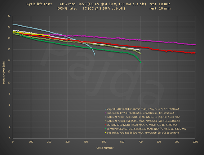

that suprisingly quickly is even on new cells. mostly all the cells we use have a curve where at some point near the end it just starts dropping voltage fast.
I hypothesize that the cell’s capacity degradation rate at near the end of its usable lifespan follows a similar curve, in that once the capacity decline starts noticeably falling faster, it then goes into a nosedive, like the vapcell f63 and samsung 58e in Pajda’s cycle life testing.

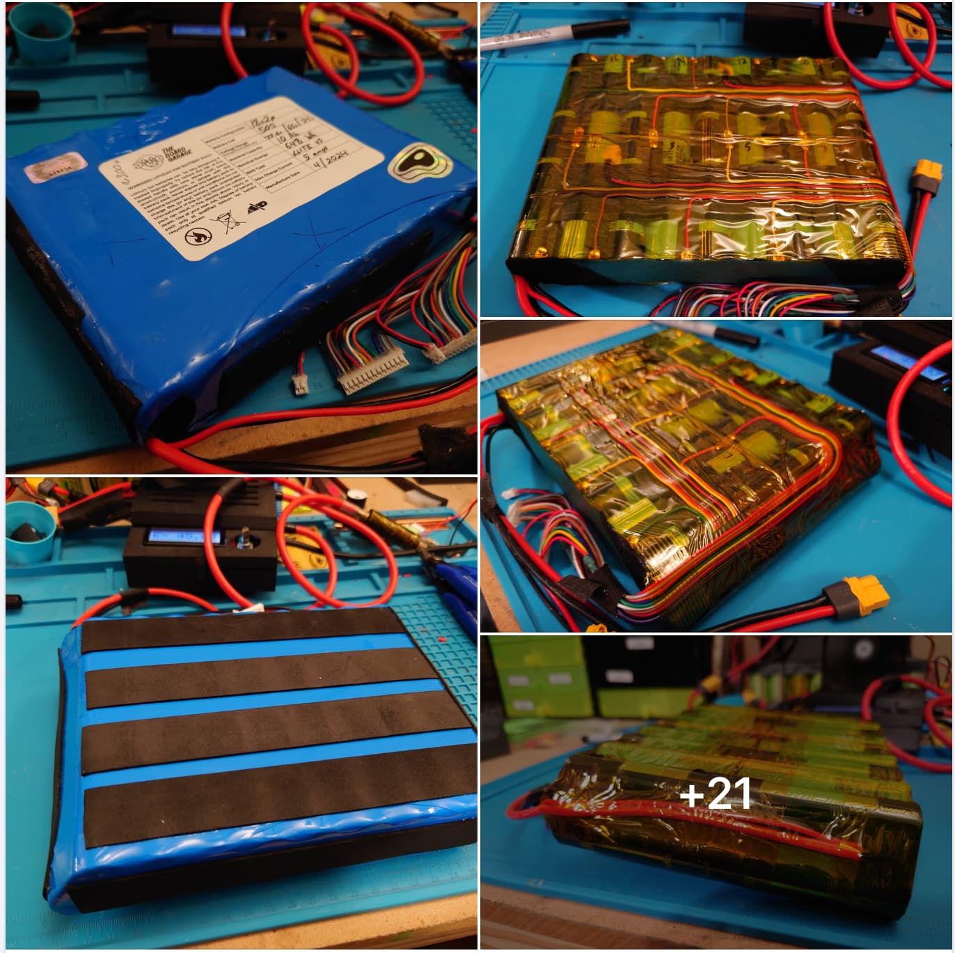

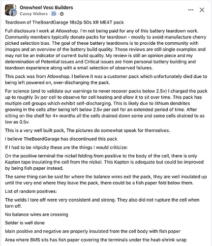

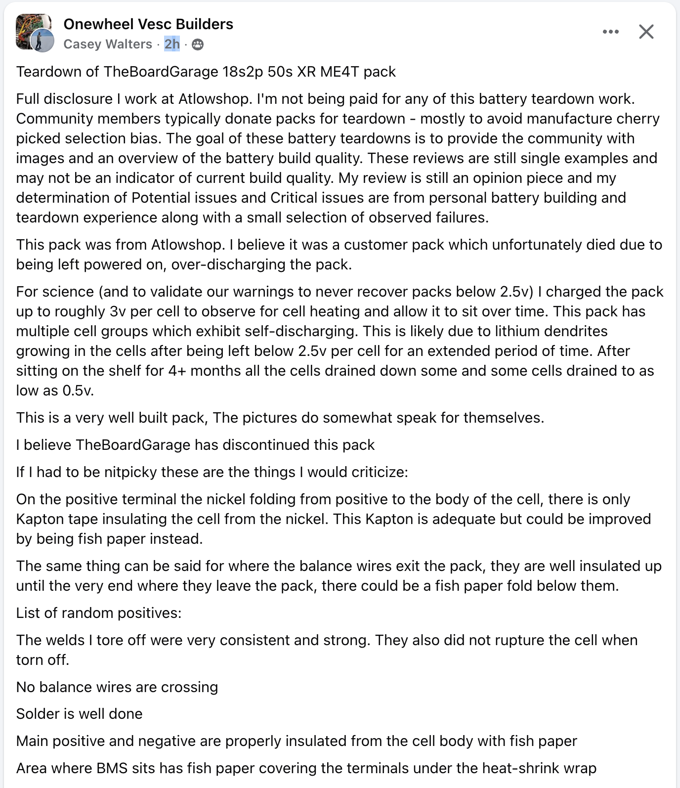

This is a very well built pack, The pictures do somewhat speak for themselves.
:clap:
(what i expected. )
