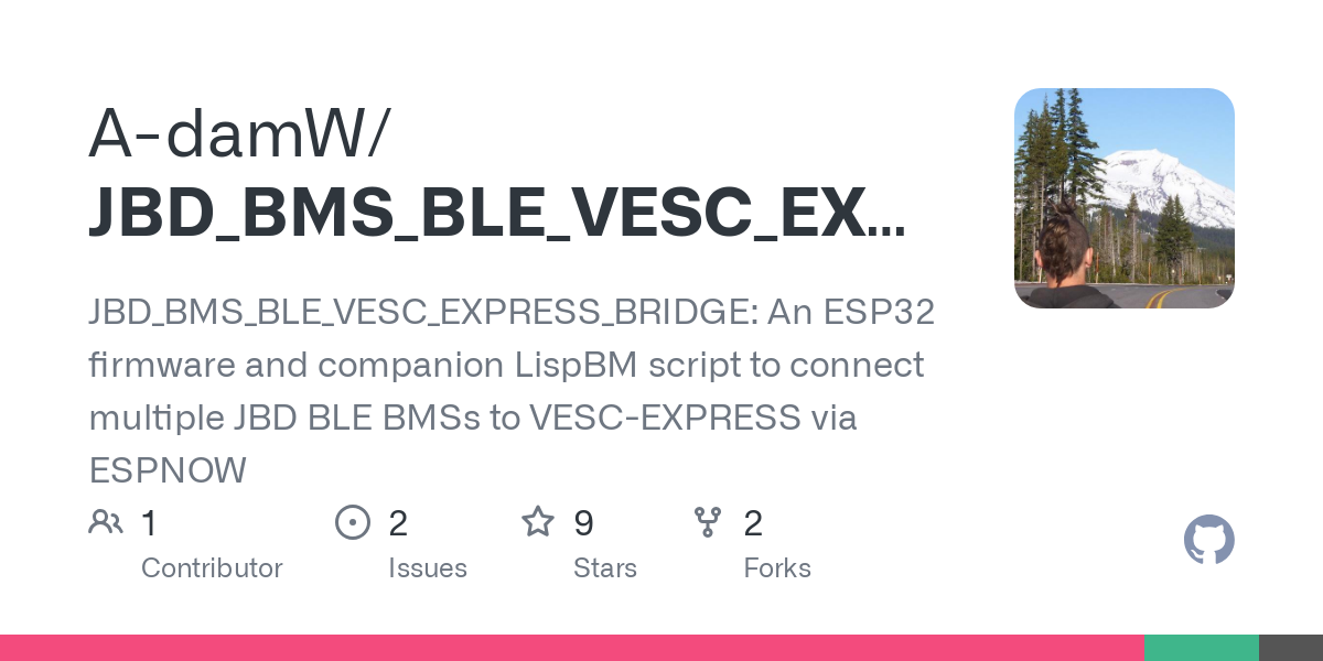

Alrighty folks, welcome to my first topic here on esk8.news!(Ya’ll are pretty awesome by the way!)
The TL,DR; An open-source, intermediary ESP-32 Bluetooth/ESP-Now bridge between a jbd bms and a VESC Express, to transmit all the cell voltage data(and more) to a VESC controller.
I’m going to be a little bit lazy right now, and just post a link to the Endless Sphere thread that I started last year;
Feel free ask to questions, I will answer them as I am able.
Edit, Github link;
