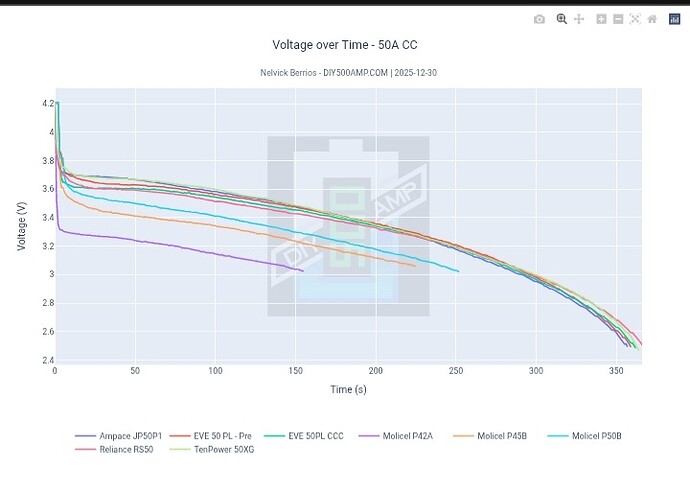

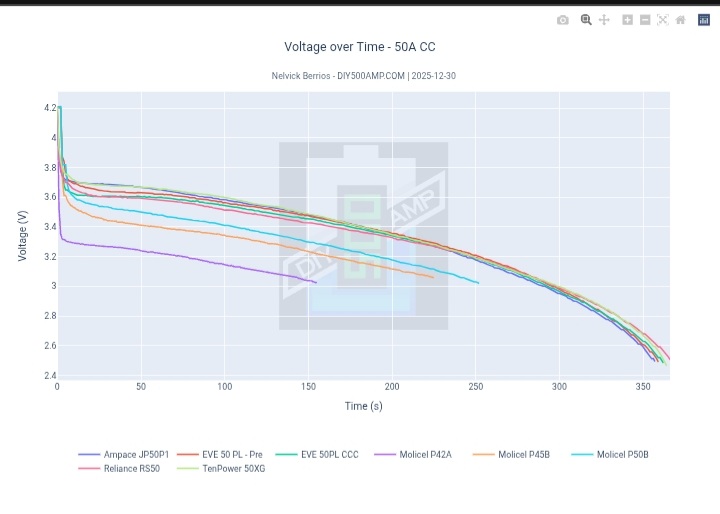

This is a 50amp line chart showing the usual suspects vs the latest and greatest tabless cells.
Yeah P42a, P45b and P50b arenāt rated for 50A continuous. They start to reach their 80°C cut off temp when push around 30-35A continous.
Not always true.
The 50S2 beats the tabless by a bit at low to moderate power levels and the 6Ah energy cells beat out all of the tabless power cells at low power levels.

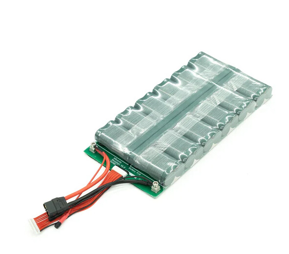

Iām planning a 12s2p battery build for a Loaded Coyote setup Iām putting together.
If anyone has built one before, would you be willing to share some pictures of how you laid out the cells?
Iām considering a layout similar to this (minus the PCB), but Iām a bit concerned the tabs may be too small to comfortably solder 10-gauge wire for the series connections between groups.
Any insight or photos would be really appreciated.
They sell their PCBs for pretty cheap why not use one?
Soldering the groups together has been the hardest part for me so far, and I have an even harder time soldering the main lead wires with the extra contact to the tab.
Because of that, Iām a bit concerned about how difficult soldering directly to PCB tabs might be. For this build, I made sure to pick up some thicker solder, so Iām hoping that helps things flow better and gives me a bit more confidence.
I really want to give a PCB build a try, though.
What iron do you have? A good iron makes soldering so much easier. I can highly recommend the āksger t12ā on aliexpress, about 60$ plus 3-5$ per extra tip. Probably available on amazon too. The D52 tip is great for soldering larger stuff for battery building. Can pump it up to 480C for the toughest joints. I can do 8awg with it quite easily at 480C. Generally I use it between 380-420 depending on what Iām working on, and reserve 480 only for stuff like 8ga because the tip doesnāt like 480 long term.
That and decent leaded solder in appropriate diameter go a very long way. Plus if your solderās flux isnāt very aggressive, then extra flux. A good iron and good solder is especially important if your technique isnāt perfect yet.
I picked up one of the blue-and-yellow Hakko irons and have slowly learned to rely on thicker tips as Iāve built a few packs.
I was going through one of the soldering tutorials on the site the other day and realized the solder diameter I was using was probably a bigger part of my problem than I originally thought. Iāve been using Kester 0.031", and this time Iām switching to 0.050" since I was struggling to get enough solder pooled up.
Really appreciate the advice! Iāll definitely try using more flux this time around, too.
In my experience you donāt need or want a lot of flux, especially if you are using flux core solder. The heat in the tip is the key. I use a cheap AF 80w iron with a fat tip and it does up to 8awg pretty comfortably
