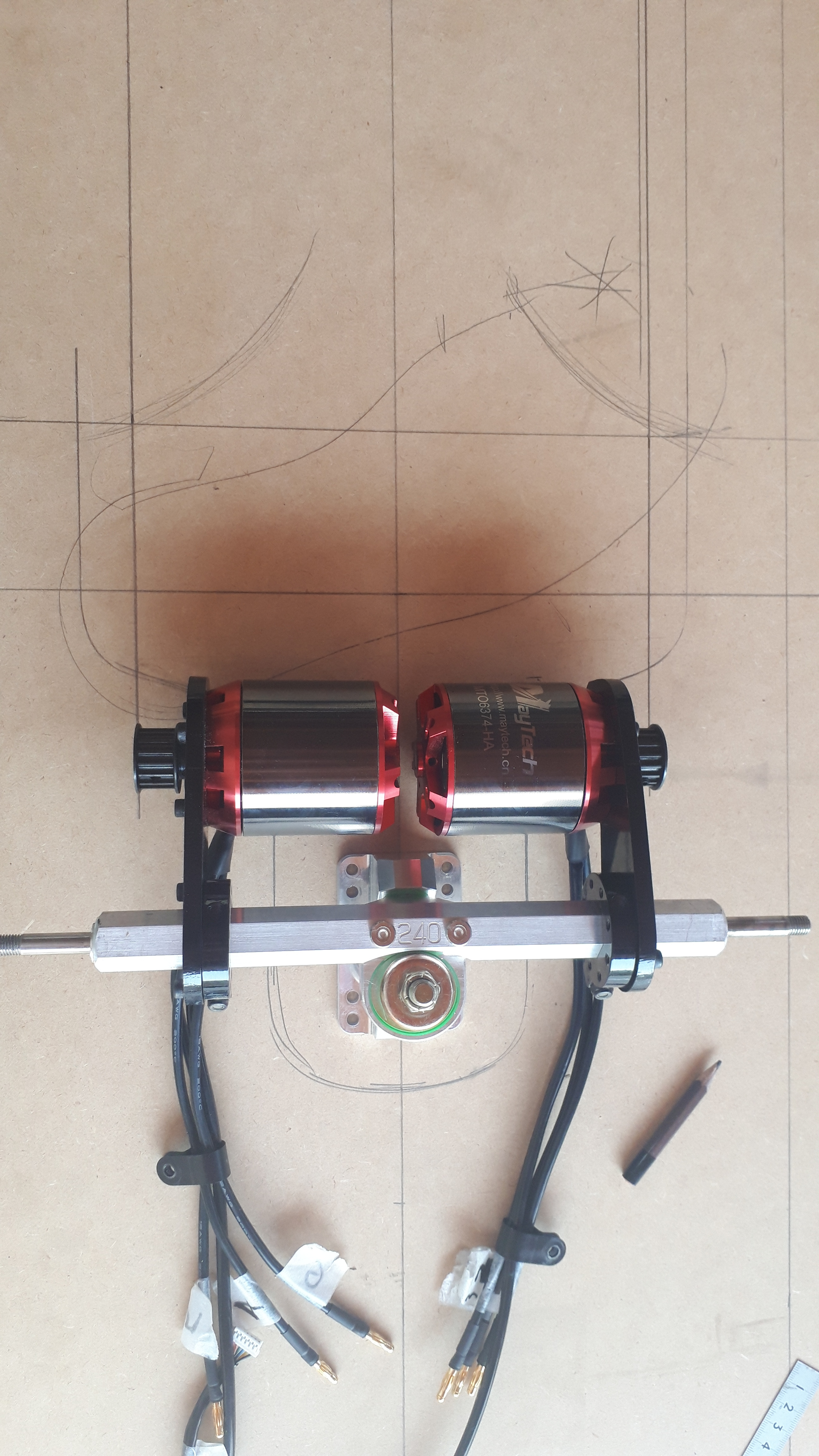

Im going to raise the deck height above the motors for clearance, then drop it down to create a back foot pocket to my liking, then add a front foot pocket that works with angled FF stance.
I like motors in for crash protection of the motors and it wont cost me any enclosure space at all.
It seems Im making a directional esk8 deck
I got the form mold half built today. I think Ill have the first deck pressed tomorrow if Im lucky
What you see will be the top of the deck. I worked out how to really increase motor clearance too, the tail will be 9mm higher than the nose and I will use a 3mm spacer in the front with a 14mm spacer in the back.
Geometry stays the same but I gain bulk clearance.
It has 19mm drop btw.

Unfortunately my press just had an issue as I was pressing the mold together so I wont be pressing a deck today, but the mold is just about ready. Over the mdf will be a heat mat and a sheet of aluminium to smooth everything out and distribute the heat evenly.
You can see I added reliefs at the back for motor clearance.
Im going to sand down some bamboo sheets to 3.0mm so I can do a 5x3 laminate. 15mm total thickness.
Then Ill go to buy the bits I need to fix my press.
