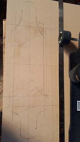

Ive got a new project.
Im going to make a deck that fits 12s6p in this config. Routed in to the deck.
I want to keep it as close as I can to this 76cm wheelbase as like the turn radius.

I drew it out and marked where my toes sit. Im going to make the new deck so that it has nice complete camber pockets all the way around the nose and tail
Can I pick one of these up when I pop over to pick up my snowboard?:grin:
Ill probably press a few extras lol
