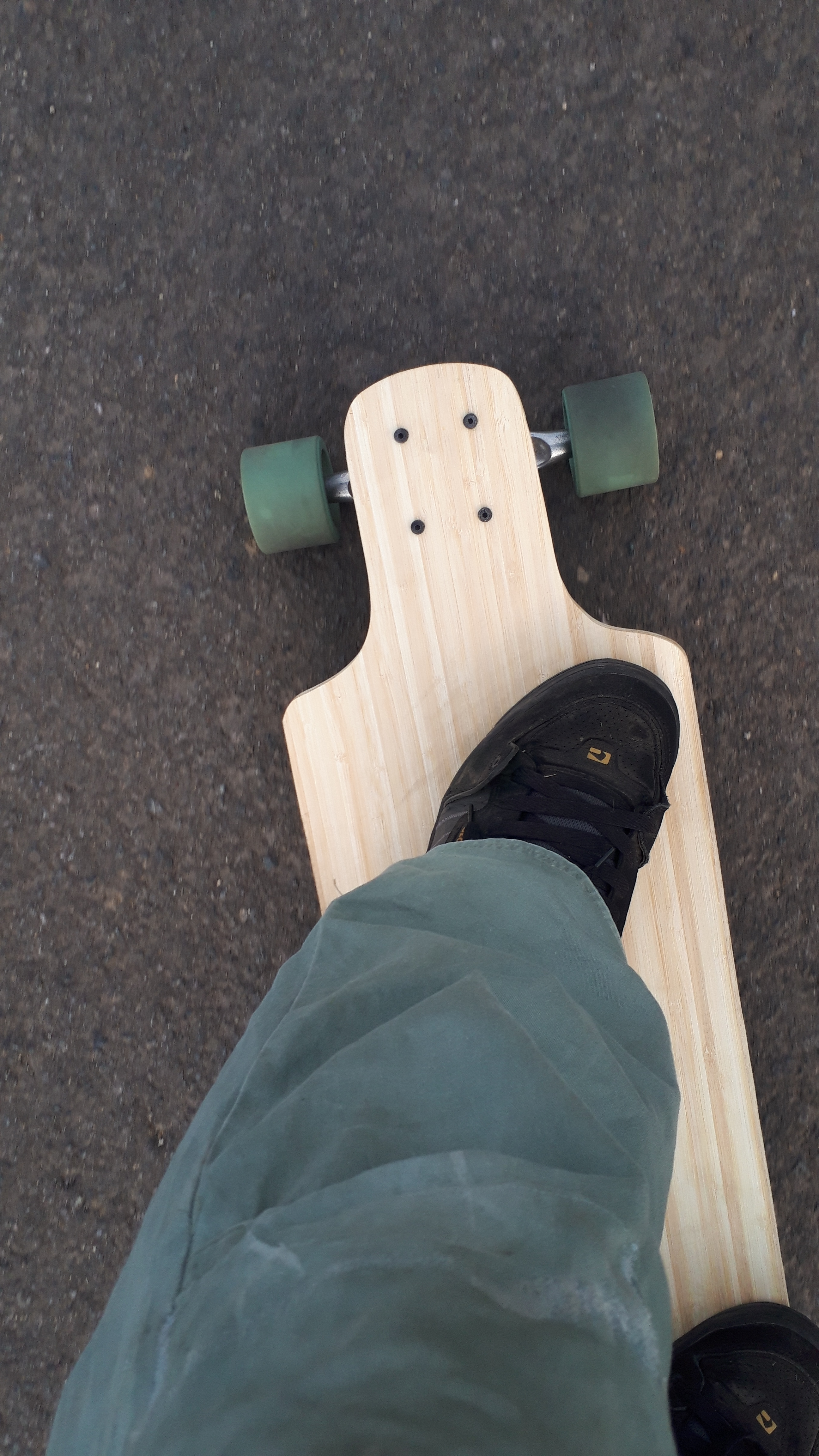

I just took it for a spin, leg powered.
Its far to flexy to use with an enclosure and the flex is a major mismatch with those bigass trucks and 107mm wheels. I will swap it to some smaller trucks and wheels for my afternoon skate today and see how that goes.
I think the drop down angle induces flex just by standing on it. Design flaw right there.
I can go 2 ways now, stick with 100% bamboo, change to 7 ply and add some triaxial fiberglass or change to a hardwood.
It was fun to ride though, I made my own deck in 3 days and rode it on the 4th day. Self high 5 right there lol.
I will definitely go into production AFTER I get my shit perfected.

Fast esk8s love stiff decks.
One of the most successful decks out there is the Landyachtz Evo and it is 10 ply maple.

Stiff AF lol.
Lol, it still flexes.
This is a previous iteration of my board with a different enclosure.
Flex rating 11/10

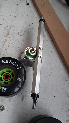

I keep scraping the deck on the road mid turn so I need bigger wheels. I went to put the 107s on and found both inside bearings on the front truck now refusing to slide off.
I need to get this deck on big wheels and risers asap
6 inch nummies
