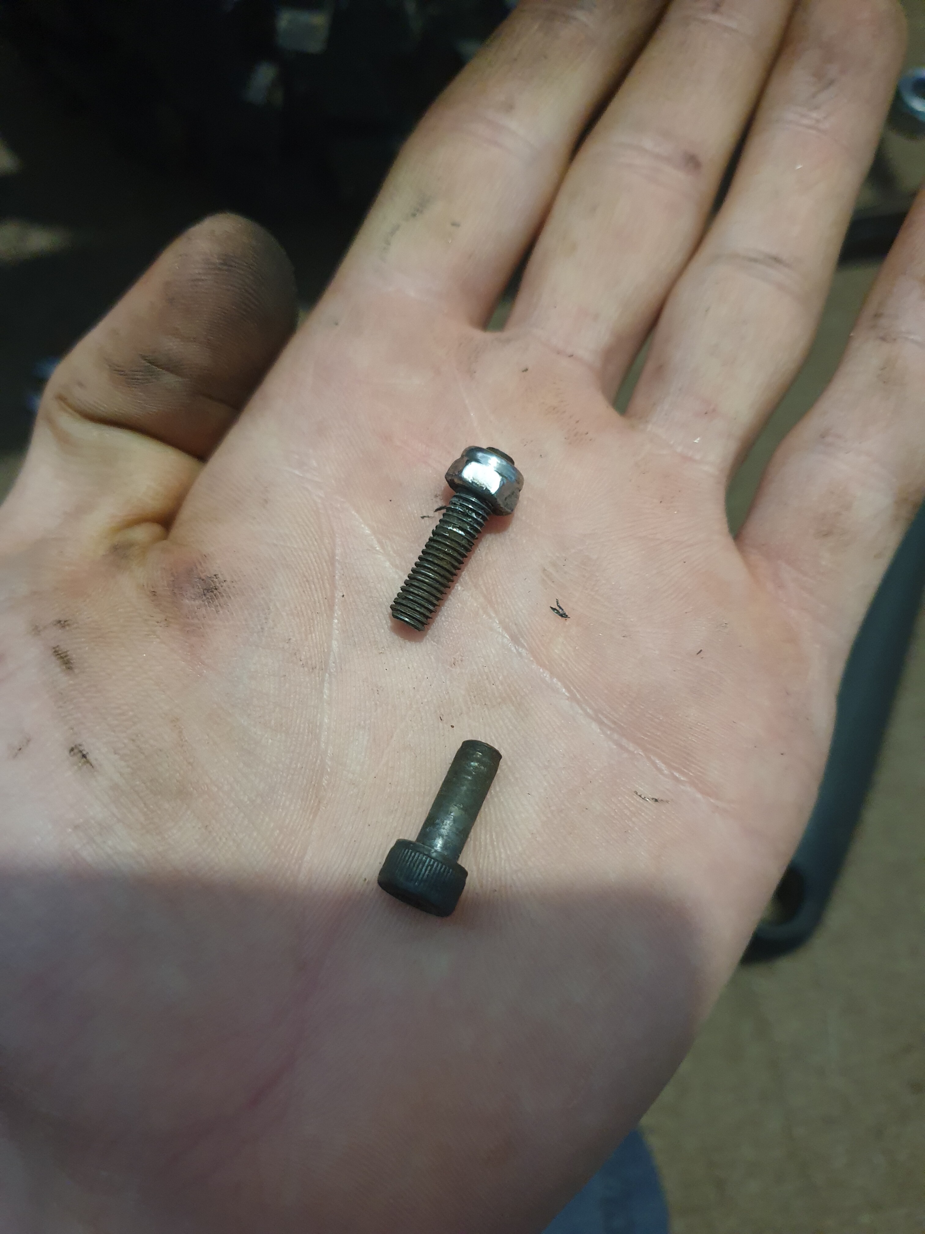

Ladies and genitals, the ground wire is el fucked.
This is probably why the sensors are clapped
Should be an easy fix :ok_hand:
switched the plugs on one of the motors and got the sensors working again.
and i’ve decided to revive this drive until ‘The Iron Giant’ is done.
Hit those ends with some hot glue, the wires often tend to come loose at the connector.
Them bad bois are now soldered and crimped into the connector
The m5 screw wasn’t bent it had snapped. The aluminium is fine, replaced the lock nuts and added crossbracing
