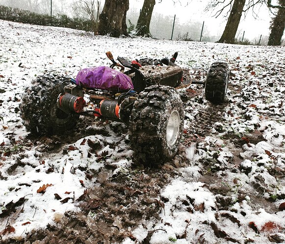

The Apex MUD MONSTER, Apex predator deck| vesc 6 mkIII | 1:7.5 two stage chain drive
they are 0 degrees, but the break makes it look wonky.
steel trucks are heavy af
you NEED hardened steel axles (i made my own)
Your welds must be good or you’ll have street face
don’t go as wide as me, you encounter a lot of issues
dual kingpin trucks feel pretty strange tbh
i have a pattern for channel trucks but haven’t had time to make them yet

they feel more carvy then channel trucks and are still quite stable at speed, but they wobble a bunch on rough terrain
I would totally agree with that, mirrors my findings.

I have some big plans for this board, and modifications for the trucks to make them more suitable the the kind of use this board goes through
Finished up my new light bar, the board now weighs in at 32kg with battery and 26kg without.

good to see you’ve put the bracing in between the king pins (learn from my mistakes). on a side note i bent the king pins in my front truck by hitting a tree.
keep me posted on your build
Well I really killed it
Bent the front king pins
Turned a m5 12.9din bolt into a banana
Killed the sensors
Everything is loose, not like the threadlocker is gone, as in the aluminium holes in Everything is wallowed out
And the torque from the motor is twisting the motor mount into a pretzel.
