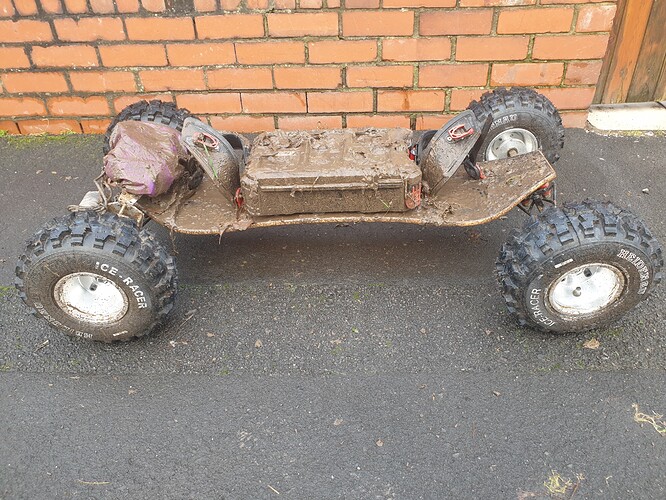

so a bunch of stuff has changed with the board since the last update
the main parts are the vescs are now mounted on a brace on the truck and the axles in the trucks are one large hardened steel bar, and the fact that one side of the drive is broken again
Big thanks to @Andy87 for helping to pic out hubs for my new tyres.
11" tyres are in a complete league of there own. Round my area there is a bunch of boggy mud which these things can completely tank through. I have had to run the motors in sensorless mode as the vescs no long detect them, will probably test them to see if the hall sensors have died or the pcb they are on. I will definitely be upgrading to 4wd using 2 80100 motors and a fixed axle. And now mud guards are a must as you look like swampthing after riding.

little update on the motor sensors, the reason the vesc can’t detect them is that some of them are dead.
lucky i have some spares laying around so should be an easy swap
More updates. Broke a solid steel base plate, managed to hit 108wh/m
Fixed the broken base plate

Did the breakage result in a crash or anything crazy?
May i also ask what angle these baseplate were welded? They dont seem exactly straight but that could also be the breaking ofcourse :rofl:
Im gonna go your way and weld my own mtb trucks like yours, very inspired!
sadly not, it was just some gnarly terrain and the fact i still do jumps with it
