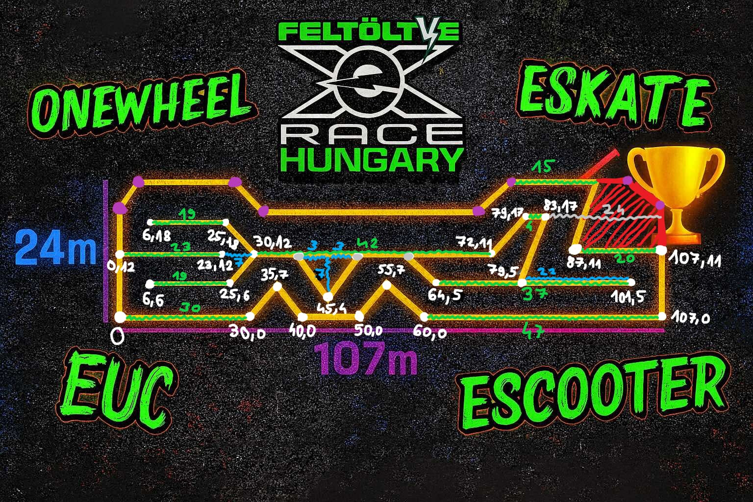

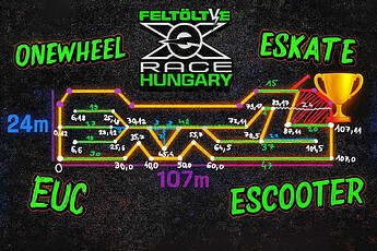

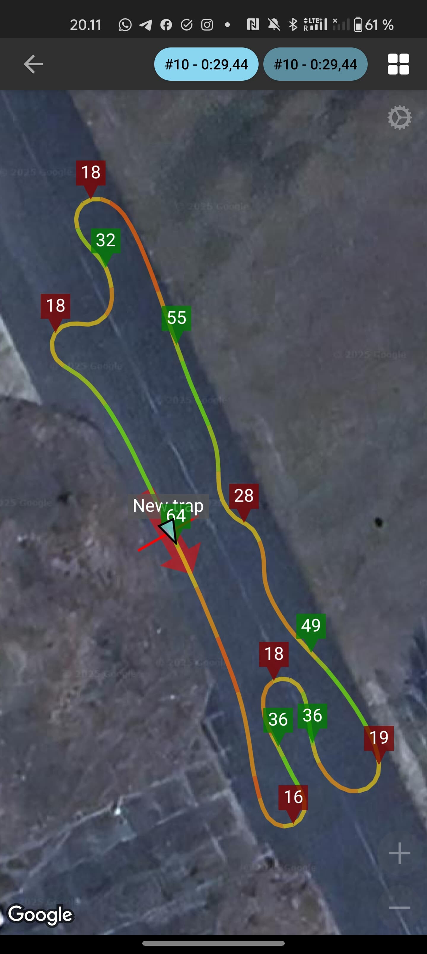

The only corner type where this setup doesn’t feel perfect is an aggressive multi chicane / slalom at a speed that I would define as inbetween medium and low cornering speed. Like the one on the right side straight here, and it doesn’t help that it was a relatively narrow track with 1 meter high stiff tire walls which I really didn’t want to crash into.
Which is the bottom straight in this track setup picture
This is because switching the direction very suddenly does induce the “power pivot” effect, which means higher truck angle / lower deck lean / less support from the bushings, leading to a lighter steering feel. At higher speeds on wider tracks even in this same corner type you always have enough time to not just fully snap the board from one direction to the other in an instant, so you don’t even really feel this effect.
Even for this specific worst case scenario corner if you are aware of it then it isn’t really an issue, but the first time in this specific corner type at this speed does feel a bit weird. Pretty sure it could be compensated for by higher rebound bushings, but I like the low rebound and low friction characteristics of WFB everywhere else.

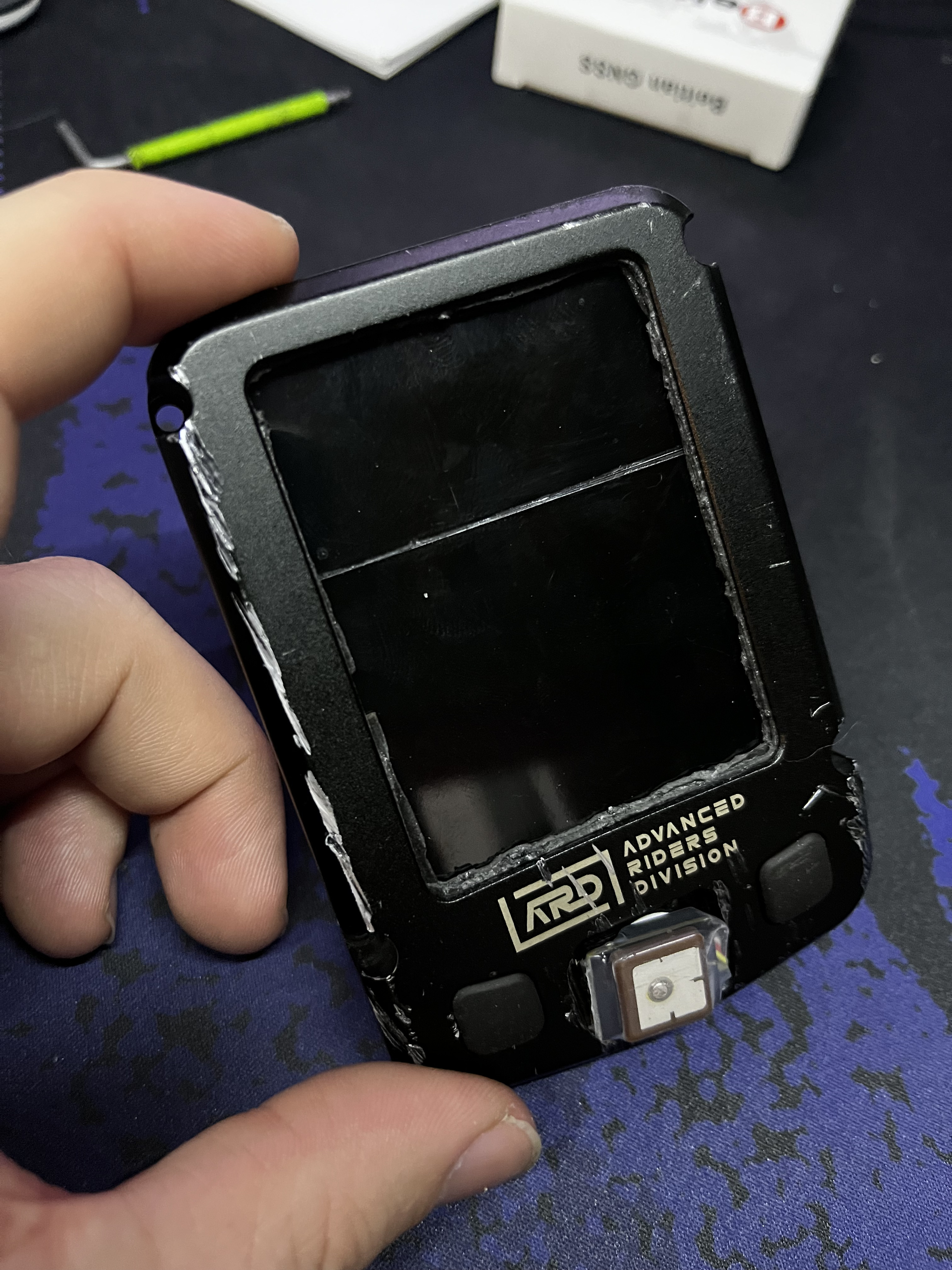

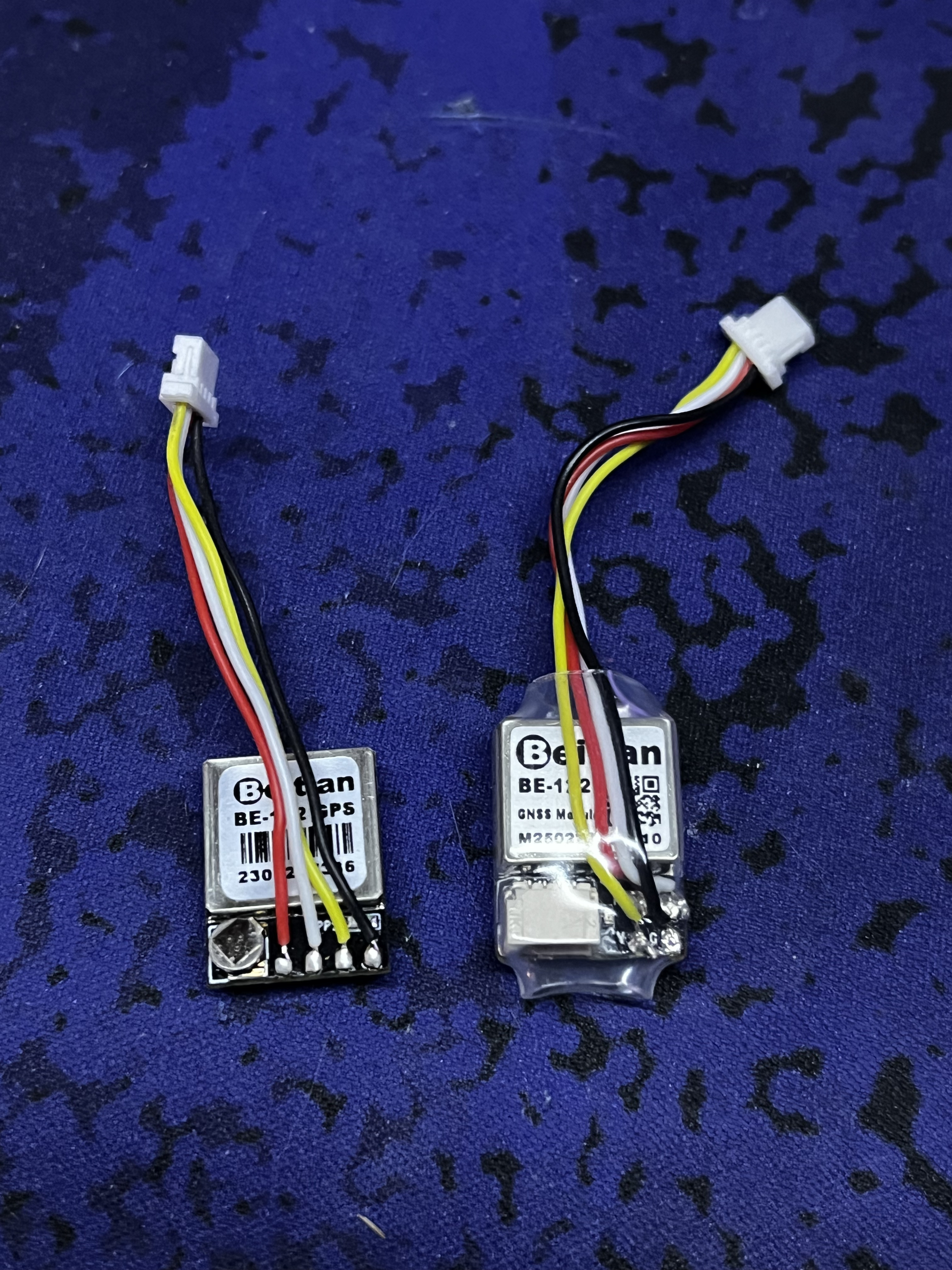

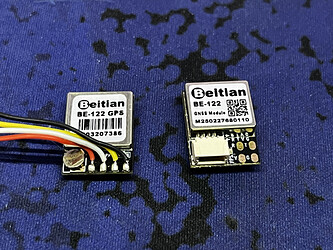

Replacement GPS Module arrived. Interestingly, it has a different form factor then the stock one.
Some educated guesses later, I have it wired up.

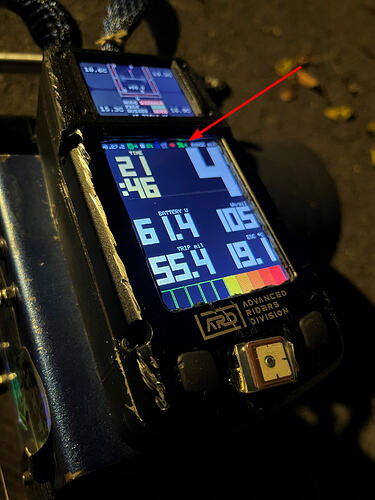

Also took the opportunity to remove the broken glass, reattaching the screen the same way I did with my other megan
Additively, not the prettiest repair job. looks like it’s been through a couple wars lmao

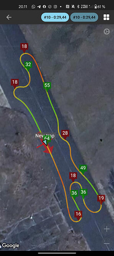

There was no chance at getting a GPS lock inside my apartment building, so I rode down the street to an empty parking lot to test the repair.
BE-122 spec is cold start lock in 30 seconds. but mine took nearly 15 minutes. Even then, it was intermittent and only max of 5 sats (instead of 8+).
I have a hunch I need to leave it for like an hour before it’s in a happy state. Hopefully this gets better over time.
The red PPS LED on the BE-122 gps was/is intermittently flashing a couple times. I think that means it's in repair mode?
The only information I could find
Suboptimal GPS performance aside, the recorded metr log has a download button. Problem fixed, woot woot. Thanks @janpom

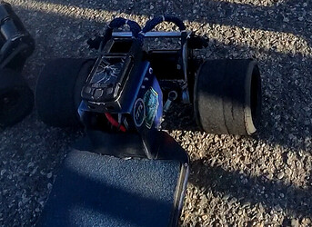

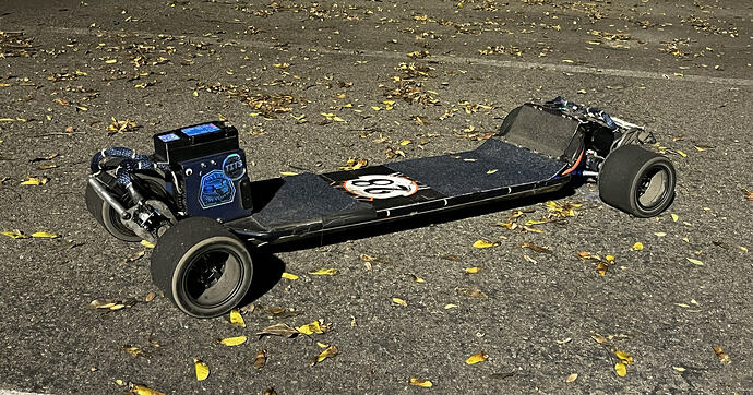

Grabbed a photo of the board while I was waiting. Neat seeing how much it’s evolved over the past two years.
