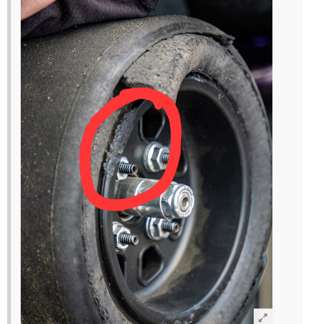

Oh, yes! You’re entirely correct, thankyou. Got my pictures mixed up, this is a picture of crash damage.
Actually, now that I remember, I was behind him so I’ve got footage of the crash! Board hit the dirt and tumbled like nothing else. Crash at 0:10
was too large to upload directly so had to upload as an unlisted youtube video

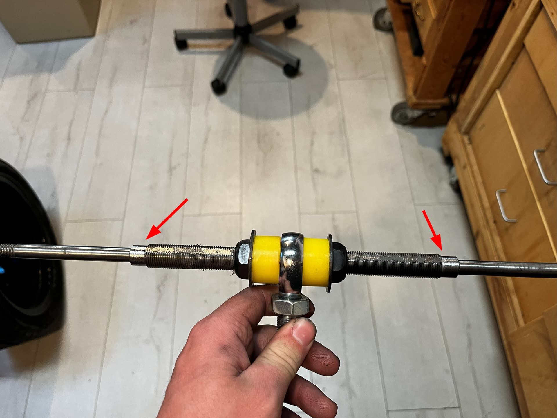

I spend the whole day Wednesday swapping my rear bushing from Krank 87a to APS 90a. Took about 6 hours.
Stripping the hanger went relatively smoothly, until I noticed that my Hym was damaged. I’ve been feeling a slight looseness in the rear the past few months… this would explain what I was feeling.
Sigh. Off to the bin with yee

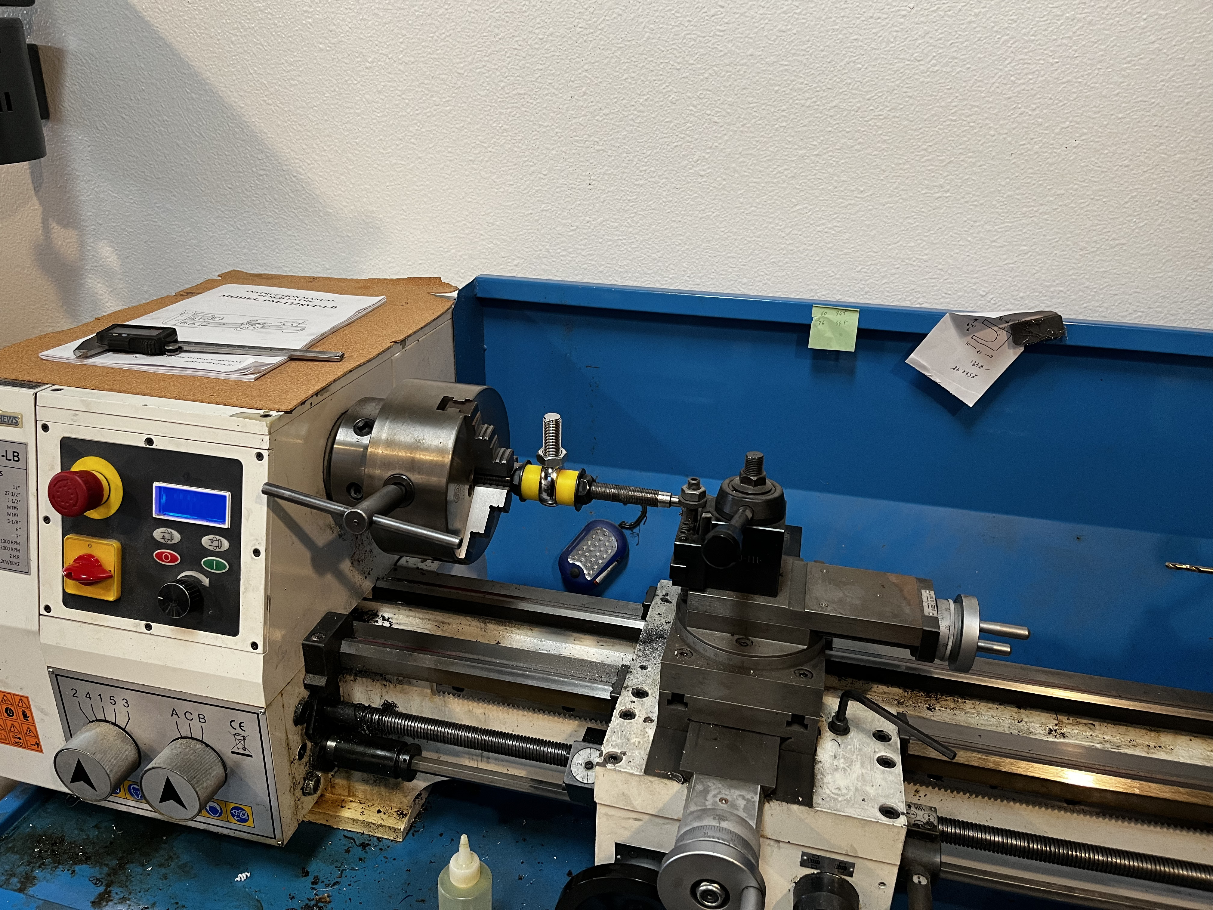

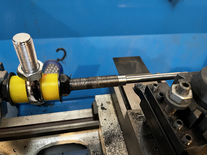

Also, he recently got a new lathe, which he let me borrow (double thanks!). While I had the hanger off my board, I wanted to machine flat ~10mm of threads for reasons
Not the best, but good enough.
Chattered like crazy. In hindsight, should’ve used the tail stock.

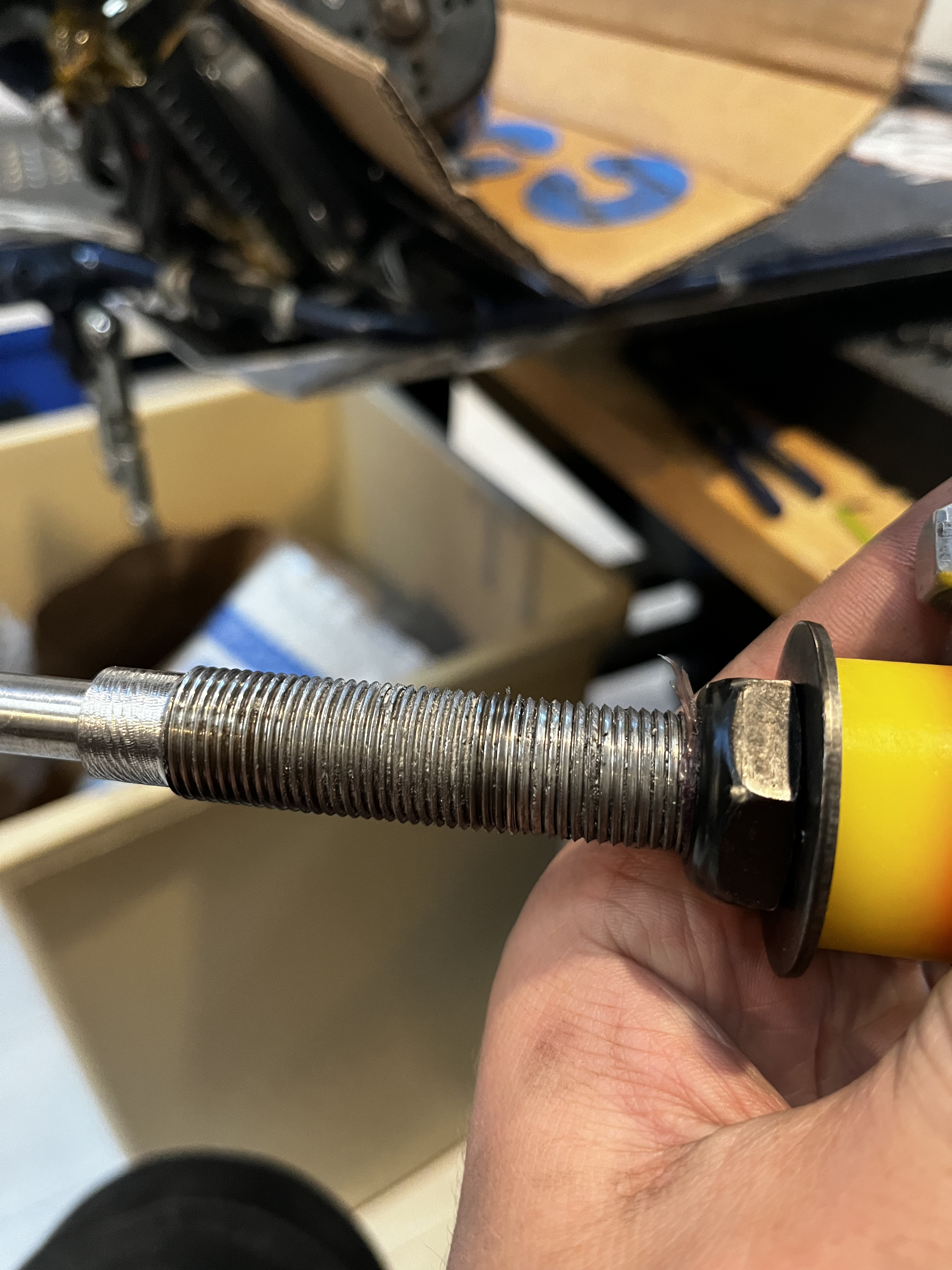

After doing that work, I proceeded to mangle the threads while putting on bushing nuts :face_exhaling:
I think what happened was a small chip came off the slot, which then snowballed as more and more of the thread got torn up as I went down, introducing more chips, etc.

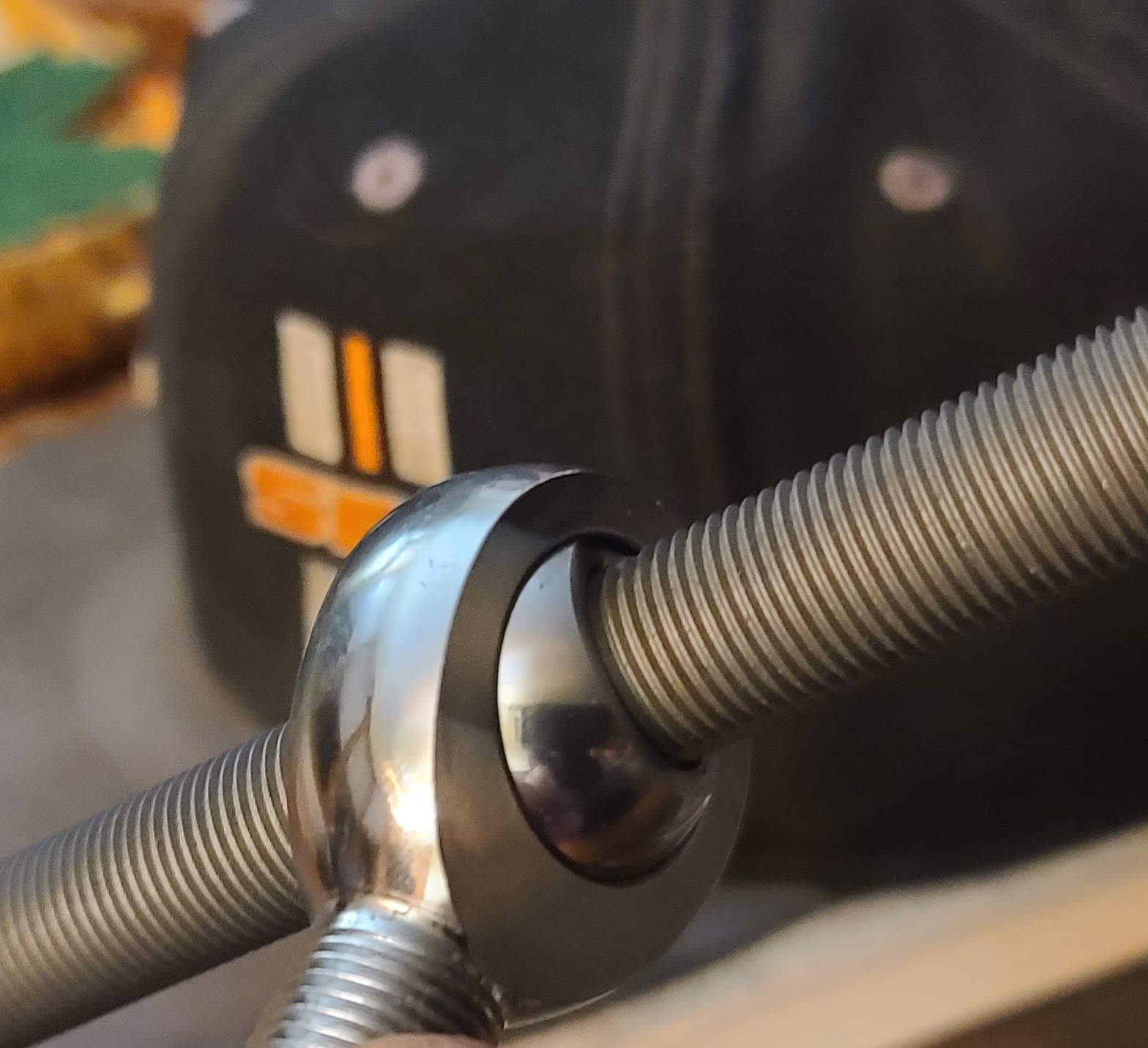

Glad to see you have changed to our latest carrier spherical.
Its been a year since we ditched the composite carrier and switched to the chrome on chrome teflon injected unit.
You will find smooth precise action and long service from it.
I also like the APS action with the chrome spherical.

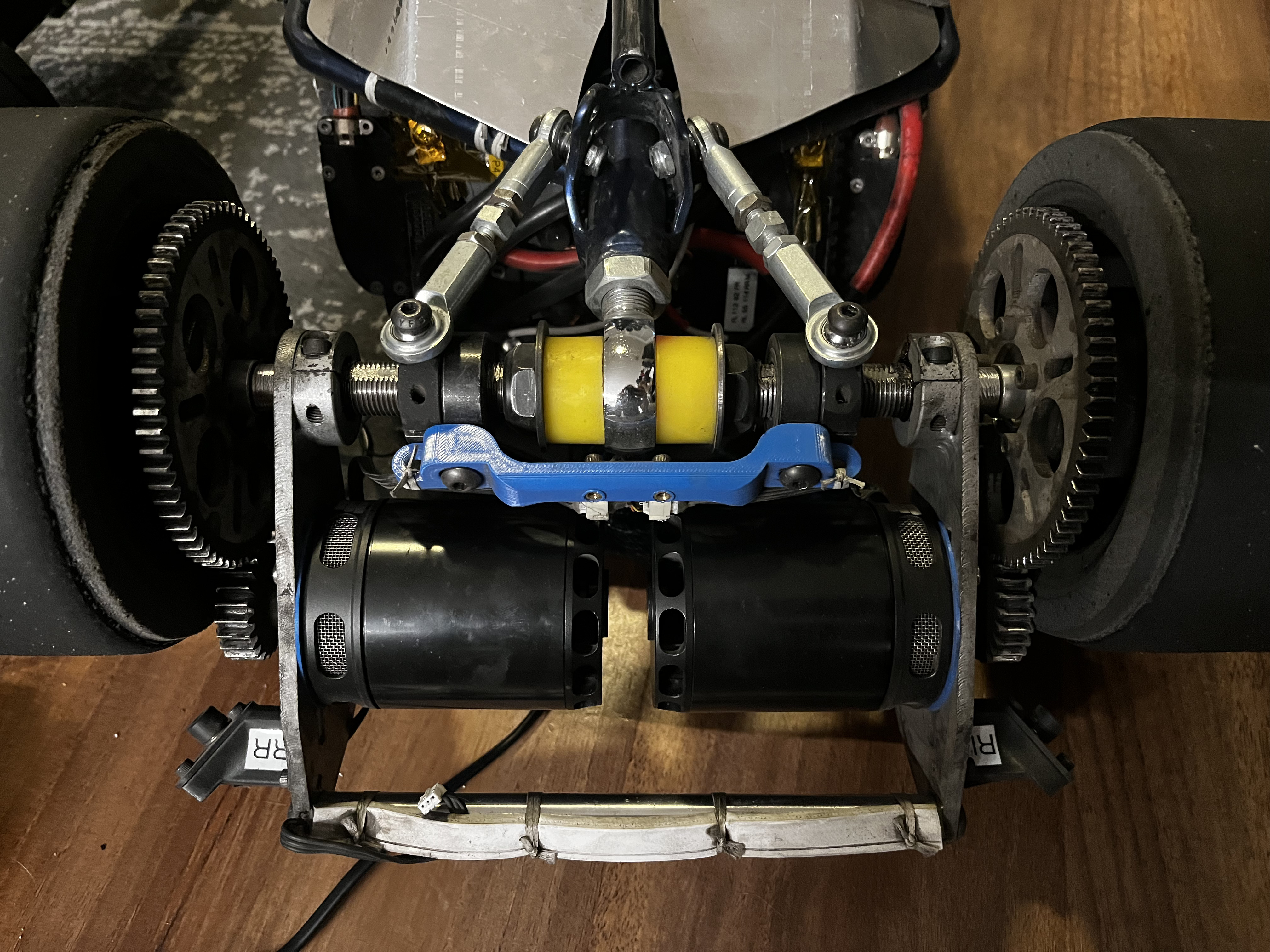

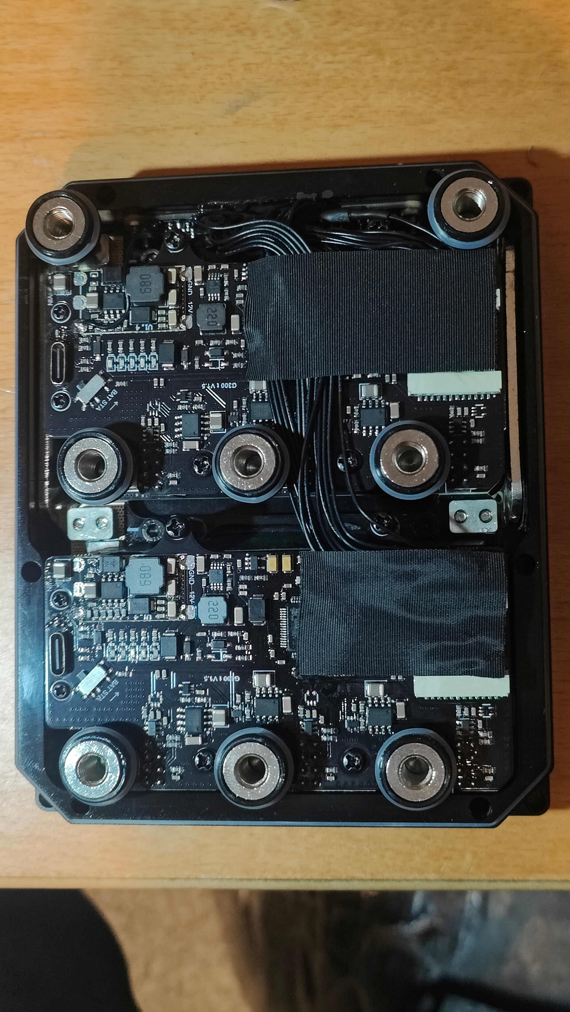

@tuckjohn now that Makerx released a 2G300 controller. Any thoughts on updating your build with that?
It’s 2x single G300s in one alu case. Does look neater and the smaller overall form factor is nice. Exact same electronics though (which is a good thing)
Don’t think it’d be possible, even if I wanted to burn $1200

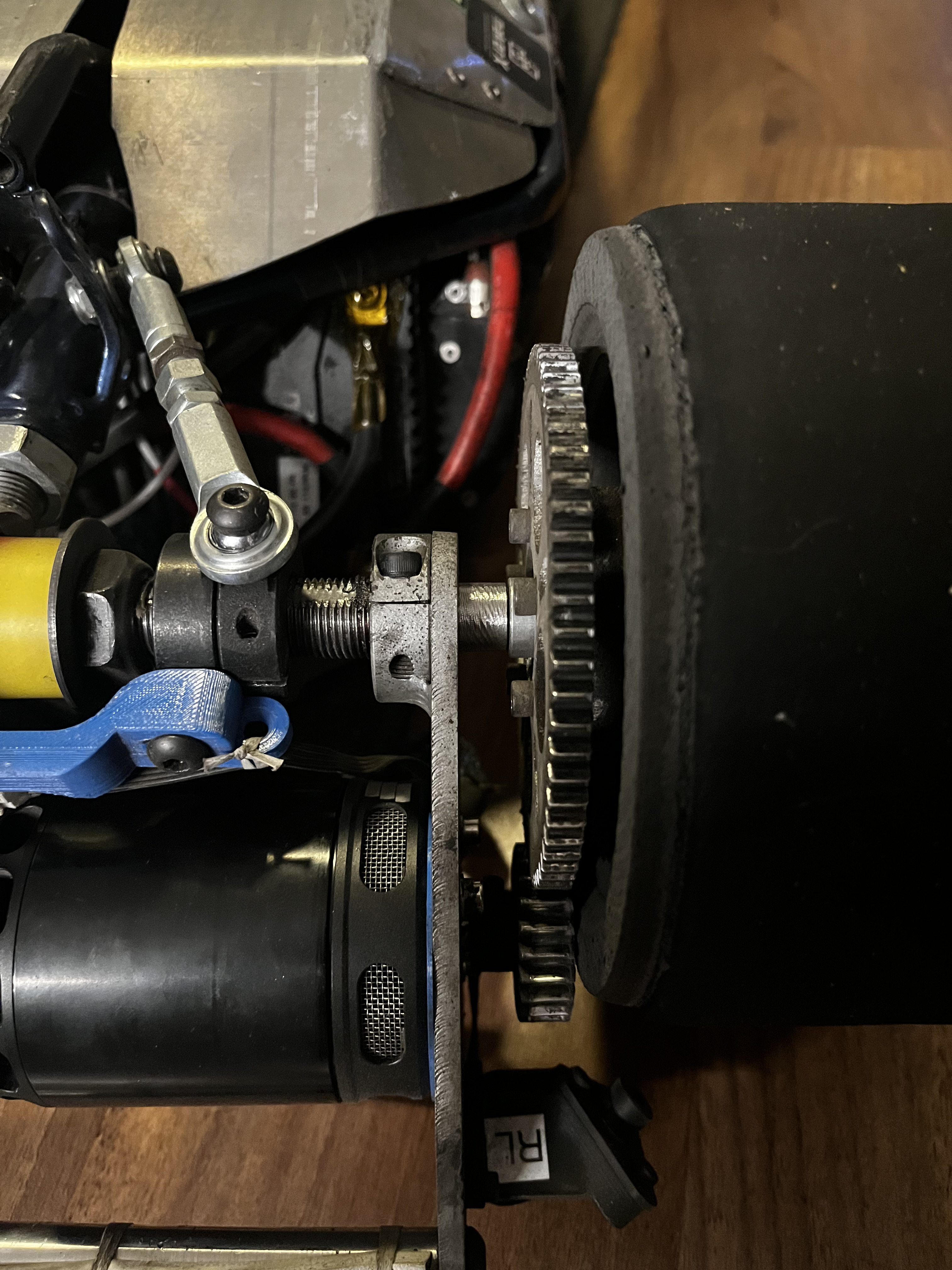

  1. The rear wedge on the V5 has a tube going up the middle of the backside to support it. The G300s are mounted on either side of it. If I replaced them with a 2G300, it wouldn’t be able to straddle the post anymore. And there’s no room to mount the esc on top of the post (very tight clearances already)
  2. The front G300s are mounted facing eachother, not side-by size (so the 2G300 wouldn’t be a drop-in replacement).
  3. all new esc’s is pricy for no benefit (as @Dinnye said)
