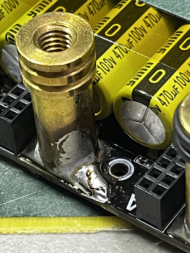

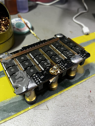

G300 Repair V2

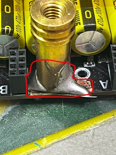

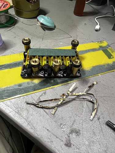

Talking with @YUTW123, he wanted a close up video of the problem with G300.
You can see the broken PCB
In an attempt to understand the construction and apply a more permanent fix, I removed as much solder as I could from the bottom of the PCB.
TIL the terminals are held in place with a Philips head bolt.
The bolt was soldered into the hole, and I couldn’t get it to spin freely to tighten the terminal. The terminal was freely rotating though, so I tightened it onto the soldered bolt
I took a close look at the PCB. There’s an area around the terminal that’s a copper pour filled with vias, whose job it is to transfer the power from one side of the PCB to the other. (roughly outlined in red)
The top layer had broken off, but it exposed some internal layers. However, these part of the internal layers are there just to transfer power to the terminal.
With plenty flux, I removed the broken part of the pcb stuck to the bottom of the solder blob and soldered directly to these internal layers.
Pretty? not really. It works though! Just in time for Legend League

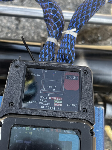

At the end of the final, my tires were at 80C+. Not a system malfunction, I confirmed with a commercial IR gun
Insane. No idea how they didn’t blow up.

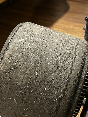

what legend leauge did to my tires

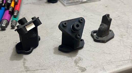

New Temperature sensors
Previously, my temperature sensor mounts were designed to work with a COTS breakout board. Mounting holes on one side, and they’re partially covered by the lens on the low-FOV variant that I use.
Predictably, these old sensors kept breaking (That’s usually why one or more sensors aren’t working in pictures from previous posts)
So I designed a new PCB to fix those issues.
Three mounting points, larger area, and a less flimsy mount.
I wouldn’t dare doing this with the old ones. perfection.

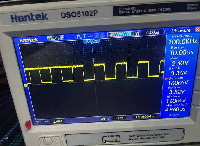

Temperature sensor fix

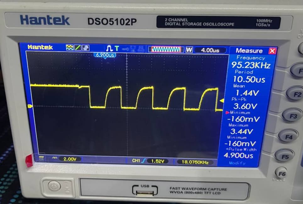

With new temperature PCBs, I was having intermittent communication problems. Quick investigation later, the pullup resistors I used weren’t strong enough for the (relatively) high capacitance bus.
Little soldering later, much better.

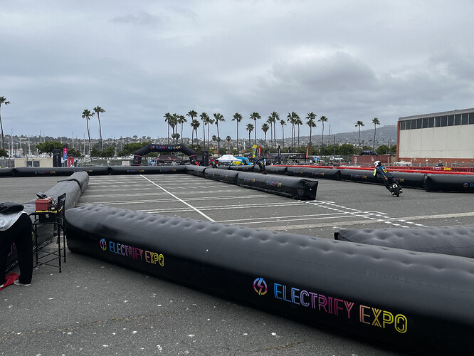

Electrify Expo LA
The track was interesting, with the finish on a hairpin corner.

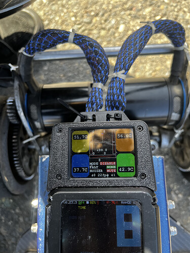

I had some fascinating temperature distribution

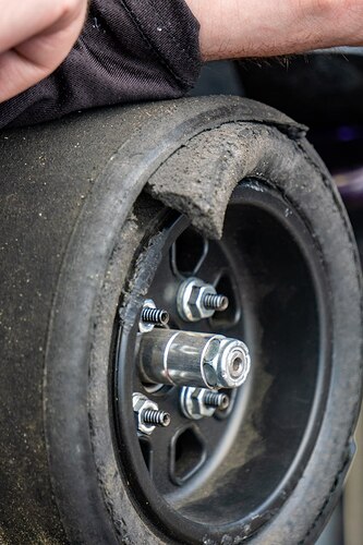

Tons of BRPs were destroyed that day, wasn’t even particularly hot. Just a super abrasive surface.

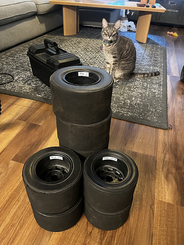

At the end of EE LA, @MoeStooge surprised me with a bunch of experimental wide tires to test!
4x 7" 45a (~830g each)
2x 6.5" 41a (~710g each)
2x 6.25" 45a (~730g each)
(stock 6" 45a is ~510g each)

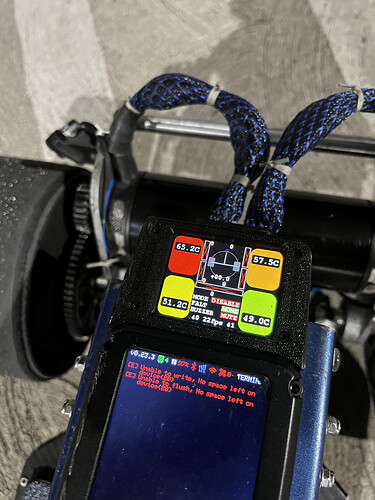

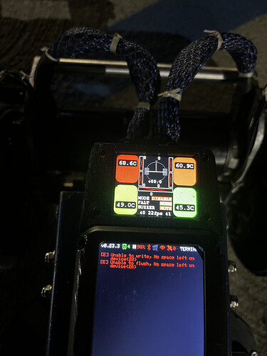

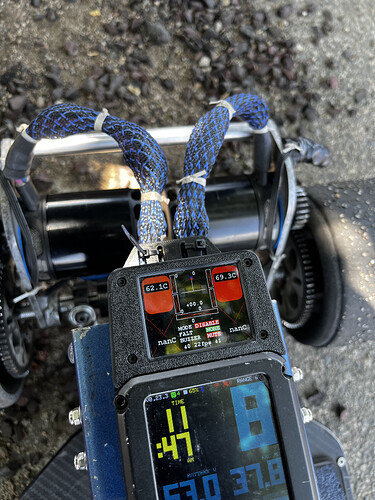

I’ve tried a bunch of different variations. Temperatures were from a single night at the LA garage, which is about the most aggressive surface possible. Weather was typical socal (70F-ish). CCW track, on the shorter side. I’d go until the temperatures stabilized and my legs gave out. Doing multiple stints (from cold) yielded roughly the same temperatures for every combination.

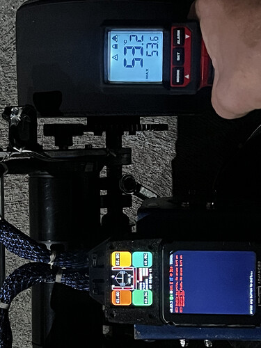

These temperatures are real, I promise
Within a few degrees of a COTS temp gun
6" 45a Front and Rear
What I normally race. For a baseline
7" 45a Front and Rear
Predictably much cooler temperatures (larger tire, more rubber). I tried really really hard to get these up to temperature, but this was the best I could do.

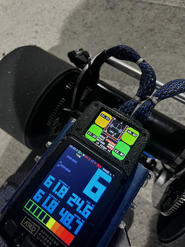

6.25" 45a rear, 7"45a front
Hotter all around?
Had a ton of trouble handling corner exits with this setup. I kept loosing the rear, fell twice. Probably because of the torque difference between the front and rear.

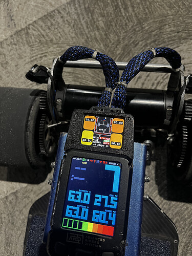

6.5" 41a rear, 7"45a front
Scorching!
This setup felt amazing. Super controllable and smooth, lots of rear grip.
I could really send it around corners, until the fronts started overheating and started sliding more then turning.

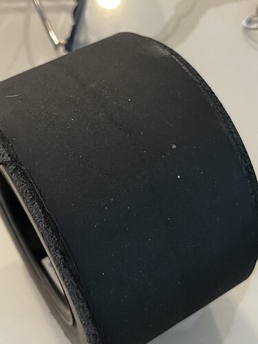

I am pleasantly surprised by the 41a compound. It’s super responsive to start sliding with, had truckloads of grip, and didn’t immediately dissolve. They were more forgiving at low temperatures, and heated up super quick.
The condition of the 41a tires after several evenings of racing

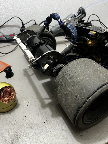

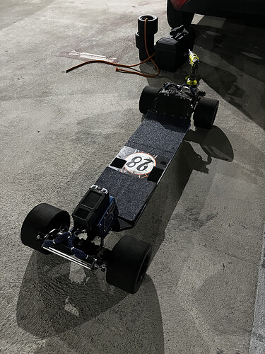

Enjoy a picture of Ankle Wreacher with 7" tires
I catch them cuddling sometimes, but only when they think I’m not looking

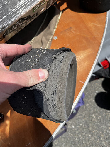

When this happens, what happens to the wheel? Are BRP’s re-tread-able or whatever we would call it? Can you install new foam/rubber on the metal wheel?
When this happens, what happens to the rider ?

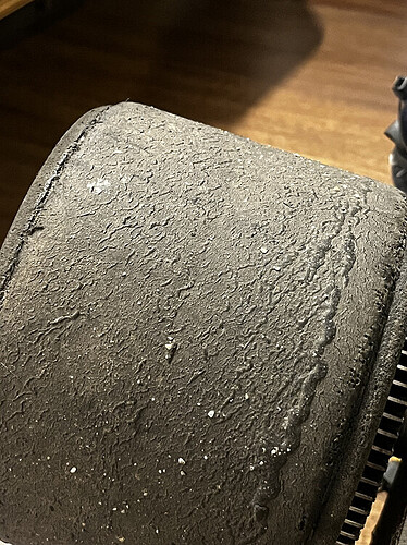

Rough day for BRP at the legend track. This one was from Reggies board. His on/off switch came loose and was ran over by the rear wheel ripping it from the harness. The switch was later recovered from the middle of the straight away. The resusult sent the board into the infield where the wheel in the picture struck a solid object and gored the sidewall.
What they call “dead rubber” This is rubber that is put down on the track (go karts) and then picked up by hot and sticky tires. If you get out of the racing groove it gets much worse.
Normal to see on most raced surfaces. We would use a “hot knife” to scrape dead rubber. This one will clear itself pretty quick at the begining of the next heat cycle.
Good info, but it doesn’t really answer my questions. When the rubber and foam on BRP’s delaminate from each other and the wheel, like in these pictures, what happens next? Is the whole wheel trash? Can you install new foam/rubber onto the metal wheel?
@BenjaminF Once a wheel is compromised, to the trashcan with it.
BRP doesn’t have a core return? Seems crazy not to
Aluminum is very recyclable :person_shrugging:
It’s a plastic rim actually
Really? If this is sarcasm it’s going straight over my head. I know very little about BRP wheels.
Interesting, I assumed it was a metal hub. Makes sense to toss it if it is plastic
It’s actually plastic and it does also deform mid corner. I think it’s one of the reasons why BRPs feel like they allow so much slip angle
