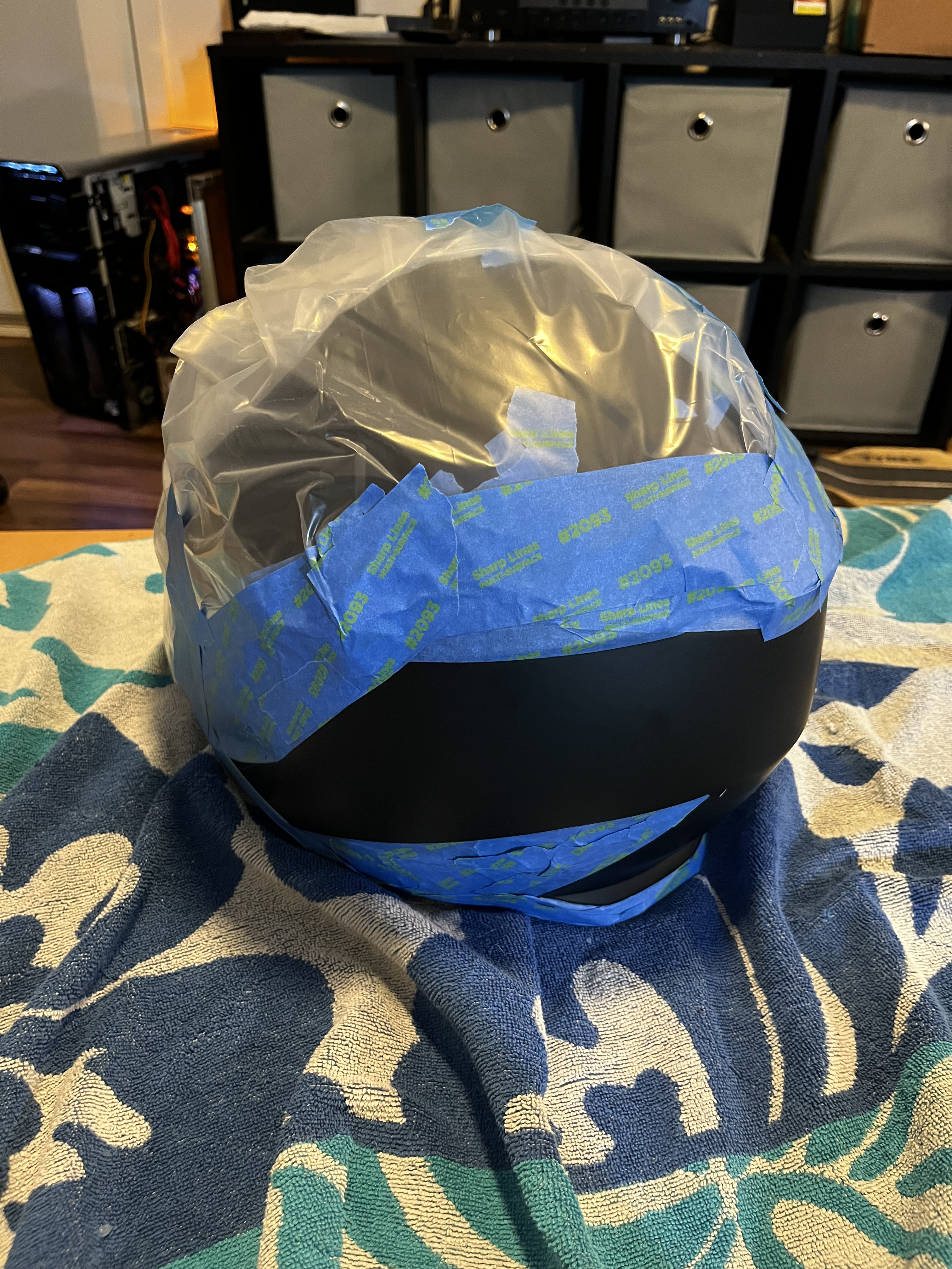

Before the con, gave my helmet a nice rattlecan paint job
Pretty happy with the result

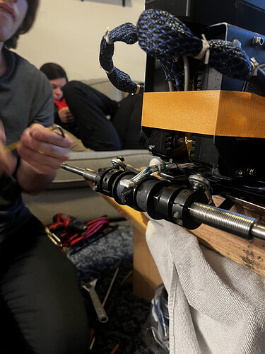

@HAIRYMANJACK Finally talked me into swapping bushings from KranK to APS in the front. About time too- my Krank had some serious permanent deformation!
Everything came off easily enough (with some heat)
And going back on was just as easy. Swapped the old yellow hardware for some sleeker black stuff too
With the two of us working, and a drill to spin the hanger, we managed to swap out the front bushings in only 90 minutes- woot!
Riding it for the first time last night… I should’ve done this so much earlier!! Instantly felt a faster pace. I was confidently sliding the tires on heel and toeside, not something that I’ve been able to do before.

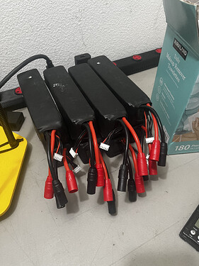

  • Ripping apart my 8x 4s lipos into 16x 2s lipos to get under the 100Wh limit, so I can fly with them

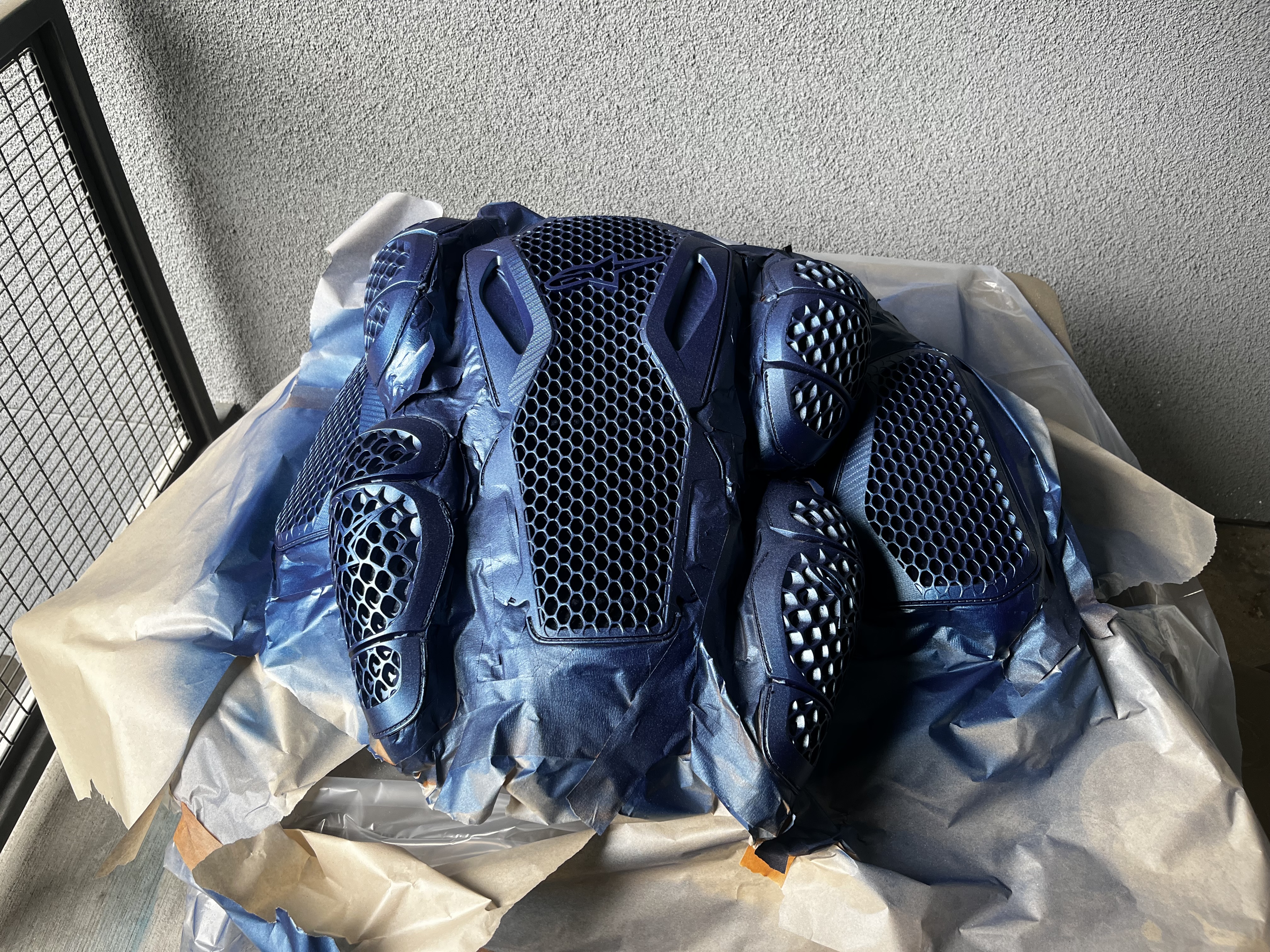

Speaking of, I got another Bionic Action V2. (well, I got a spare for my dad to race with at esk8con. Now, because I shredded my old one with so many falls, I’m now going to use it)
Had to give it a paint job.
Took several days of painting, but psyched with the result. Same paint that I used on my helmet and board… Going to be awesome matching head-to-toe :sunglasses:

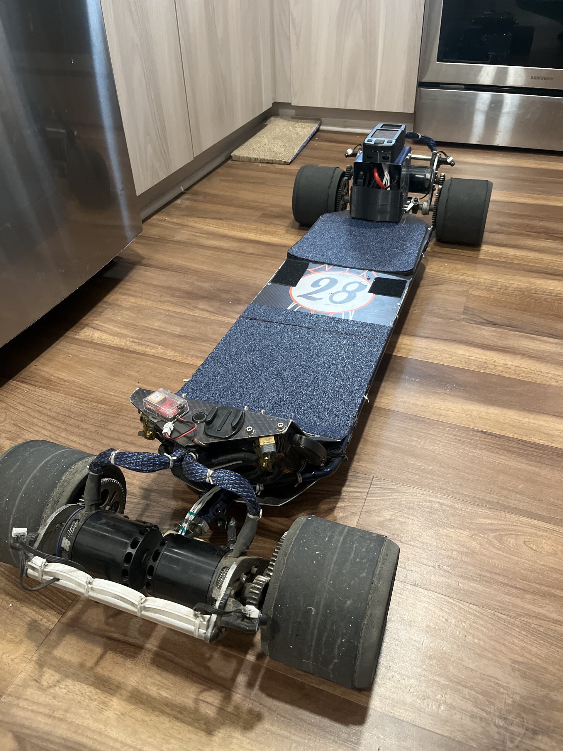

Grip Tape
I don’t run a binding, so my griptape is super critical. I think because I don’t run a binding, I stress my grip a lot more then other people do.
Before esk8con, I was pushing Vicious to the limit, having to replace the rear griptape every 4~5 weeks. Additionally, on hot race days, Vicious would melt, accelerating it’s wear even further. If I left the board out in the sun, I’d end the raceday without any griptape left :grimacing:
Looking for an alternative, I switched my griptape from Vicious to Seismic Skate Lokton 36-grit. It has a paper backing (instead of a vulcunus one), so it doesn’t melt in hot weather like vicious. In fact, the heat-sensitive adhesive actually gets stickier with hot weather! Requires a heat gun to apply to the board.
Even better, this stuff is way shaper (basically glass frit, it’ll draw blood).
And the best part? It’s blue.
A month later of hard racing, it’s showing zero wear. Not an easy feat, super happy with this grip.
Unforunately, it seems to have trouble sticking to my front MBS concave pad.
Over the past couple weeks, it’s actually slid a non-insignificant amount.
It kinda makes sense… the MBS pad has a glossy surface that doesn’t seem like it would be conducive to adhesives.
As a bodge fix, I gave the pad a nice sanding, and re-applied the grip with a heat gun.
Long-term I’ll probably replace the pad with a material that this griptape’s adhesive sticks to better (perhaps 3D printed), but this will do for now.

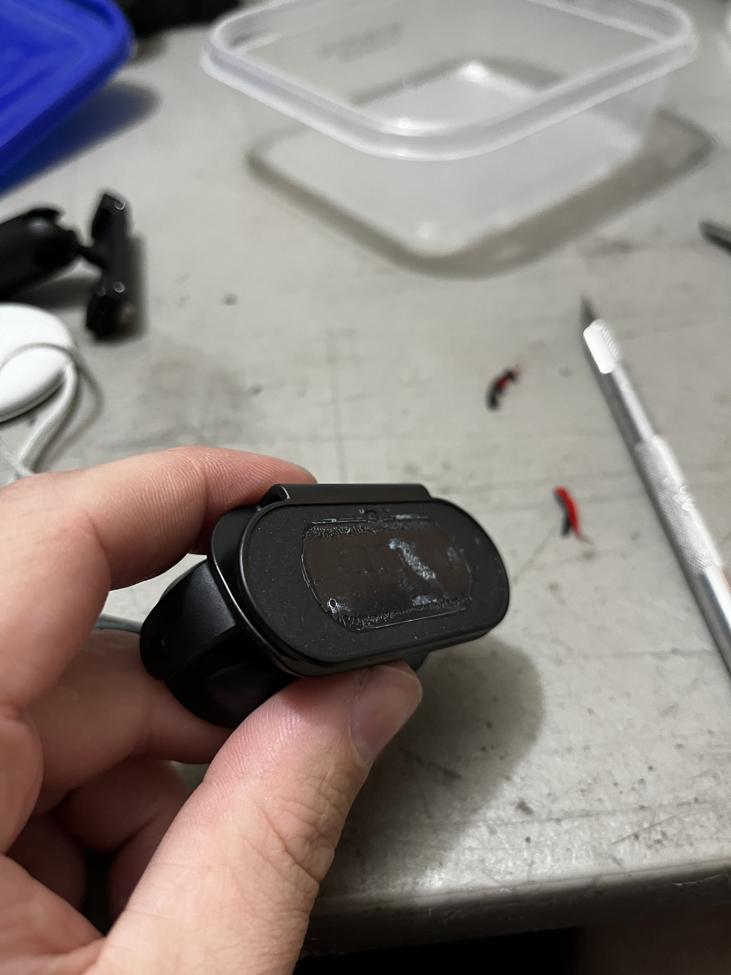

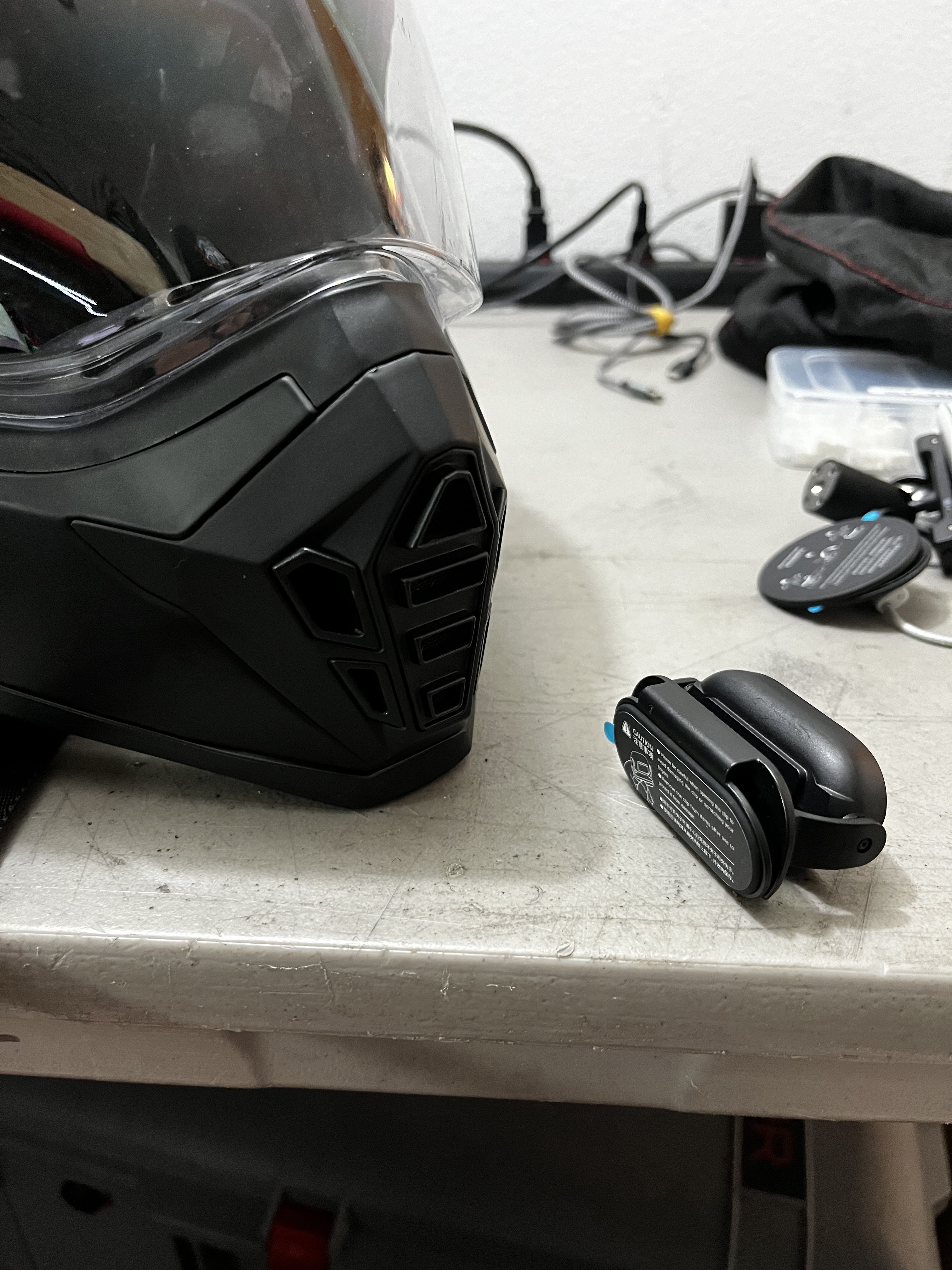

Wanting some of my own, I recently purchased a Insta360 Go3s from a sketchy marketplace deal.
Unfortunately, My helmet doesn’t make mounting it easy. There’s no nice, flat surface to mount it to.
Some creative use of wire snips and VHB later, this was solved.
Pulled the non-stick backing off the Insta360 mount,
And we’ve got a mount that Louie approves of
Man, I love VHB

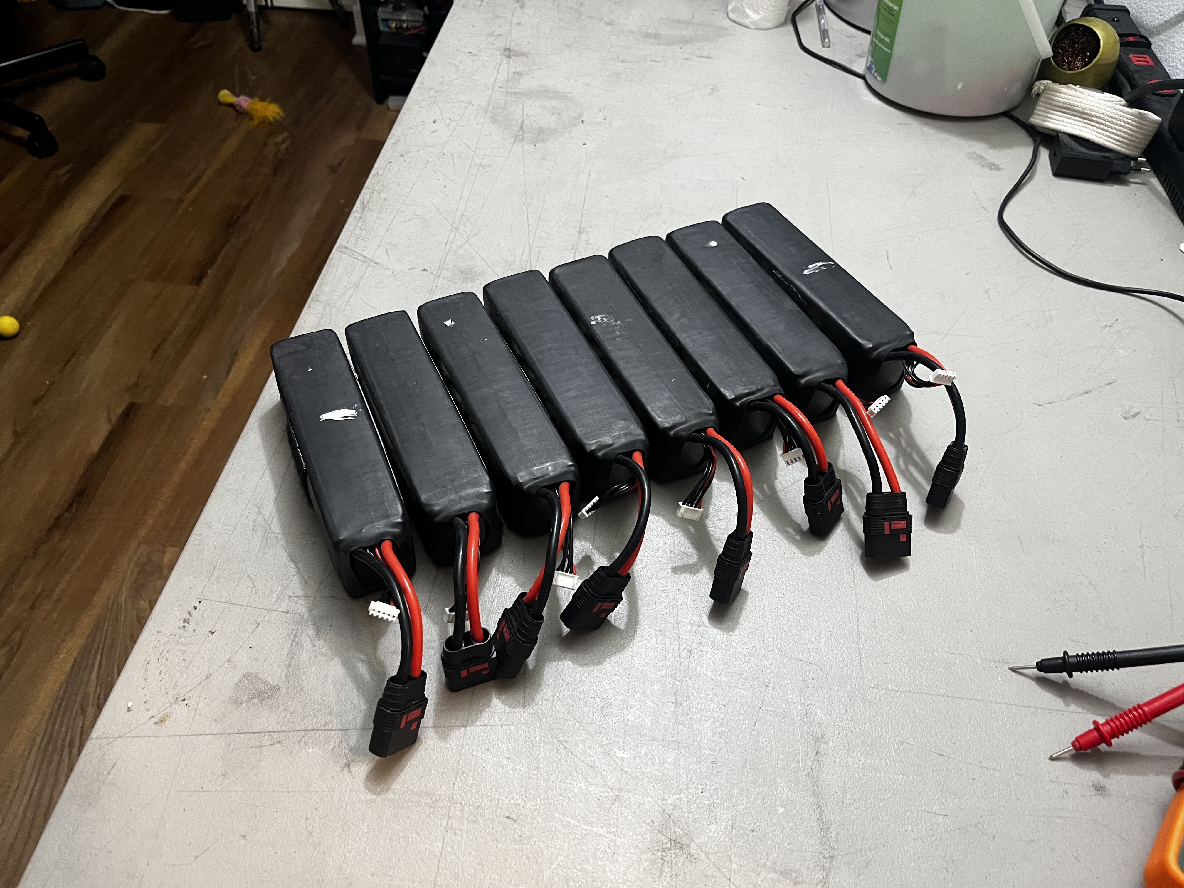

Packing For Prague (Batteries)

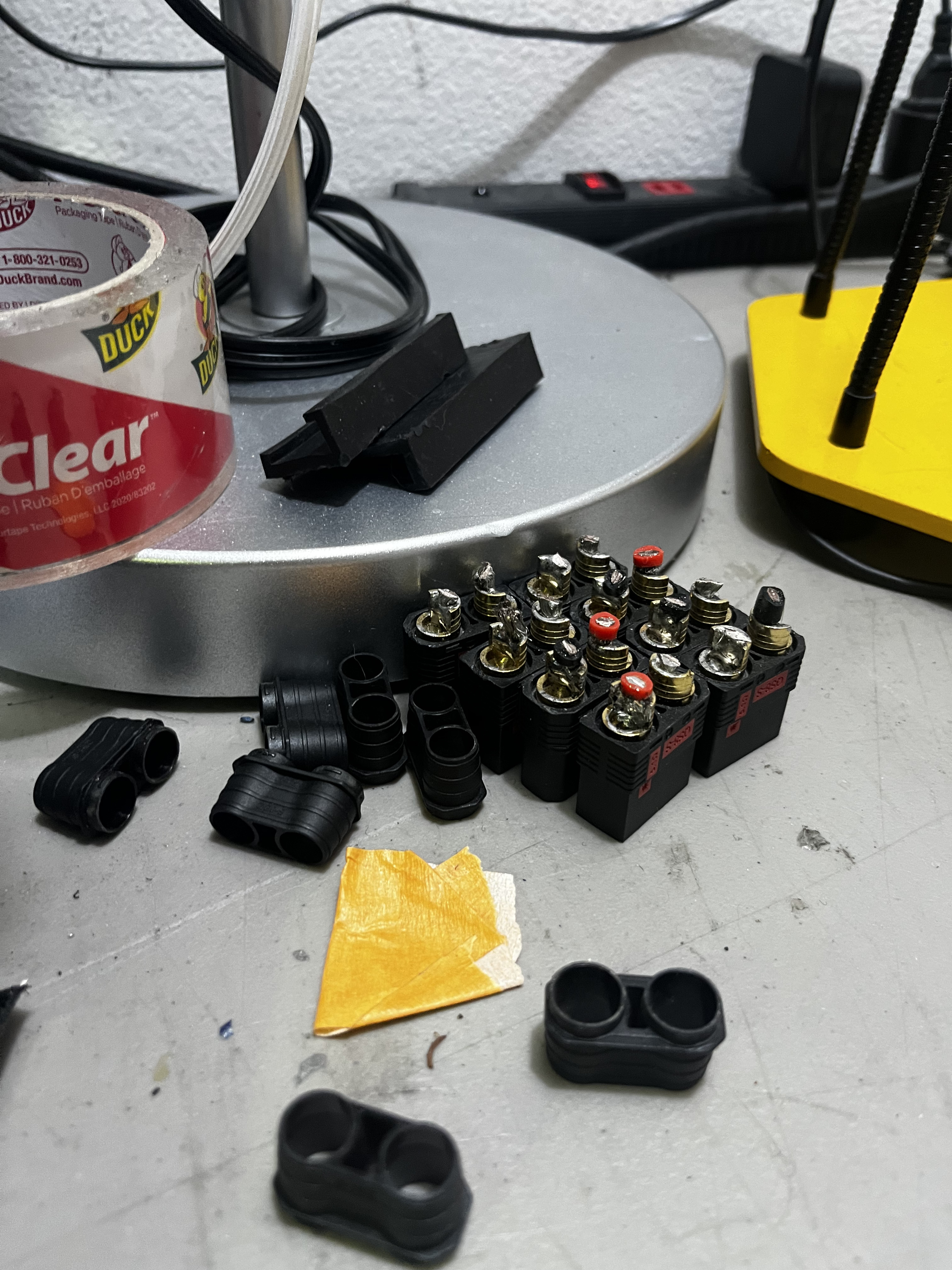

I shipped my batteries via fedex.
For the batteries, I made a box for them with foam on all sides, reusing the foam that my EUC came packaged in. Can’t be too cautious!

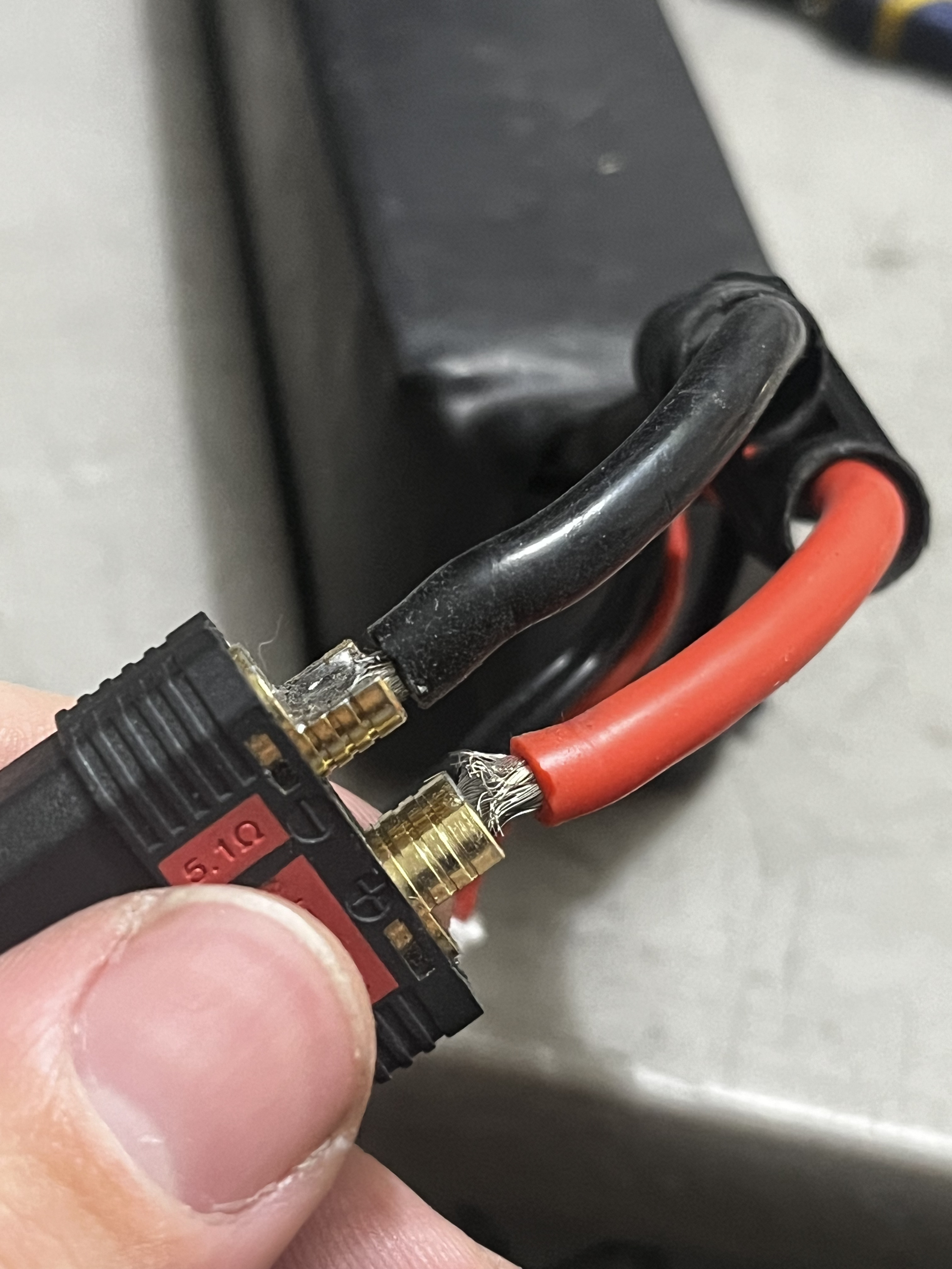

All connectors got Kapton tape. Also threw in this temperature logger (more on that later)

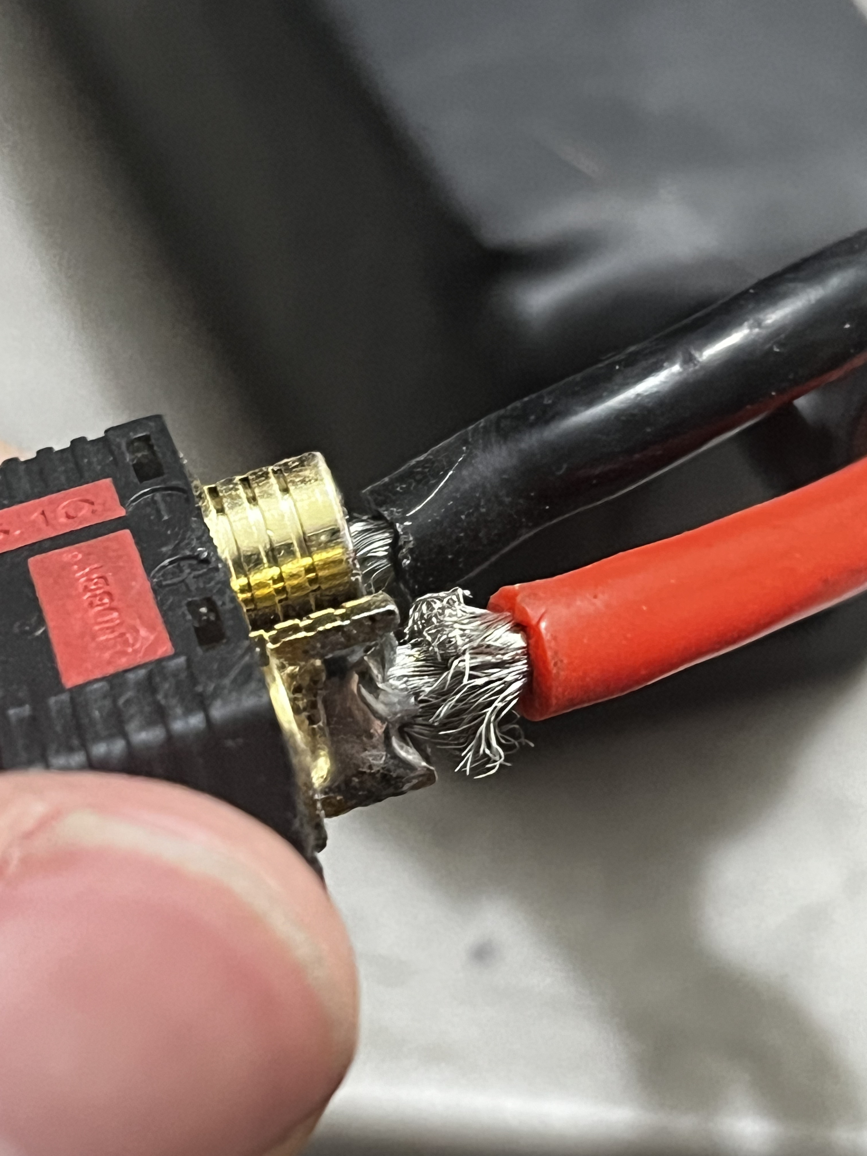

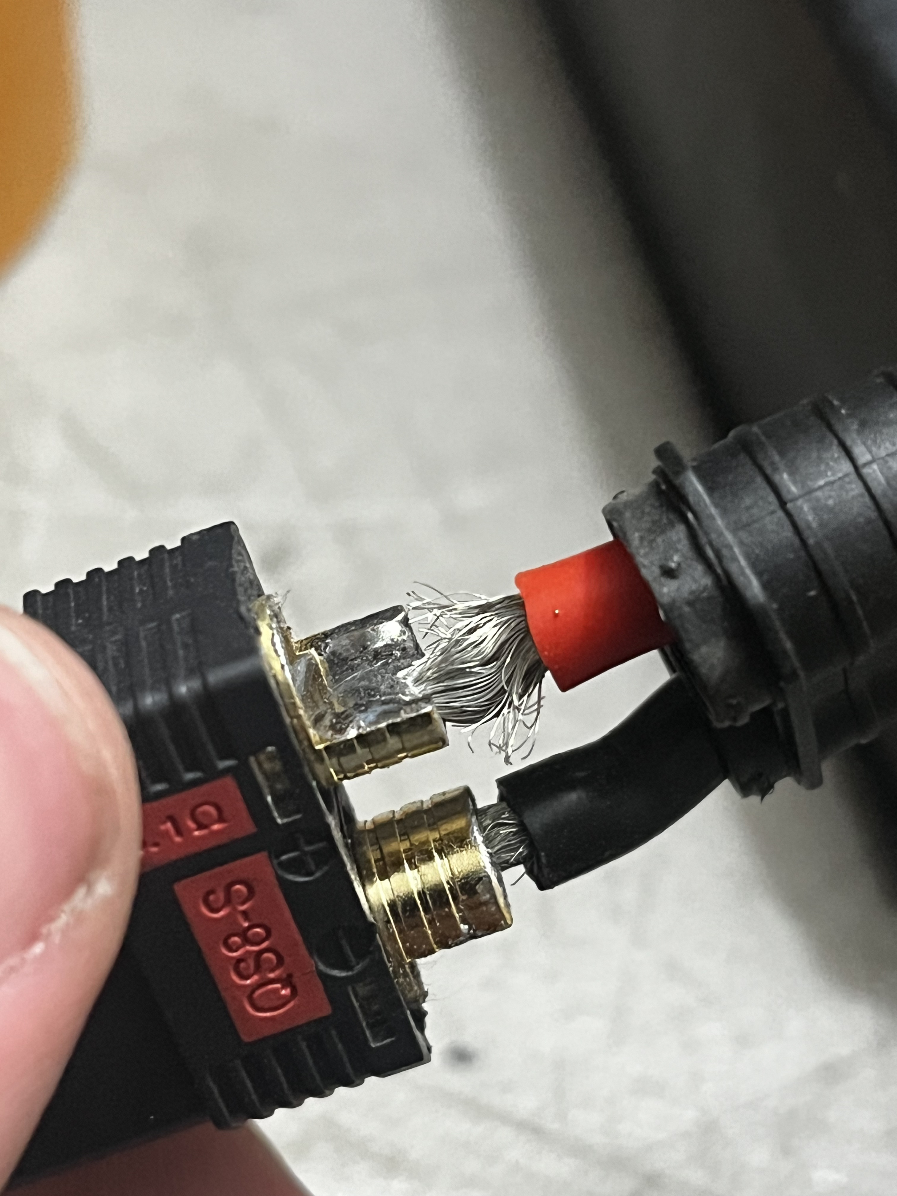

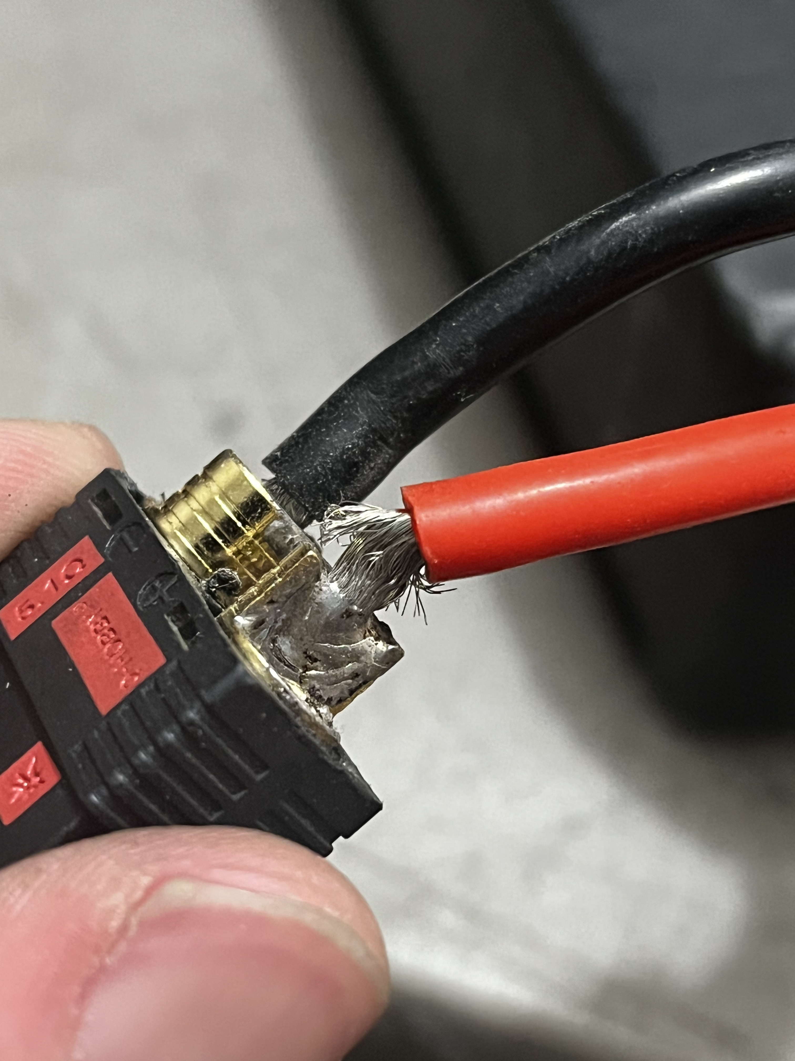

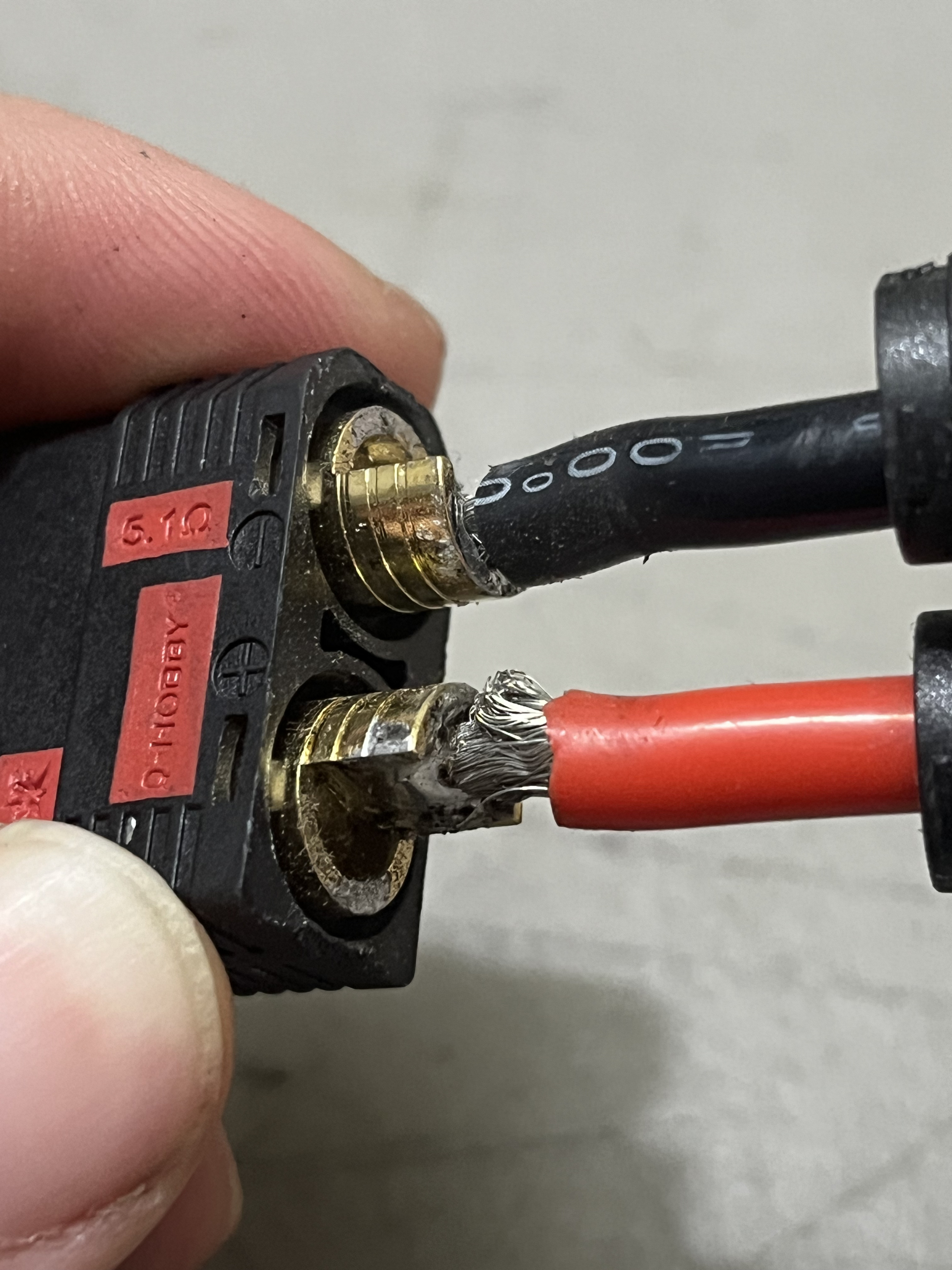

While doing this I notice that the insulation on my BMS connector had started peeling back. Not great
Cut and re-terminated them :slight_smile:

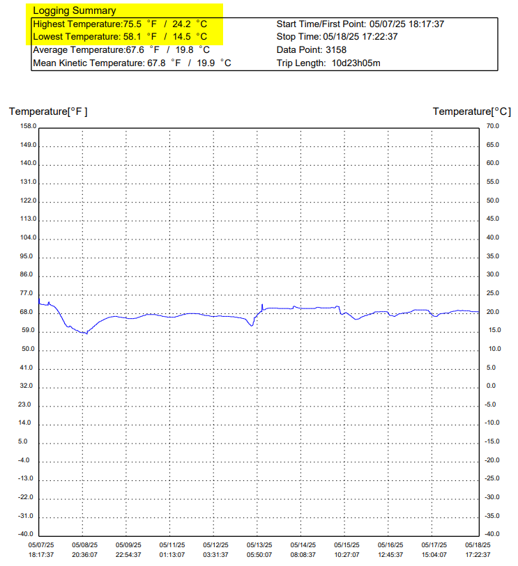

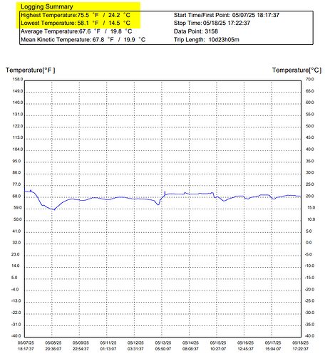

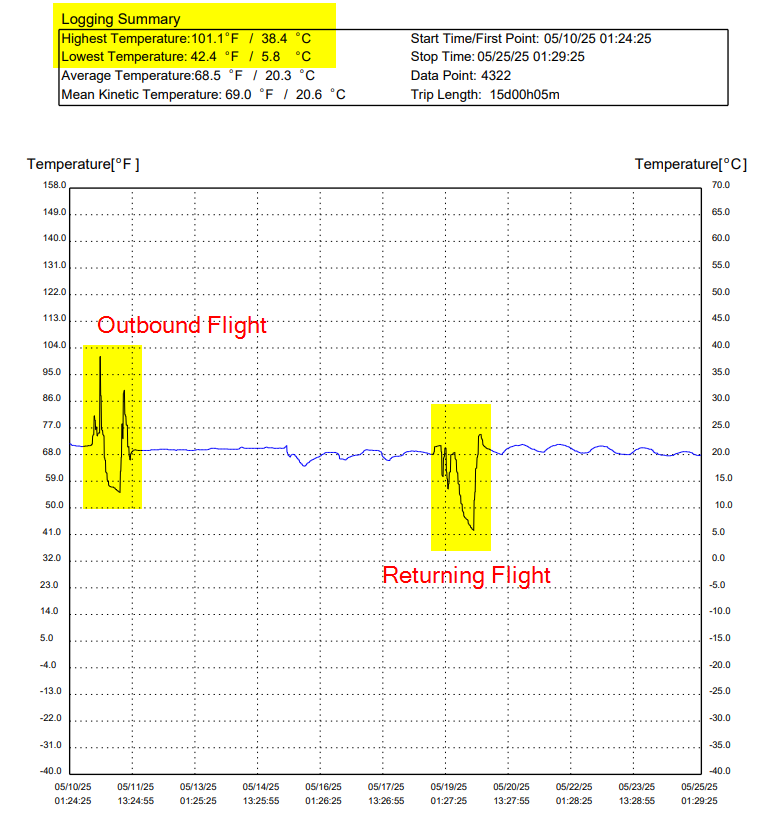

Cool Temperature Data
I mentioned that I put a temperature sensor in my battery box. I also put one into my pelican case! I was curious what temperatures I’d be subjecting my board equipment to.
These are neat one-button modules that record continuously, and can be plugged directly into a computer to get the data it records. Shows up as a flashdrive with a csv file.
But surprisingly, my board didn’t get as cold as I was expecting. When I picked up my board from baggage claim, it was still cold.
Definitely a temperature swing, but nothing that it wouldn’t experience on a cold/hot day of racing!
Interestingly, the fedex batteries never went much beyond room temperature
Cool to have data showing this isn’t something I need to worry about :smiley:
Raw data for completeness/archive
BoardRaw.csv (127.3 KB)
BoardReport.pdf (32.0 KB)
BatteriesRaw.csv (93.2 KB)
BatteriesReport.pdf (23.7 KB)
So, it’s two weeks later and my board still isn’t put back together.
Batteries
Because of my short packing time to catch my returning flight and my neglect to pre-print a return label, I opted to leave my batteries in Europe with Bence. Might keep em out there for any future Racing, or might try to sell them at a discount(anyone interested?), TBD.
I’ve been holding on to @HAIRYMANJACK 's old SMC packs for a couple months now(They were for Super Duality).
Quincidentally, they are the same ones and quantity that I run in Ankle Wreacher.
I bought them off him to put into Ankle Wreacher. They’ll be the batteries for this board for the foreseeable future. Does mean I’m back up to 16s :sunglasses: (Not that that changes anything)
Step 1 was to replace the QS8’s with AS150s.
SMC Quality
Taking them apart, I was shocked by the quality of some of the solder joints in here. Apparently these were soldered by SMC. Interestingly, only the positive wires were questionable, all the negatives were fine.
Something to be aware of, I guess.
One podcast later…
G300
Reassembling the rear truck, I ran into exactly the same issue with the bullet connector becoming detached from the PCB. :cry:
I tried giving it the same reflow treatment, but it didn’t hold :cry:
I’ve sent a message to @YUTW123 to see if I can get a replacement part, but I need the board working in 5 days for the Legend Race… So I’m probably going just just need to try again.
Until then, the board continues to sit across my coffee table.
Definitely gonna wanna add a intermediary connection for those going forward. Seems like the g300 wasn’t designed for those connections to be cycled often
