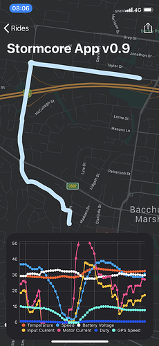

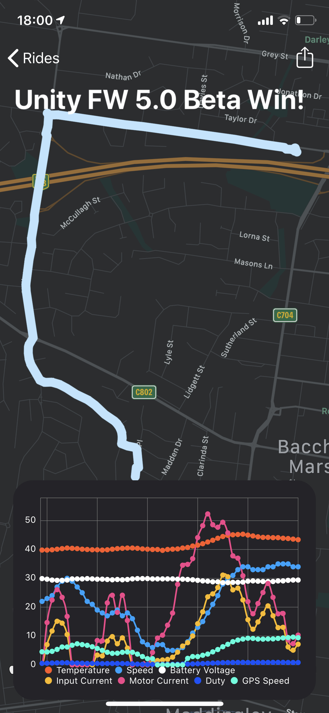

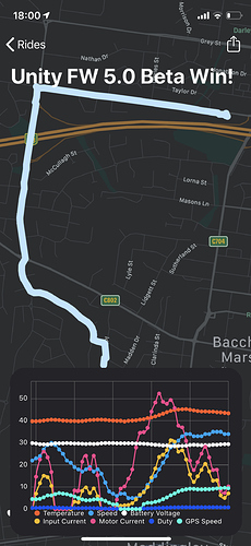

Put the phone in my backpack, so nothing obstructing signal. Full logging on Unity running FW 5.0 and metr Pro module renamed as UNITY BLE!
Glad it’s working! Putting up a new build in a couple days

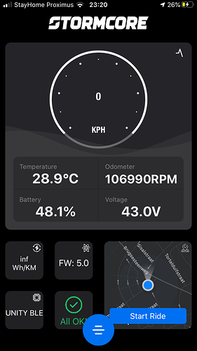

My RPM is probably not correct :sweat_smile:
Yes, it’s a temporary thing I put in there, it’s actually “engine ticks”, not rpm. I’m waiting on fw implementation before that field will have correct units and values

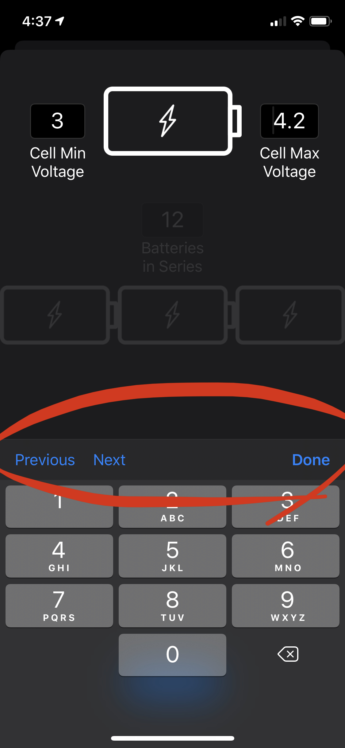

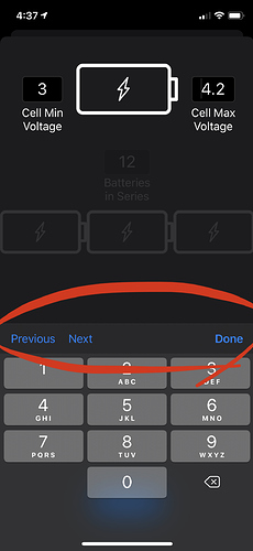

  • Improve battery configuration view
  • Add input field navigation controls

What’s this about?
When I saw the battery graphic and I changed my series setting, I thought it was going to fill the rest of the screen with 12 different little battery icons haha.
hah the rest of the view is reserved for more stuff coming soon, so it’ll look less weird after that
