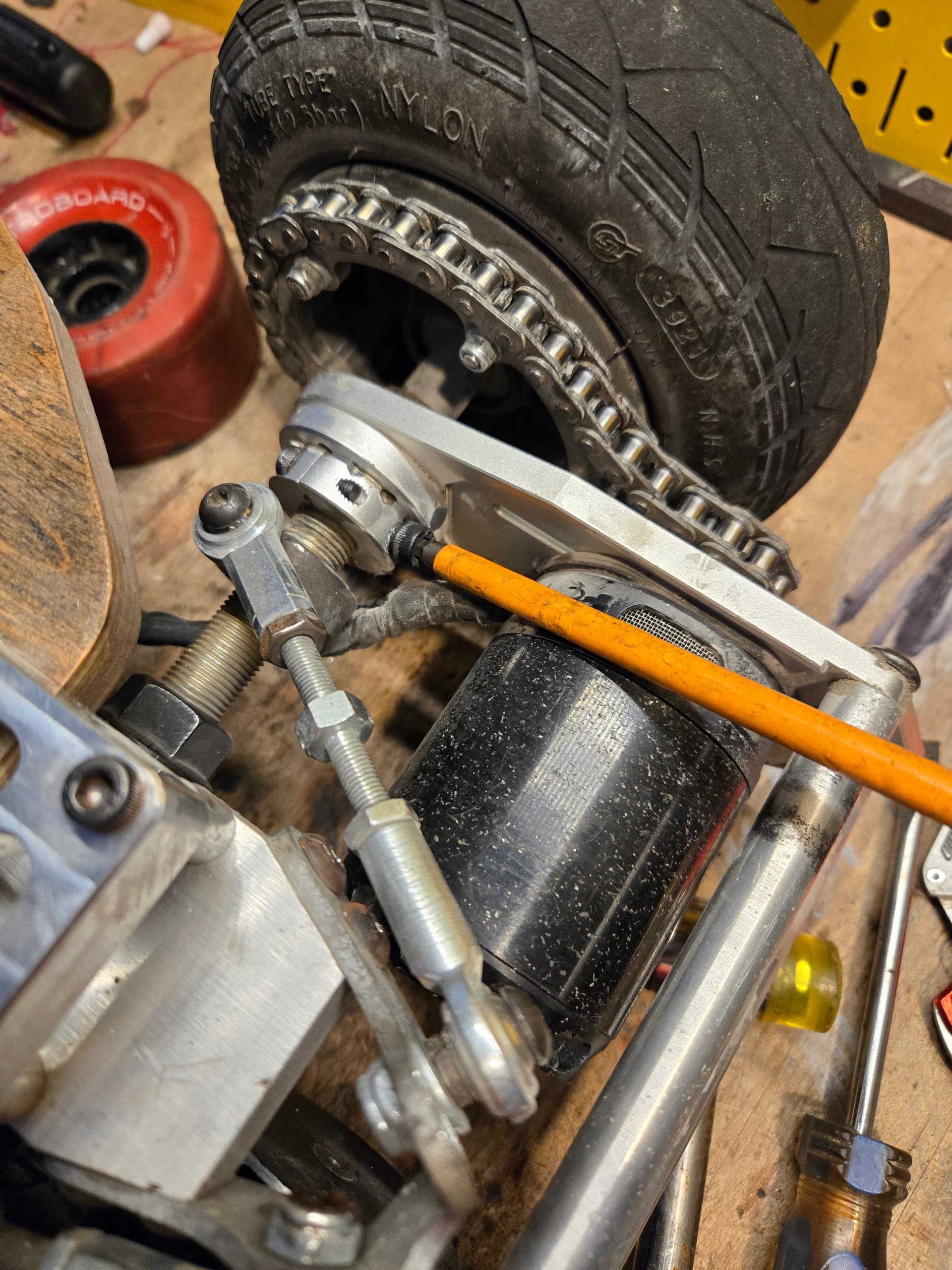

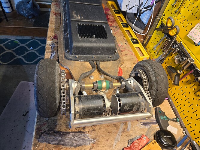

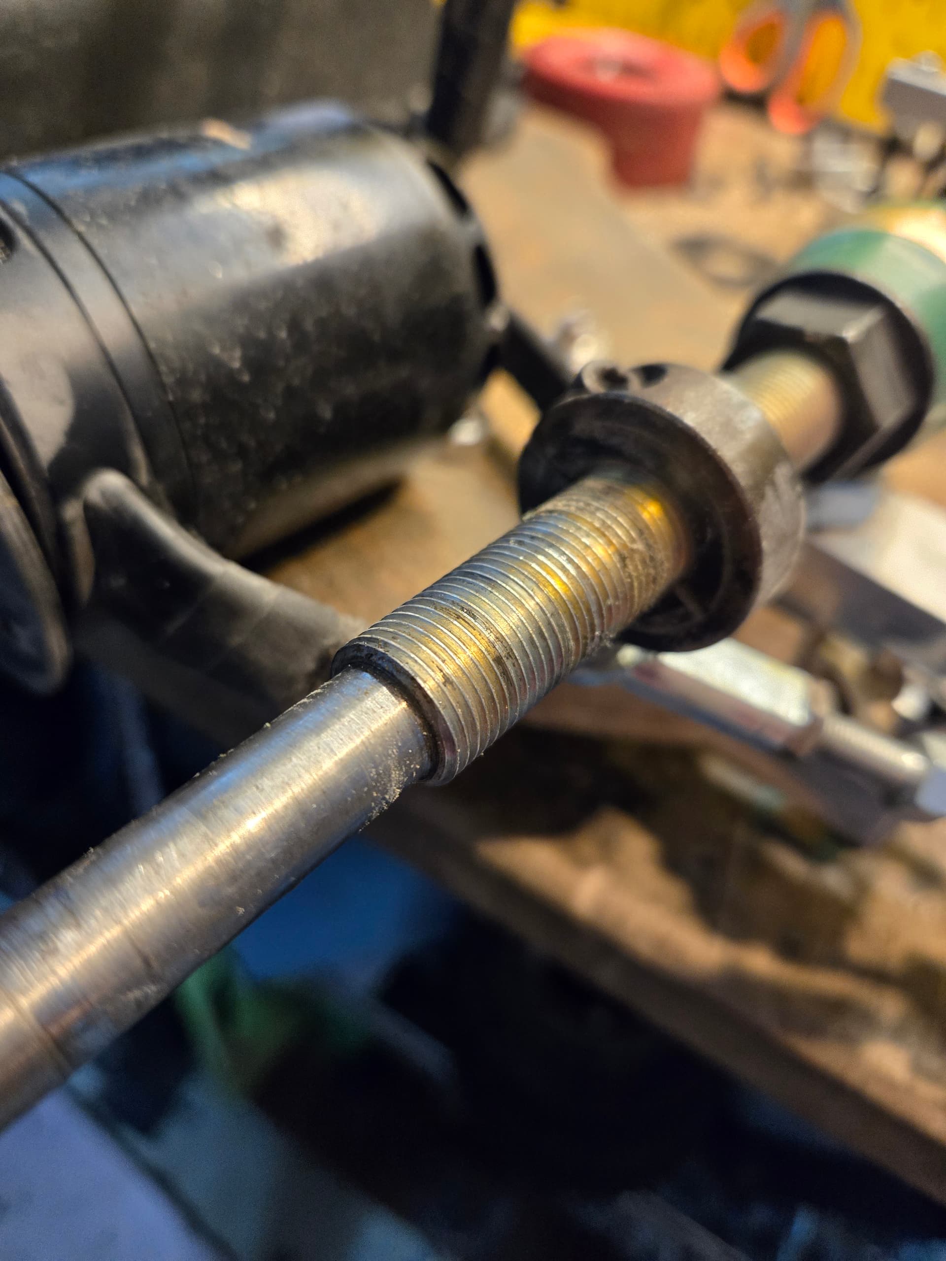

Got the new mounts.
They are nice

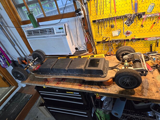

Managed to do a 23 miles rode yesterday.
They shifted down about 10mm.
Got them back on the bench this morning to move them back up.
And I stripped the hole for the set screw.
I am pretty good at breaking stuff, but these seem like especially soft aluminum.
I am not sure if I’ll try to re tap these, or if I’ll try to go back to the old ones…
I love these trucks.
But sometimes feels like the universe doesn’t want me riding them…

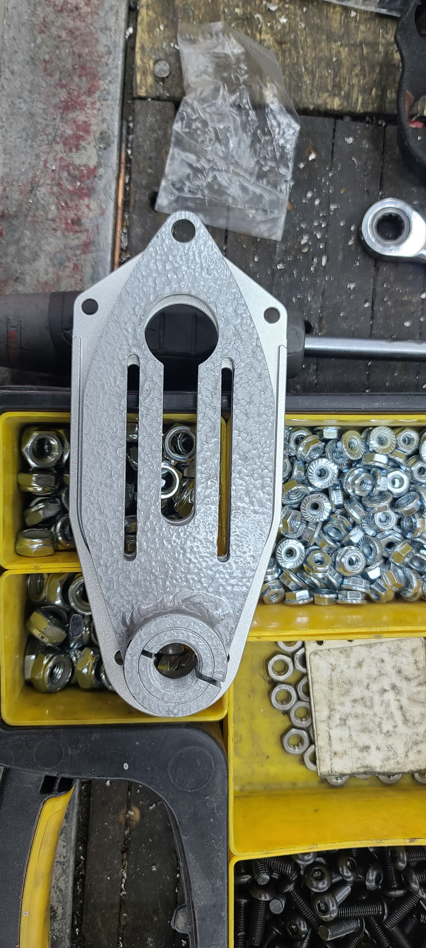

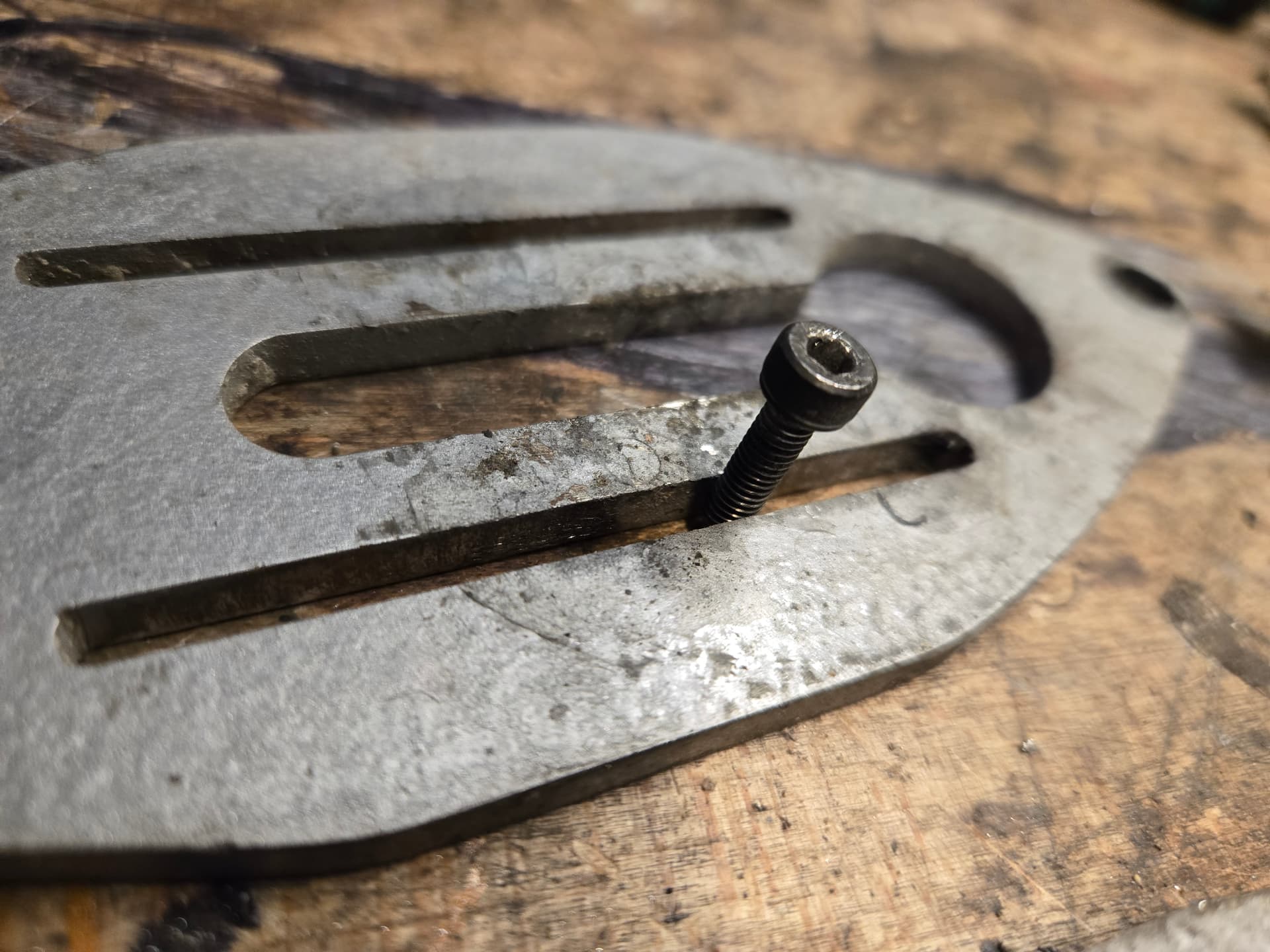

What would you guys suggest I use to grind the motor bolt slot on the old mounts?
I am not sure if all of them are made like this or if mine were built wrong.
But my biggest beef with them is the spot does not allow the M4 bolts to slide through.
So I could not move the motors up and down freely.
Once I found a motor spot I kinda had to thread the bolt in.
It has been a nightmare for me.
That is why I bought the new mounts immediately.
Since that is not going to work for me.

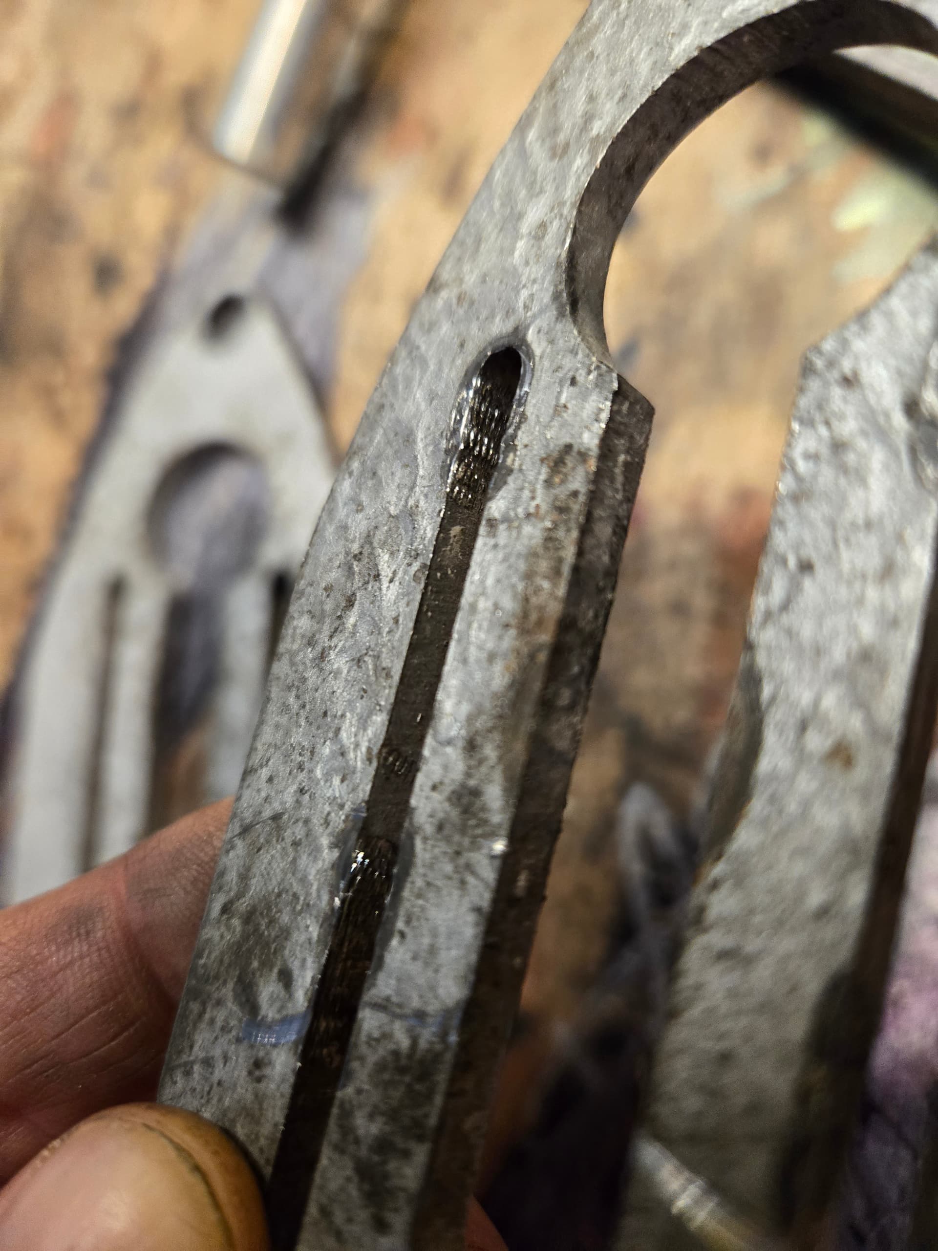

I am going back to the old mounts, but I need to open up the hole.
And there is nothing soft about the old mounts… So I am having a hard time taking material away…
Looks like a Dremel and patience may work…
What size is the thread on this portion?
I am hoping to run to the hardware store and get a couple of jam nuts to help keep the mount in place like shown here…
