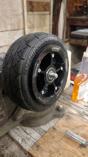

Did those wheels look a little different than the normal race wheels?
Widened 150mm Metroboard wheels.
We raced these at SOS #5 and Barrett.
Using any specific PSI?
with a 3d spacer?

Under 40psi. Dial the pressure to what the track likes.

Wheels 120mm SRB street and 155mm Modified Metroboard
