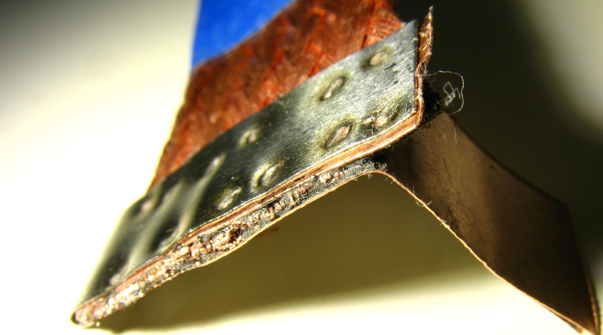

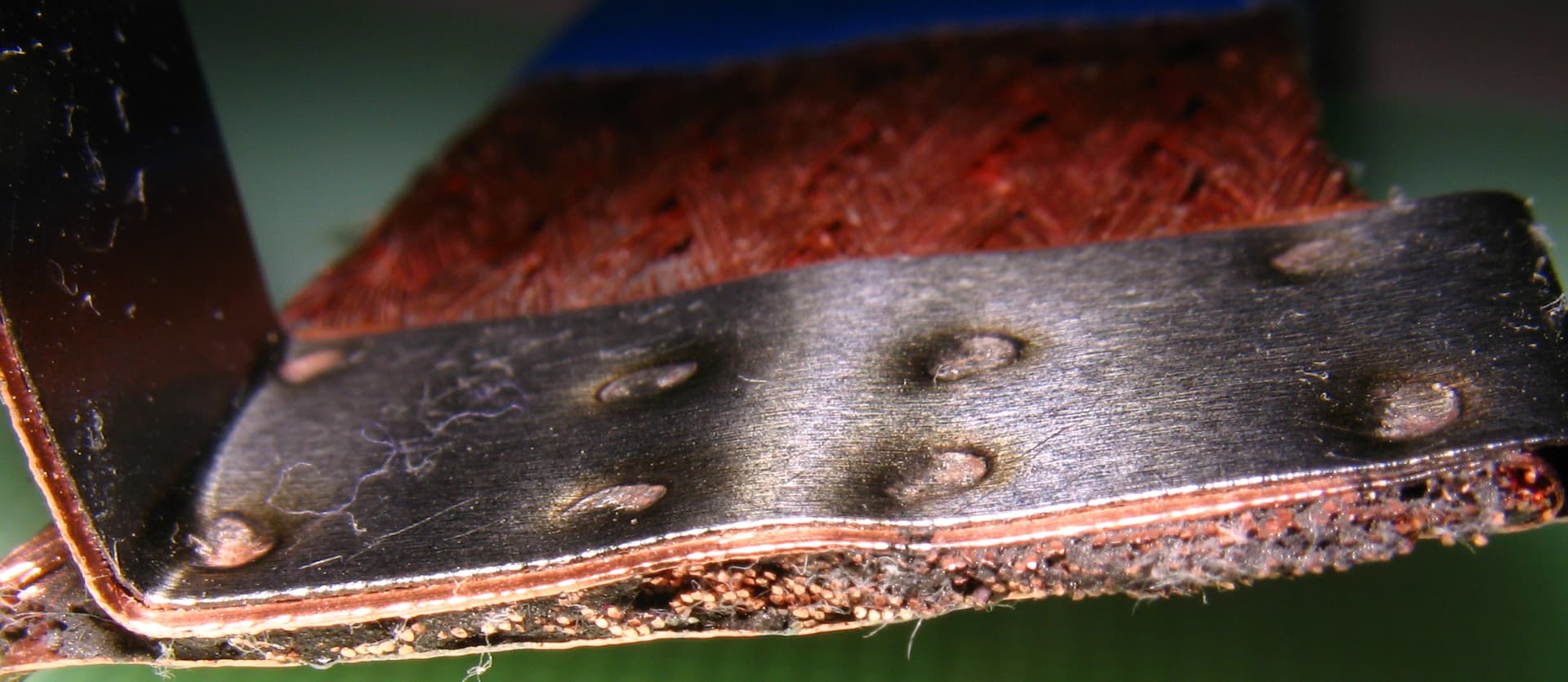

This 15mm wide / 1.5mm thick copper braid was compressed in my hydraulic crimper with its smallest Dies, for the biggest area of flat spots on either side of the hex.
I then sandwiched 0.1mm copper on either side, and a layer of 0.1mm Stainless steel on top of that, with flux between braid and first layer of copper.
These are ALL side by side welds, not opposition welds.
Gear 550, single pulse, 0.10ms preheating, pushing down on electrodes very hard.
There is basically no removing the copper sandwich from the copper braid, and this amount of welds is likely excessive.
I can’t peel it apart.
The braid remains flexible right up to the edge of the sandwich.
This only my second attempt experimenting with welding the braid.
I have not yet made an attempt to solder braid.
I think welding copper to copper opens up a whole lot of assembly possibilities.

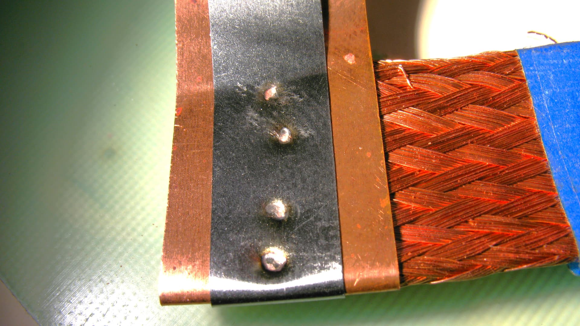

This was without any hydraulic crimper compression done before welding.
0.15ms preheat, double pulse 02ms interval, with a lesser amount of flux only in the middle.
The two sides of the flattened copper braided sleeve are able to be pulled apart, but the welded strips themselves are NOT coming free of the copper braid itself, not without ridiculous effort.
I did not push down with the electrodes as firmly either.
There are no opposition welds, with probes on either side of the strip.
I think even with fewer welds, that the amount of surface area between copper strip and copper braid in direct contact between the welds is very large, and many more welds can be added, side by side, and opposition welds too.

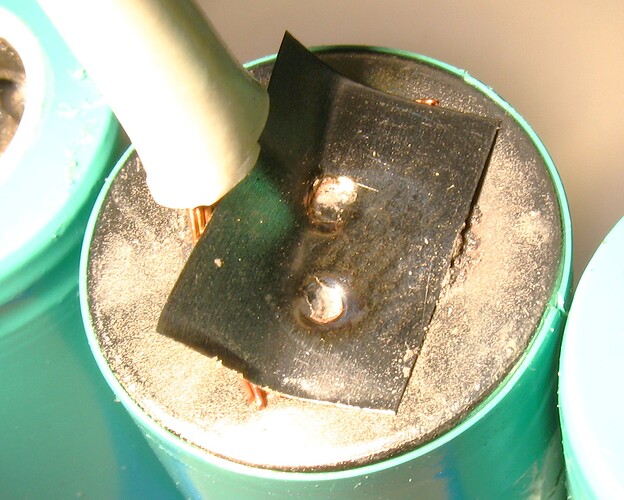

I flattened some oxidized impure dirty 12awg copper wire in my hydraulic crimper, put it on top of a Dab of flux on top of a dented Wintonic cell can, under some 0.1mm stainless steel, and hit it with a double pulse, gear 650.
Wrapped the wire around my hand and the cell in the other.
Super strong, basically have to rip the 0.1mm stainless steel, and it does not rip easily.

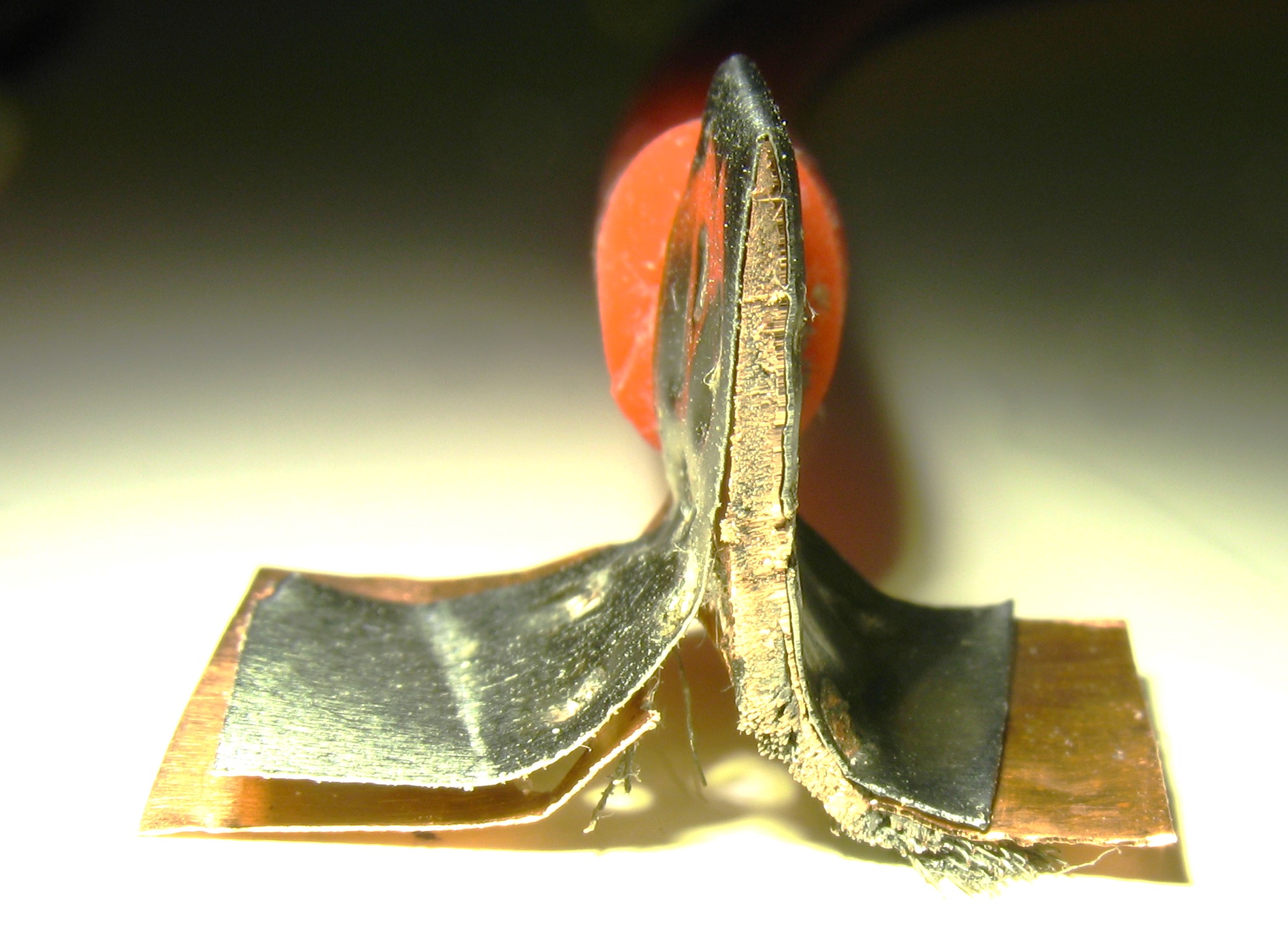

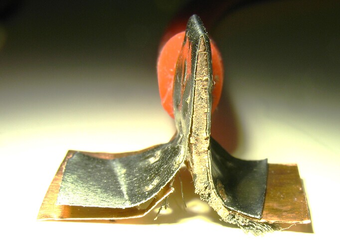

I Flattened some 10awg silicone wire in my hydraulic crimpers, sandwiched it in 0.1mm copper and 0.1mm stainless steel, with flux, and gave some parallel welds on each side.
Single pulse, gear 550, No preheating

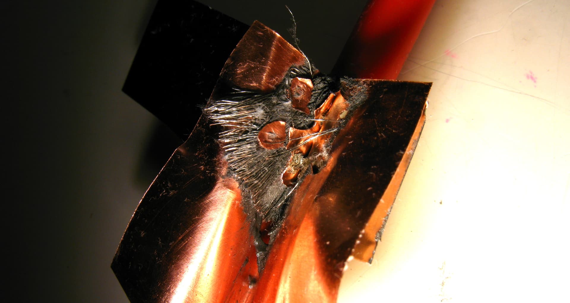

The sandwich was welded to the fine stranding, but not all the way through.
I closed it back up and did 2 opposition welds, and this does get all the way through.
Was able to peel the 10 awg apart, but the 0.1mm copper and 0.1mm ss was bonded well to each half
This is running my tin snips through some parallel welds.
I Did not nail the settings, or technique by any means.
The ‘flattened’ stranding is not really flat, it is tapered towards the edges still.
I dont know if the flux does anything.
The downward pressure on parallel welds, and clamping pressure on opposition welds plays a huge part.
Overall, It is totally possible to weld copper strip to silicone jacketed super fine stranded tinned wire.
Developing a technique to do a clean job repeatedly will take some trial and error.
Part of me feels like there is definitely merit to this approach and another part of me feels ‘eeewwww’
I personally like it very much and I will give it a try in future projects. I see so much use for this.
There is definitely some eeeeew factor when peeling apart the copper layers and seeing and smelling the fluxed stranding.
