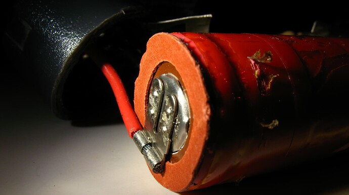

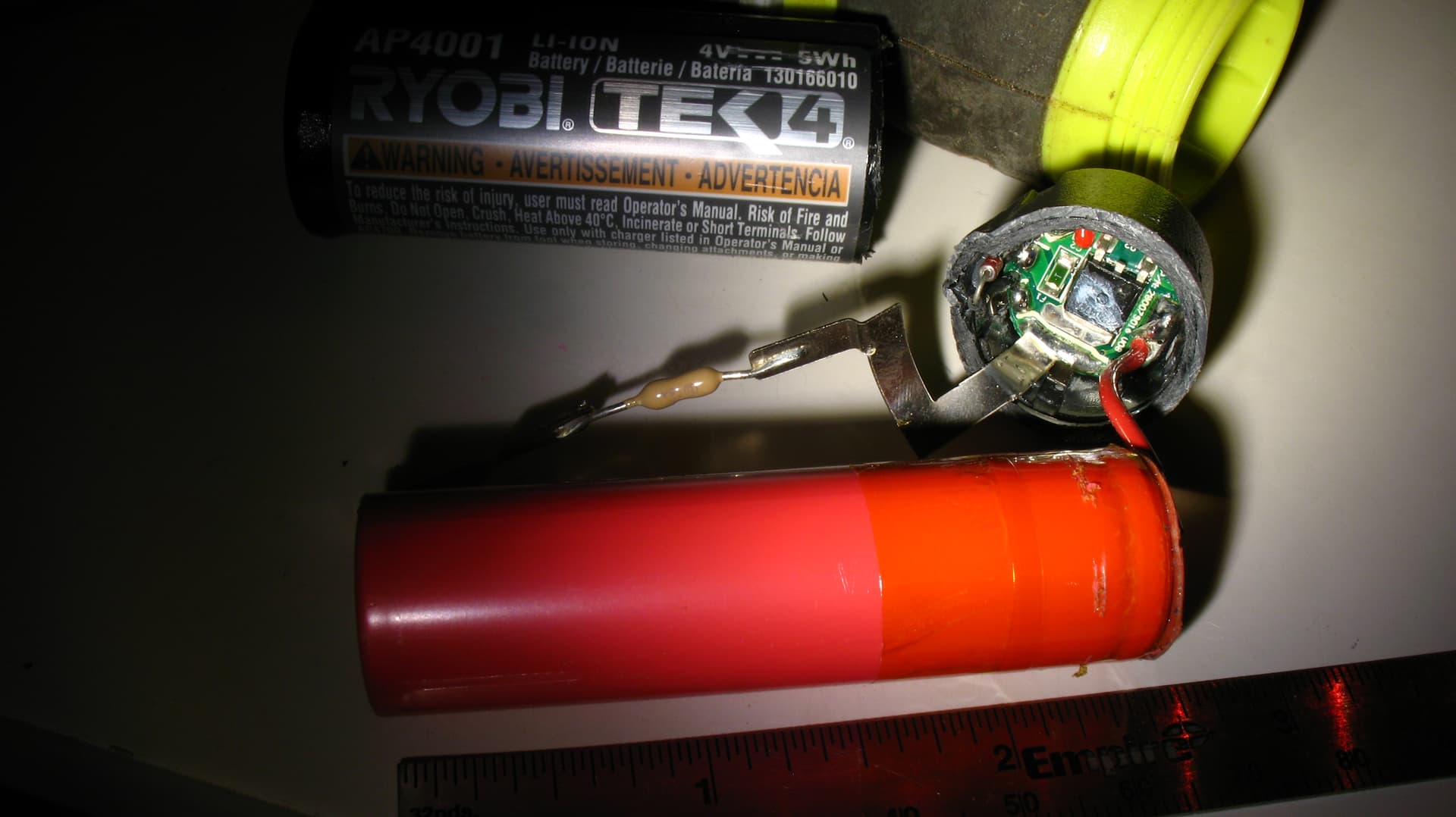

This here is a single 18650 cell Ryobi Screwdriver’s battery. I have no Idea when my Dad bought this tool. I have been using it for light stuff, but it is a pretty weak tool, and I don’t know how much of that is just old battery sag, vs weak tool.
I had to use a Japanese flush cut pull saw to open it up carefully.
It is a 10 amp CDR, 1200mah Sanyo cell.
UR18650SA R2111

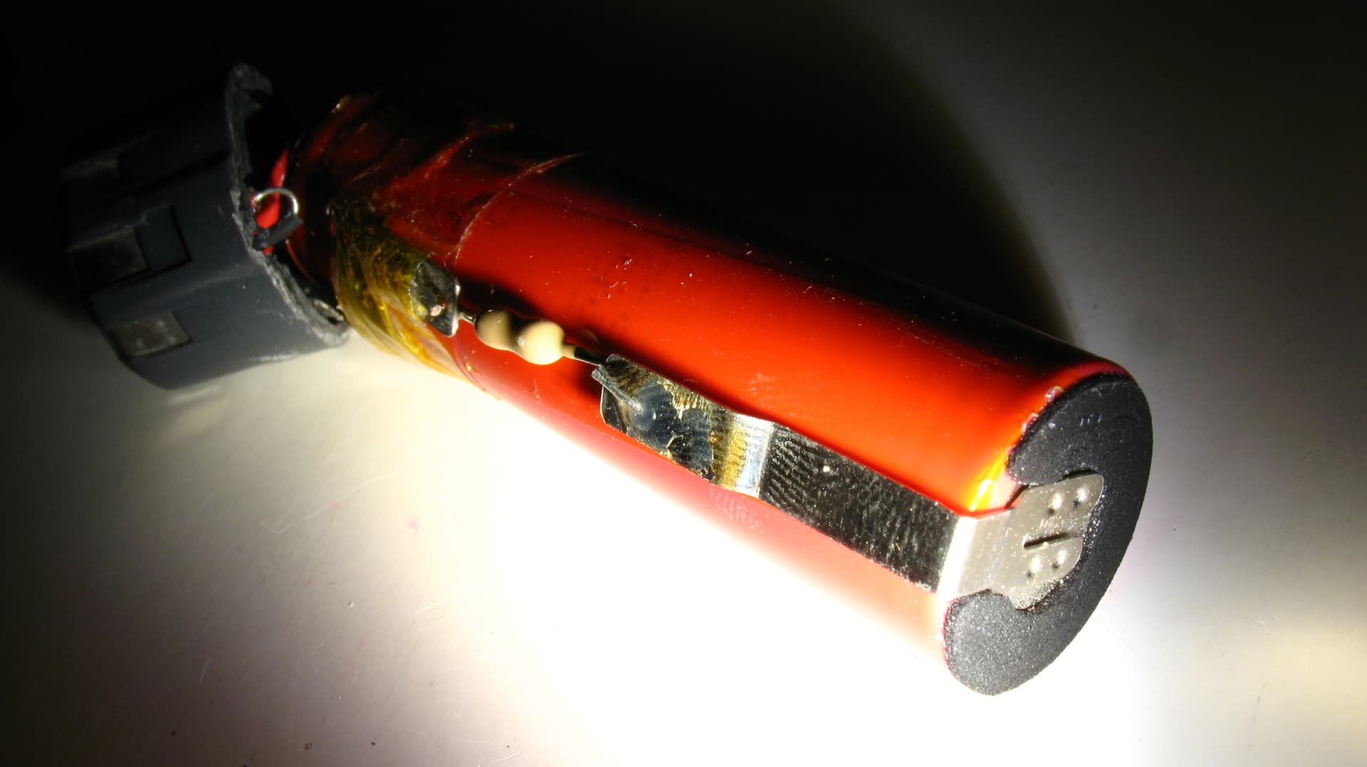

Appears to be a 15 amp fuse between the 0.3mm tab on Anode and Upto the PCB.
I thought the spot welded tab to crimped stranded wire connection to be interesting. Think it is Nickel plated steel, 0.3mm, as it seems more magnetic than pure nickel. I don’t see pure nickel crimping very well, but honestly don’t know, yet. The fishpaper ring is very thick.

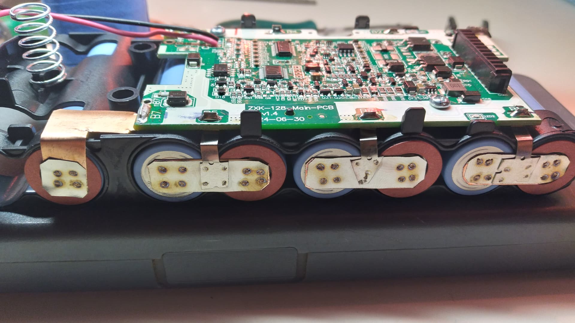

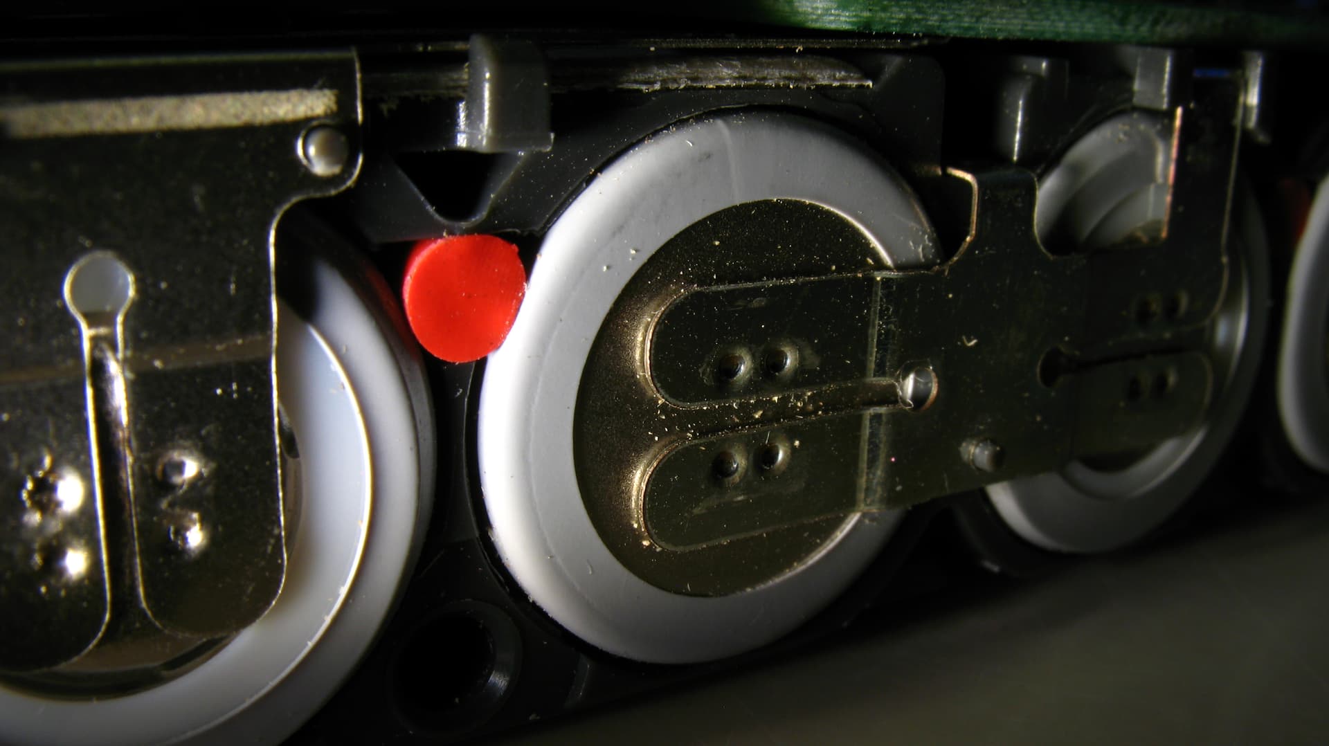

My 2021 era Ridgid 5s1p 2.0AH battery looks to be welded with same welder, and only the 4 spot welds/ dots make contact with the cell . The rest of the tab is elevated above, nearly perfectly evenly, with a 0.15mm gap.
Wondering how Overkill a JP30 will be for this tool. Even If it cannot take advantage of the low voltage drop, an old 1200 mag cell vs a tabless 3000Mah should be a no brainer, but not if the magic smoke is released as it was never designed for such a beast of a cell that laughs at a 10 amp load.
Wonder if that 15 amp fuse and the rest of the PCB, would still be adequate with a monster beast JP 30 in there, and if the JP 30 should be better saved for another device that can utilize its impressive capabilities.
I have less capable new and newish cells I could use instead.
