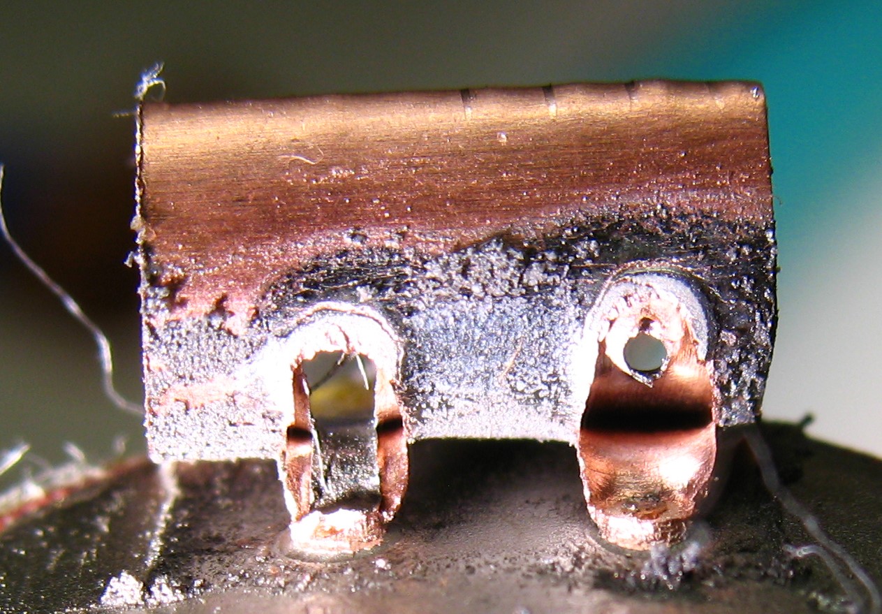

Here is the same sandwich, 0.2mm copper under 0.1mm stainless steel, gear 450, but using flux.
This is on an old Sanyo 18650, not the Samsung 50E as used in post 164, but basically 45% of the welder’s power with the flux, vs 55% without, and I believe gear 450 with flux is excessive.
The weld seems a bit excessive. I rolled the strips off, but it still deformed the can, especially the weld on the right.
I’m gonna try again using flux, and less power.

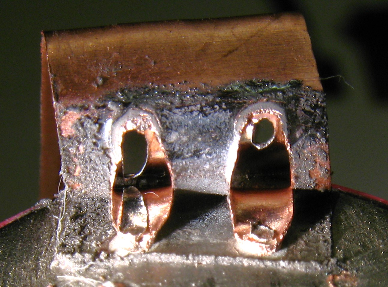

This is 0.2mm copper under 0.1mm stainless steel
Gear 385, with flux. No preheating, no second pulse.
The weld on the right is good, the weld on the left tore the SS and the CU, but is too weak, in my opinion.
I have noticed when the welder’s power level is not quite enough, that one of the welds is good, the other is not, and is why I do not do multiple test welds with the same settings on same strip, as then when tearing it off, additional welds might have one think the settings were high enough, when they were not, or if at, or very near the max power of the welder, that it is strong enough, when it is not.
I Did these without preheating or a second pulse to perhaps be more representative of a welder without such features. Gear 385 with flux is too weak in my opinion, gear 450 with flux is excessive, in my opinion.

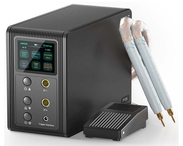

If the gear strength is linear, and my P20B AWithZ welder at 14.6kw
38.5% of 14.6kW is 5.621kW, and not quite strong enough, IMO.
45% of 14.6kW, is 6.57kw
55% of 14.6kW is 8.03kw
So Hummie’s welder, rated at at 10kW max power, should have power to spare in welding 0.2mm copper under 0.1mm stainless with or without flux.
Very interested to see if it can.

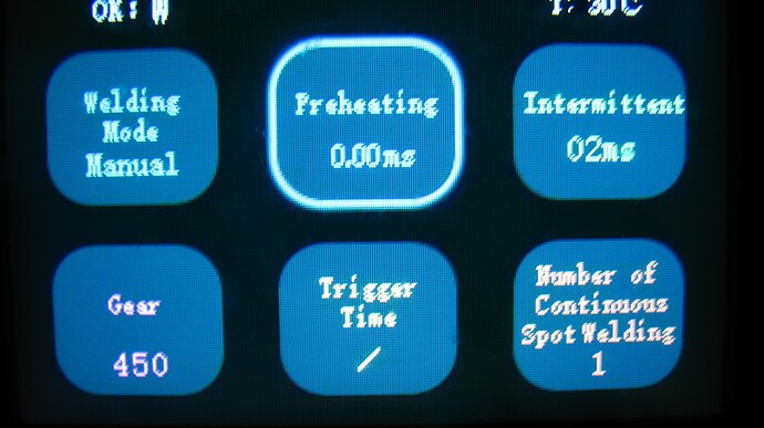

I have to admit to some errors in the function of this welder.
On the main screen there is the ‘intermittent’ and generally I have been using 02ms, and this bothered me, as I assumed it was the interval between the pulses, but 2ms should basically feel like one pulse, and there is definitely two obvious pulses.
On the System Settings menu, there is an “interval Time of Continuous Spot Welding’, and one can choose 0.1 second, all the way upto 2 seconds.
Default is 0.1 seconds, and switching it to 0.2 seconds is very noticeable.
So I believe the ‘Intermittent 02ms’, on the main screen, is the interval between the preheating and the First pulse.
So experimenting and fine tuning with the actual interval between pulses is something I have not yet done. Every double or triple pulse weld I have done in every test in this thread, has been a 0.1 second interval.
I have not really played with the preheating duration, or with the ‘ intermittent’ MS either.

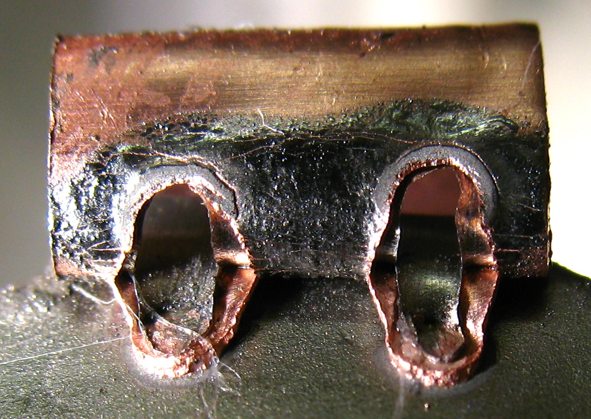

Seems we should use as little power as possible that still welds the chosen material and its thickness adequately.
The flux definitely reduces the power required to weld 0.2mm copper under 0.1mm stainless.

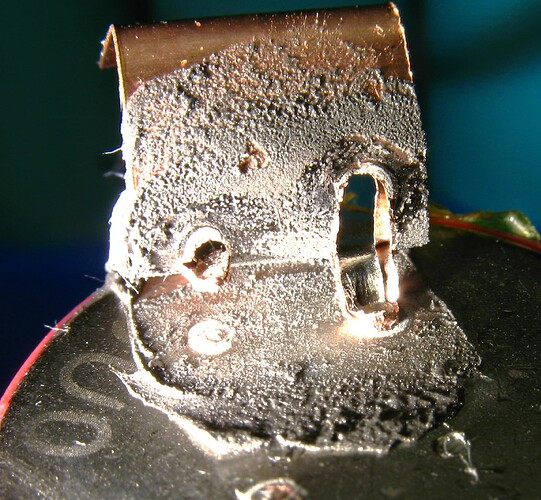

This is 0.2mm copper under 0.1mm stainless steel.
Gear 385, 0.10ms preheating, single pulse ‘02ms intermittent’, which again I now believe is the interval between the preheating pulse and the actual pulse.
In my opinion the 0.10ms preheating added before gear 385 makes for a good solid weld.
Both Spots are nearly equal.
I guess I should see how low of a gear I can use to weld 0.2mm copper under 0.1mm stainless, with flux.

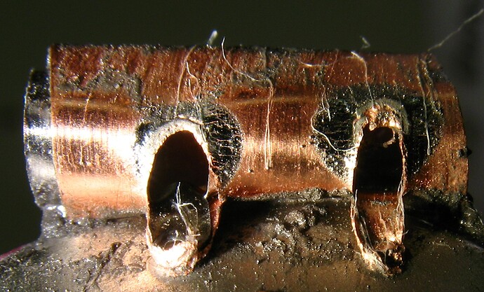

0.2mm copper under 0.1mm stainless with flux
Gear 355
Preheating 0.20ms
Single pulse
Not peeling this off without plyers.
I’ve never worked with 0.2mm pure nickel, but removing this sandwich takes some serious effort.

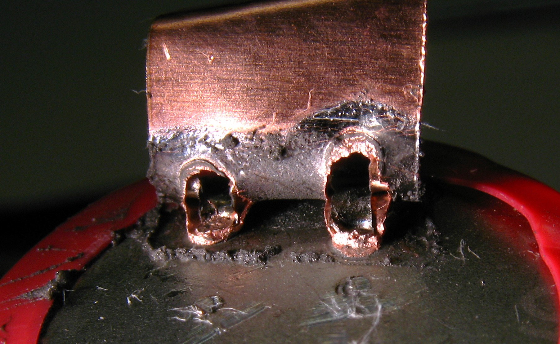

Gear 305
Preheating 0.20ms
intermittent 2ms
double pulse
Interval time of continuous spotweld 0.1s
This weld required more force to remove than in the post above.
