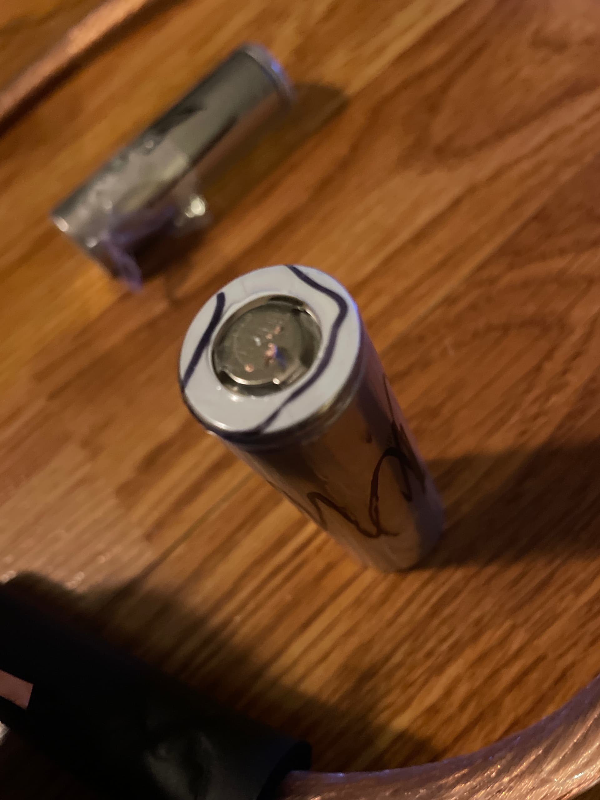

Ok, frustrated. On these cells dremelled free of previous test welds, I cannot see ANY difference, changing the preheating, or the interval, or the intermittent.
The only thing making a difference is the gear setting. I am achieving solid welds with gear 320, but changing other settings and trying to determine the effect, positive or negative, I am not seeing enough difference to conclude anything.
My last weld was gear 320, 0.4ms preheating 02ms intermittent , and 0.5seconds interval between weld pulses. It looks and felt so similar peeling off to every other gear 320 weld that I am giving up for the night.
last nights test welds were on basically virgin nickel plated steel can, a slightly different portion of it and I felt i was making some headway.
Tonight, on a dremelled cell, I learned nothing changing the settings( other than gear) up or down.
But achieving solid welds with 0.2mm copper under 0.1mm stainless steel with flux is somewhere between gear 285 and 320. So somewhere about 32% of the welder’s capability or less, where tests with without flux required ~55% of this welder’s power, and those strips might have been less pure or slightly thicker 0.2mm copper.
I upped the preheating to .30ms, all other settings the same, and the weld was weaker, one spot fine and dandy, the other just not nearly strong enough. Lesser radius of tinned copper visible.
Is this a slightly different purity of copper, or slightly thicker than yesterdays?
IDK. The first weld in the last 22 hours? Room temperature is within 0.5C of last night. Welder says 26C.
used positive tab of sanyo cell. Same everything but put interval back to 0.1 second between weld pulses and 02MS intermittent
Weld is very solid, difficult to remove. Rolling the weld off on needle nose turned the tab convex.
I am done with this cell

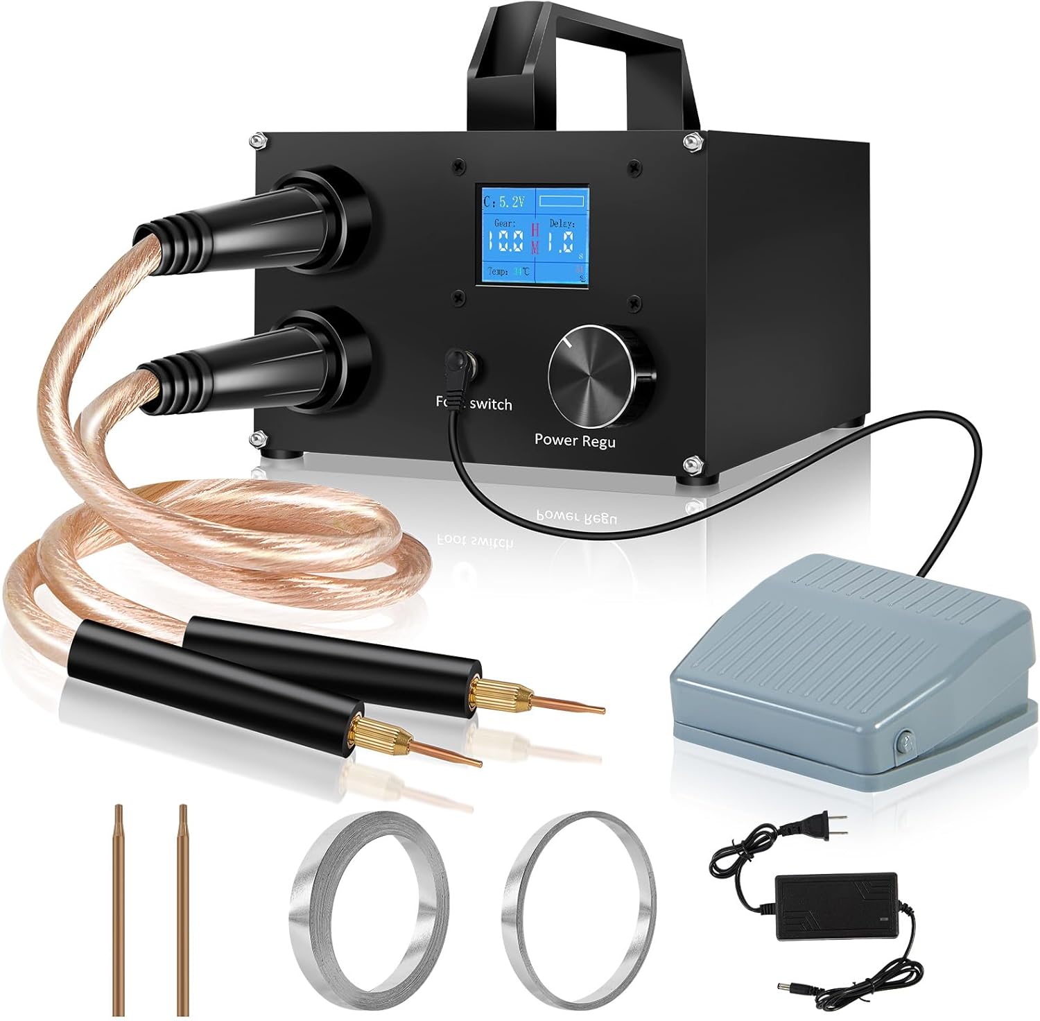

@SternWake what welder did you have again. Perhaps its good to start every post with it when people report results. :slight_smile:
I have the 14.6kw AwithZ p20B welder
good I just ordered the p60 (for 250) so there is hope for me no offense.
PS does anyone know if you can get the copper flux in europe?
The P60F at 29.2kW, has twice as much power as my p20B at 14.6kw, and I have successfully welded 0.35mm copper under 0.1mm stainless steel at about 95% of max power.
In theory, you should be able to do the same at about 50% power.

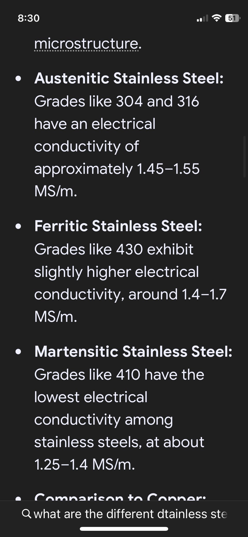

I can weld .2mm with .1mm stainless on top when in 22-25th gear with this welder. It only has 25
I don’t know what type of stainless steel this is but I’m looking into getting martensitic as it has the highest resistance. Or do you think simpler to use .2mm steel instead of .1 @SternWake ?
With the one weld looking wider and stronger than the other, and being gear 22-25 out of 25, it seems just barely capable of welding the 0.2mm under 0.1 stainless.

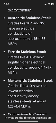

It seems 304 stainless is the standard but thr 400-500 are martensitic and higher resistance
Isopropyl alcohol.
Stainless grades other than 304 seem to get pretty pricey
You try .2mm stainless? That seems the best way to reduce the needed current @SternWake
Ive tried 0.07mm stainless, supposedly 304 grade, and can’t tell any difference than the 0.1mm 304 stainless Nelvick sent me.
I have used 0.5mm stainless some 400 series grade too. It required way more power.
