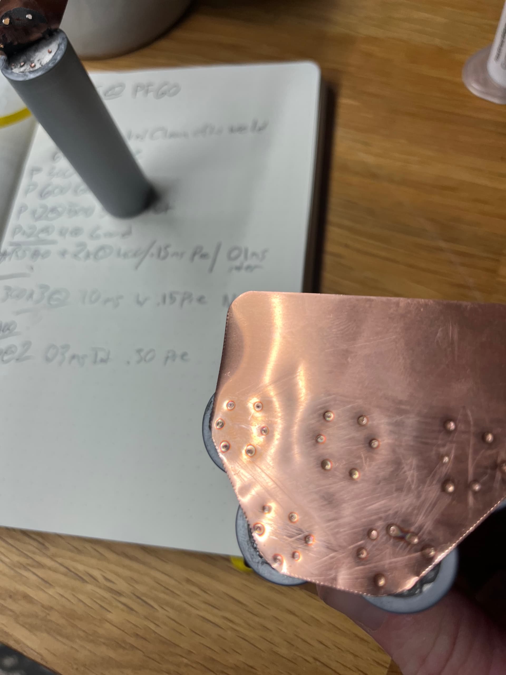

If you scroll through my posts earlier in the thread, I show lots of pictures and the settings I used to weld the 0.5mm stainless on top of various thicknesses of copper.
My 0.07mm stainless might not be 304 grade. I was surprised it did not allow for me to lower the gear as I expected.
The 0.5mm stainless did seem to make the copper welded below it, very flat. Id like to try 0.2mm and thicker stainless, for that reason, and because I know I have the power.
sanding the copper will reduce the surface area between copper and cell under the electrode, increasing resistance, and heat. Try it.
Can also sharpen the electrodes to try and get a stronger weld with welder on the edge of being powerful enough

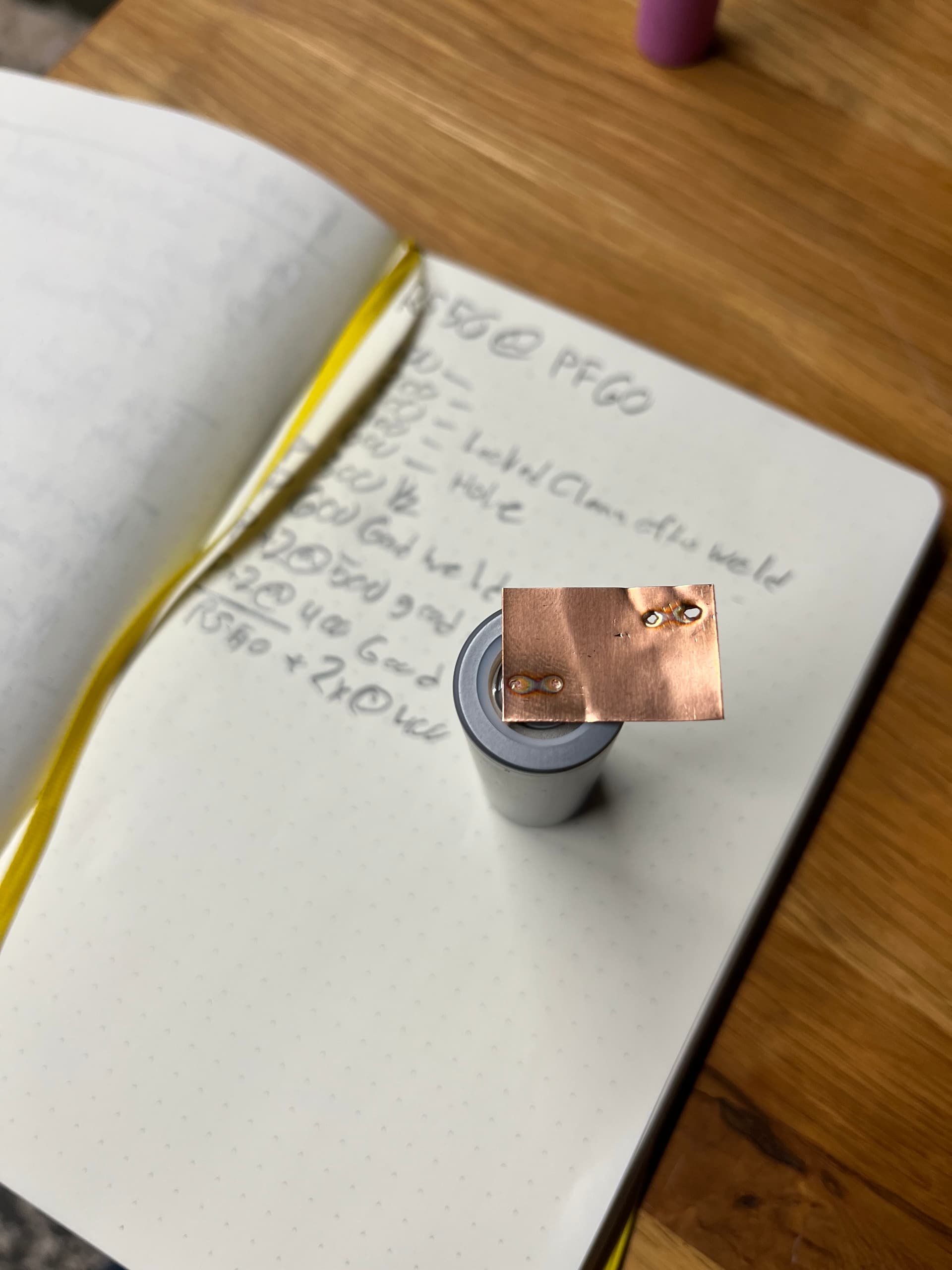

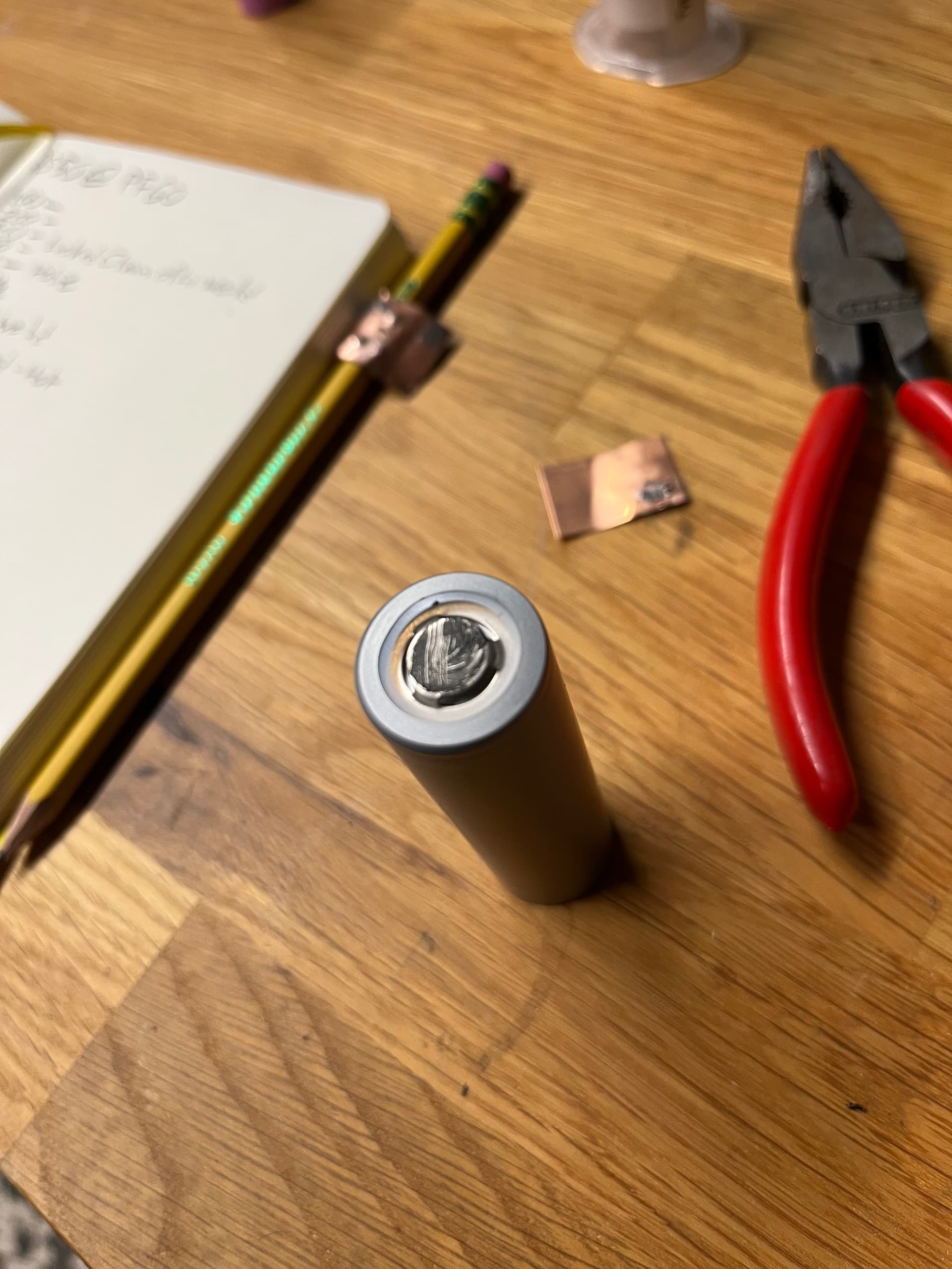

Sorry about the formatting, latest forum update makes posting a pain and the formatting its next to impossible for me to edit or move my cursor without crashing the gui. Tldr isnive got about 3 pages of notes looking for settings to weld .3mm copper to rs50 cells and finally dialed one im satisfied with. Not too hot and good adhesion. P60f welder gear 400 with 2 pulses at 03 interval with .15ms preheat with flux. Nothing else worked well. Single pulse was getting way too hot for my liking even with paste and tripple was the same with no significant decrease in gear (heat input). good strength and tearing tests at this setting and the copper wasn’t too hot to touch or fully heat soaked and could be handled without gloves after a few seconds

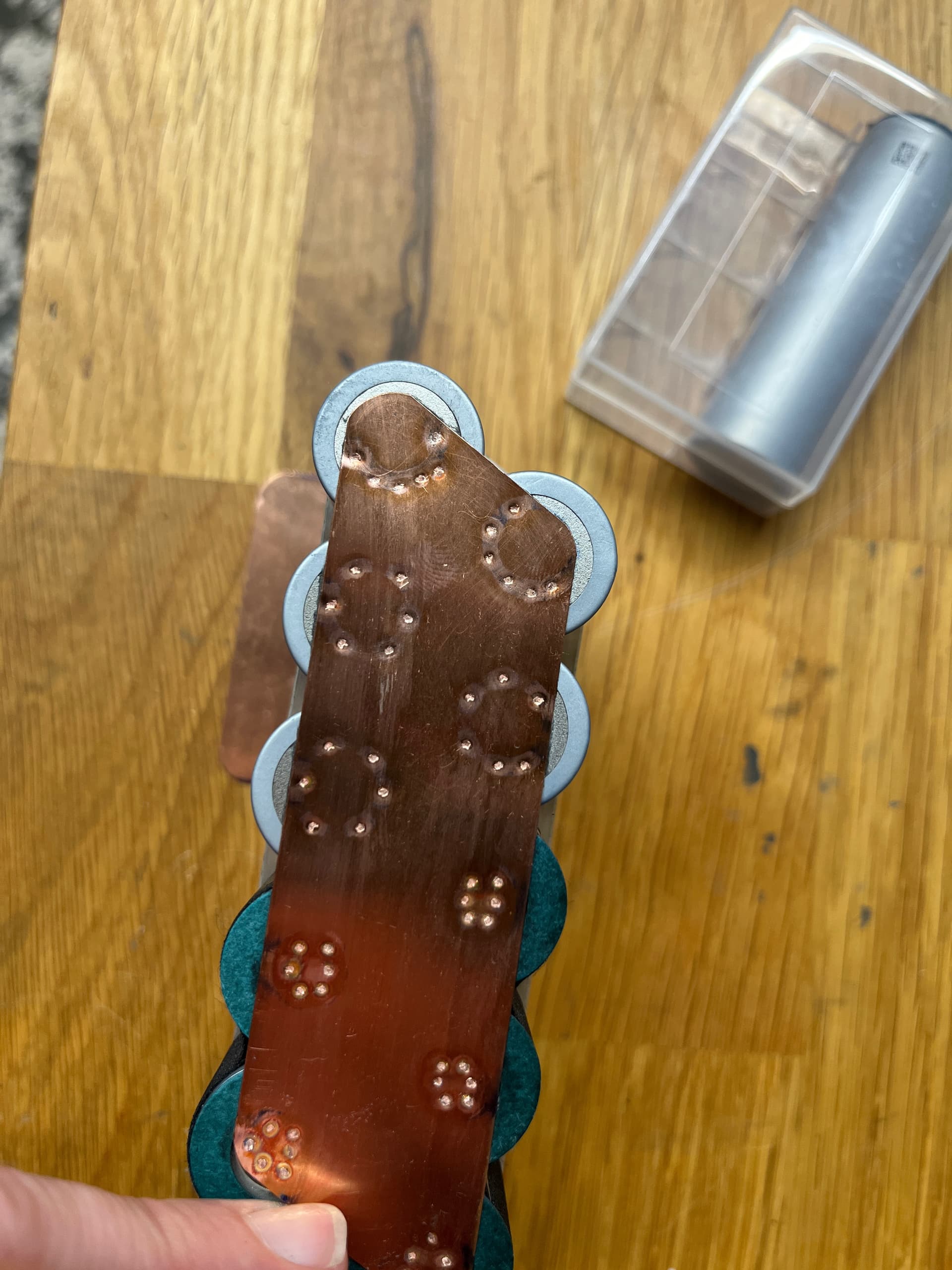

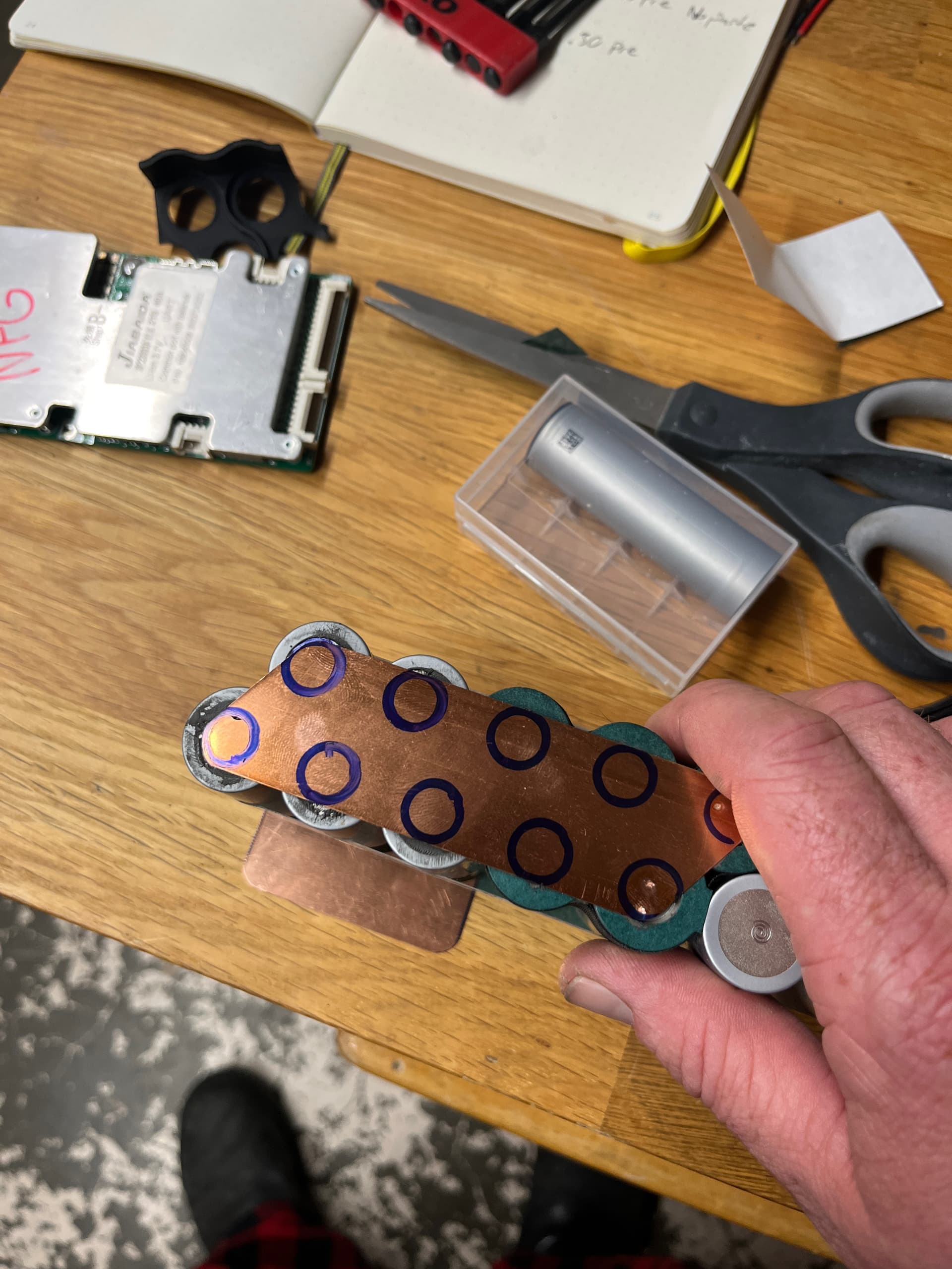

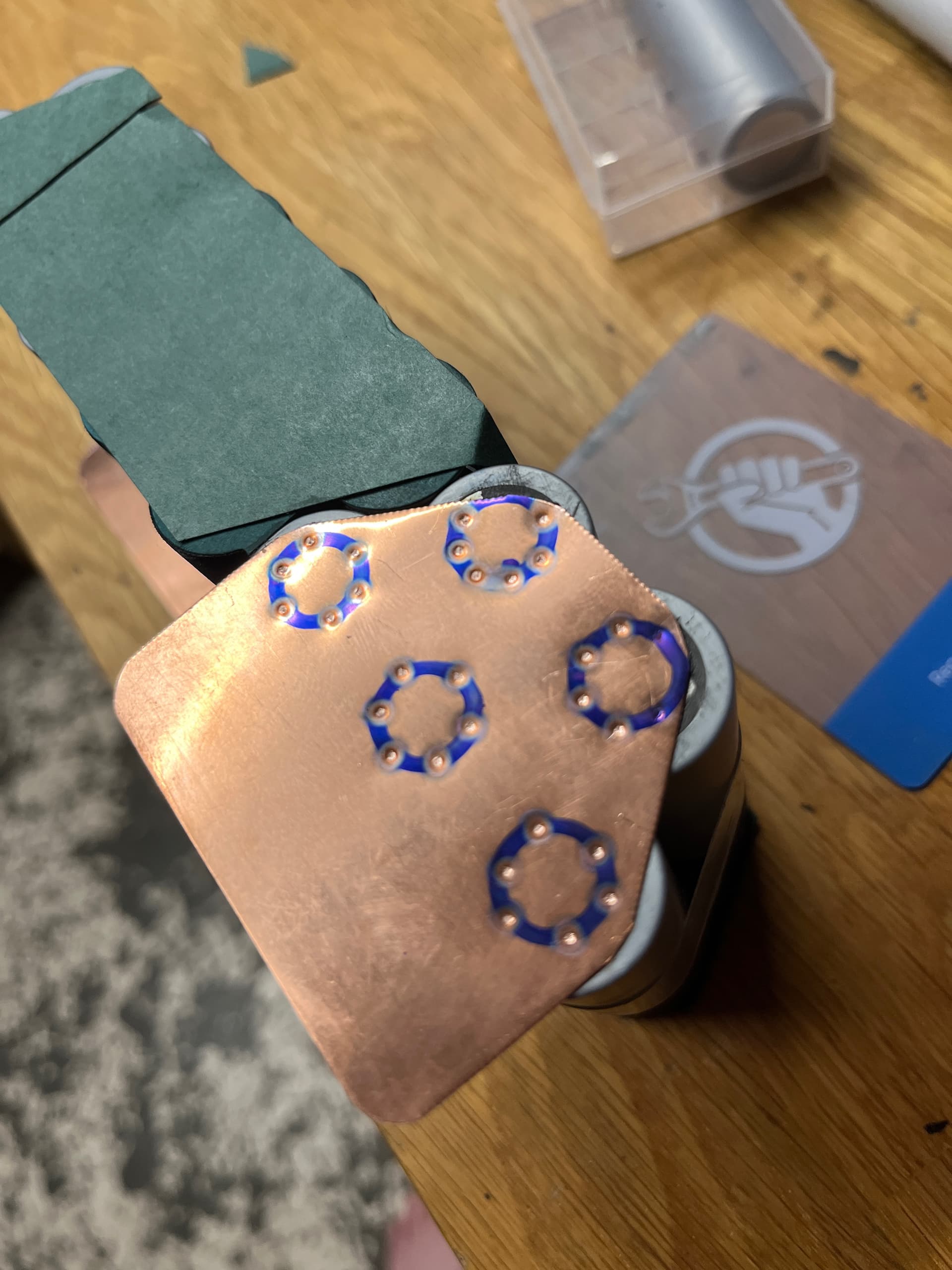

Can’t really get to the flux to clean it off but im using it sparingly. I have a little plastic spatula i put it on with just thin enough to leave a smudg
Then letting it sit for a minute to dry, the stuff will dry fairly quickly and get so that it doesn’t move around much
Then im doing the welds and it’s completely covered. Still getting the feel for this but im going to go from .3 to .25 copper in the future because the .3 i found is too hard and i have difficulty burnishing a flat spot to see the cell through the copper as well as i like and my welds aren’t as accurate as i want them. Nothing bad but not 100% perfect yet.
You can see on the negative a couple welds are

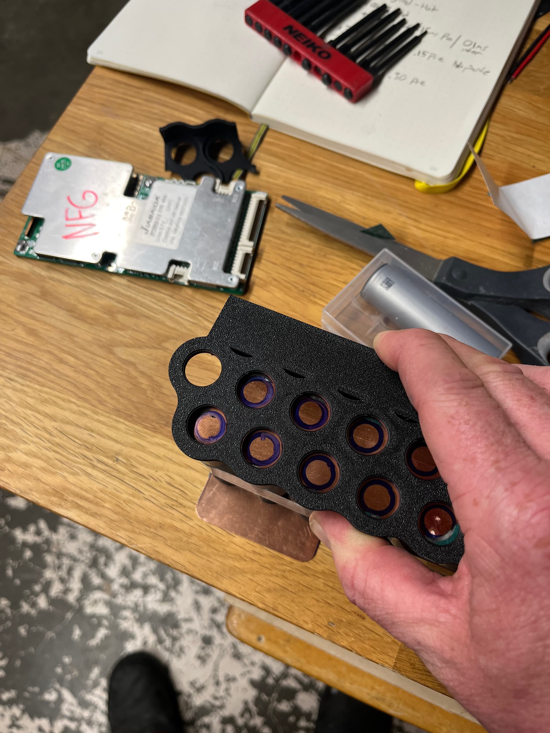

placed kinda messy but i checked carefully to make sure non are in the bullseye. I might make a template to go on top to make better center marks if i can’t consistently burnish a center well enough to clean them up

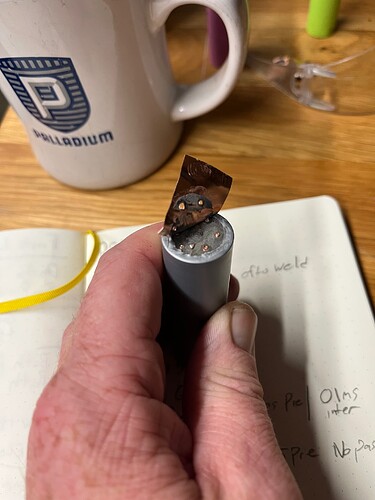

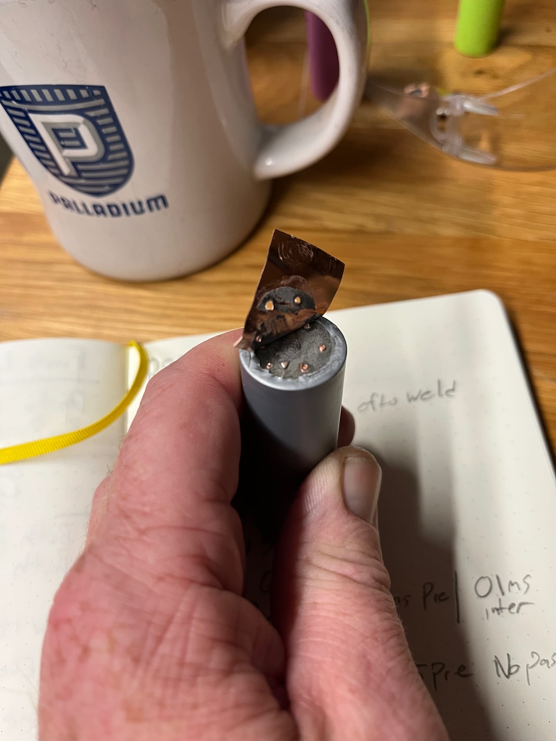

Regarding the tinning effect of the flux, I was only referring to inspecting the copper underside on the torn off test welds.
I found the more power was used, the more distance from the weld center the copper was tinned, when torn off, and successful welds could still havee very little tinning occurring. and some welds where more power than required was used the tinning effectively joined together between the welds and a significant distance away.

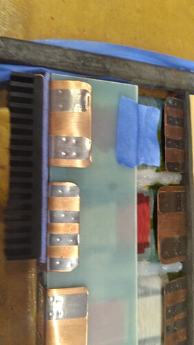

My previous build using 0.1mm copper, 0.1mm nickel plated steel with my old welder on BAK45D, I was prewelding the steel to the copper, and using strips to avoid the cell center.
My imprecision, despite efforts to achieve precision, I found I was often needing to weld atop the cell heatshrink. I wound up razoring it off so the whole bottom of the cell was exposed.
I wonder if needing to make a template for weld location on larger packs, how much more difficult it would be to make the template out of stainless, and preweld that to the copper.

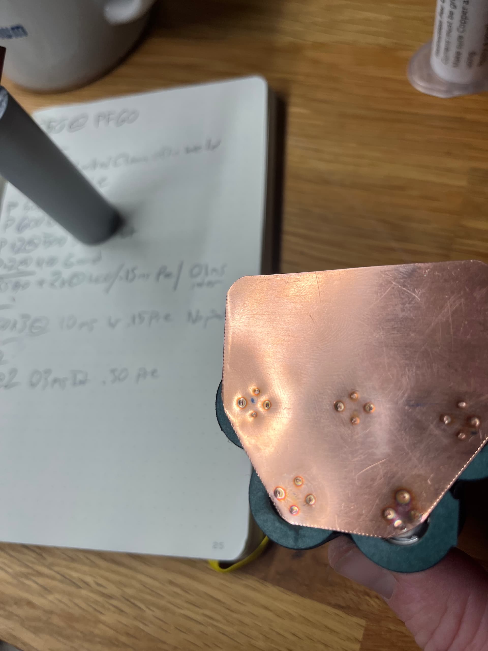

Ahhh ok, misread that a bit. I didn’t see much tinning beyond the weld itself but i was working front m low setting and adjusting up by about 25 “gears “ each step until i got good adhesion and tear off was symmetrical between the two weld points.
