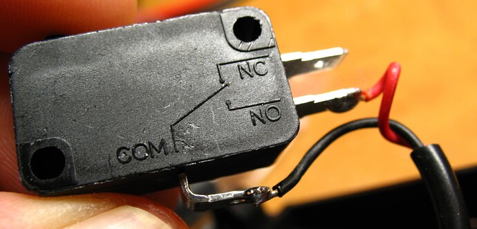

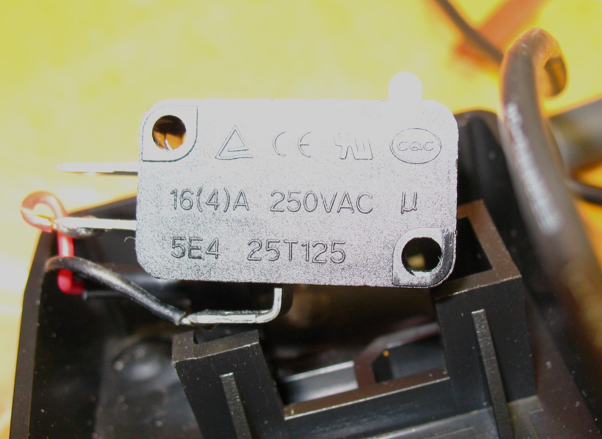

im not frustrated so much as being critical. inconsistency is the bane of repetitive processes, and welding like this is a lot of cycles. I have a personal vendetta against ip being protected through obfuscation over usability, longevity, and serviceability, it leaks into my perspective on other things like this welder even if the intention was likely not to hide anything from the user but likely was just to simplify the use of the tool. I’m going to swap pedals today and do some more testing and try to not rant about so many other things here lol. deleted a paragraph or two on the philosophy of collaborative projects and societies based on good faith efforts.
I’m in a contrary mood and its bubbling over into everything else lately lol so i deleted my off topic rant like twice here because omfg im just generally pissed at a lot of things going on in the usa lately :rofl: i will just say (edited again omfg shut up me) no i wont just say
I was curious about the inner workings of my pedal.
Couldn’t be more basic.
I didn’t want to pry the switch itself apart, and resisted the urge to spray some Caig Deoxit D5, G5, or f5in there.
the micro switches come in such a huge range of specs, the one in the kweld seems more robust and i forgot to take a pic of it when i was comparing the two. ill snap a pic and do the swap testing but it might be good to just get a more reliable micro switch that is in the same form factor as the existing one to swap so i can still have two pedals… ill report back.
New Pedal is on the way.

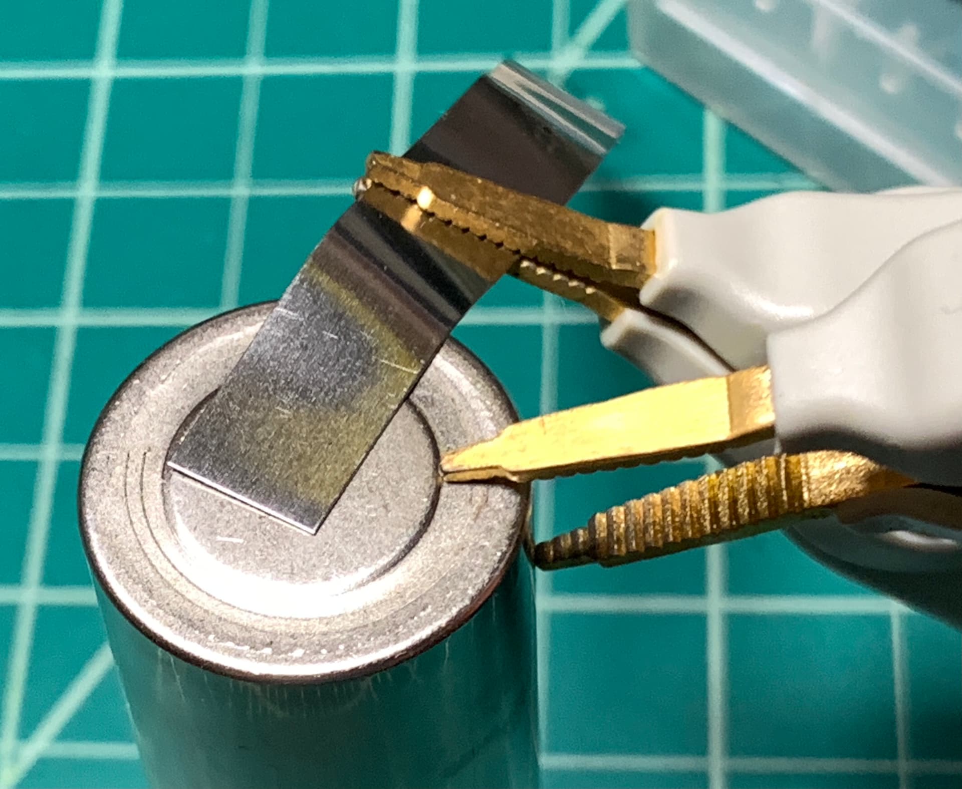

I am a bit confused as , I don’t know how your micro Ohm resistance tester works.
What I am imagining, is that one probe goes on the cell negative, the nickel plated steel can itself, the other probe on the end of the welded strip, whether it be copper or pure Nickel.
So it seems there would need to be room on the cell negative, onto which to place the resistor tester’s probe outside the welded strip.
The other way my brain has attempted to grasp this is by measuring the cell resistance outside the welded strips, then measure the cell resistance through the welded strips, and do some math and average out the resistance of each spot weld.
I don’t want the cells to arrive, and you open up the box and be like:
ā€˜WTF/ how am I supposed to test this with any precision? How Dumb is this MF??’
Here’s a quick mock-up…
The two clips are connected to each other and the reading zeroed out.
One clip goes on the strip, whatever standard distance we use from the center of the cell.
The other clip touches the cell’s can (both tips must touch). It can also touch the side wall, just above the bottom of the cell as the resistance difference will be tiny. The distance can also be a standard amount we choose, 3mm or whatever, to equalize that parasitic resistance for all readings.
Very helpful photo, thank you.
I assume you can grab one of the cathode vent bridges with that clamp, and the test cells can have strips welded on both ends?

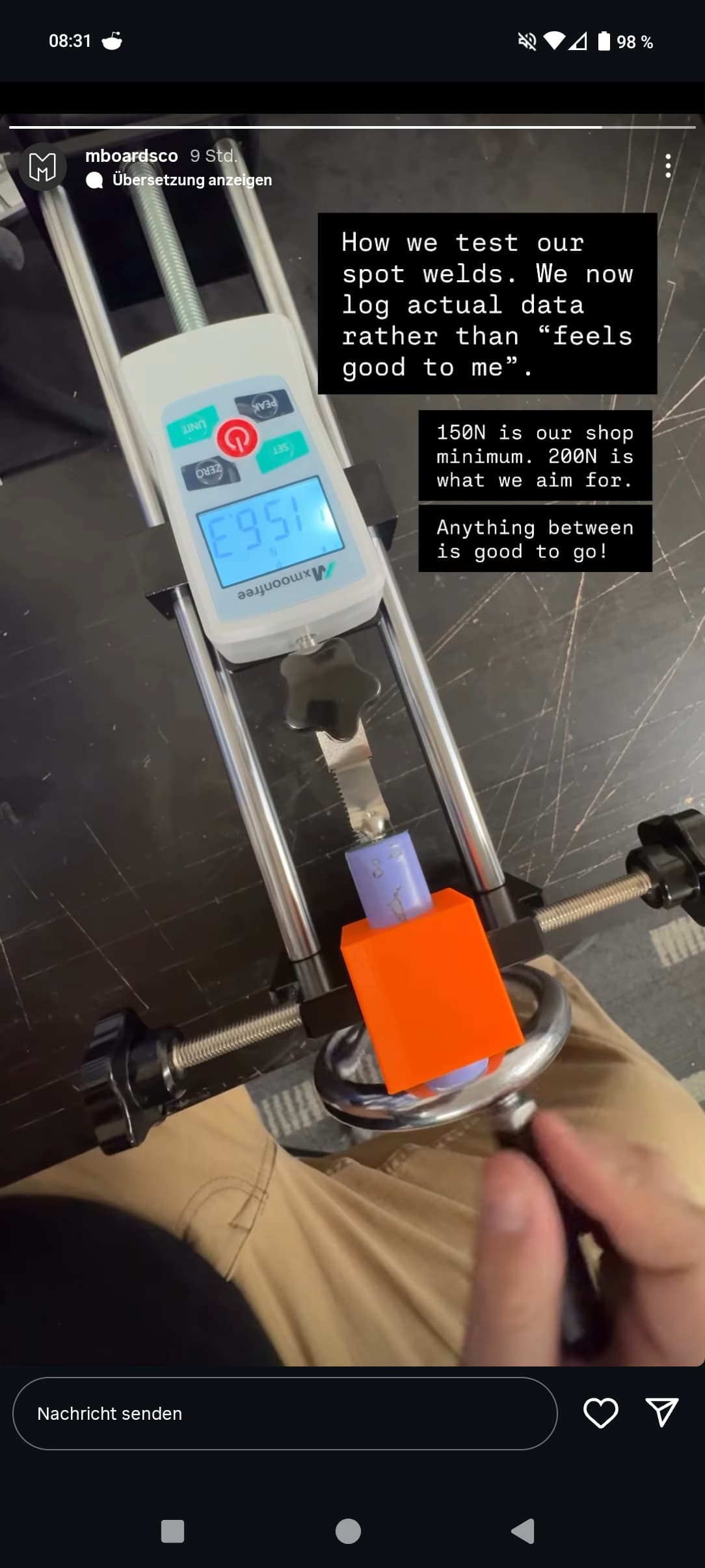

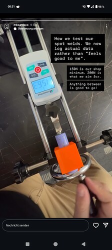

Kinda offtopic but I saw this and thought about this thread.
That is great to be able to objectively state how much force is required to tear off a spot weld.
But often we are not breaking the weld but the material immediately adjacent to it, and once it starts tearing, when rolling it off, the force required decreases quickly.
I am also not sure how important peel off strength is, when pulling at 90 degrees to the cell, when it seems in battery builds all the stress will be at near 180 degrees, like a rigid flatpack in a flexible skateboard deck.
When rolling off the spot welds, trying to not deform the cell can, the shape and size of the needle nose pliers has a huge effect on when the material starts tearing at the edge of the weld, unless the weld is so weak the material just pops off leaving little behind of the cell.
