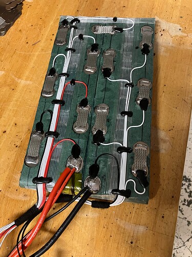

My latest use of mixed braid and sil wire:
Each cell of the enclosure is a solid brick with the span between cells done with wire because there is movement between the cells as the deck flexes. A different brick build wirh 0 flex and 100% braid:
I dont see how either of these could fail that way.
Ive got 1000s of miles on two other boards built this way and haven’t seen anything that would make me think this was a failure mode, the first here used the braid before i heard the good word but it is still doing well, had it open a few weeks ago and no signs of wear

Sorry this is slightly off tangent. Why do people spend hours insulating their batteries but then only cover the series connections with Kapton? Surely there will still be friction between them and the deck?
There won’t? It will never touch the deck or anything ever.
… but also the kapton is just under the silicone the silicone is for water, the kapton is to make digging it out of the wire not a huge pain if i have to fix something. And also maybe you didn’t see the heat shrink on all of these or it is a pic before waterproofing or one of those accidental compliments and i accept :kissing_heart: i don’t do commissions though :wink:

I used braid on a carbon fiber deck (stiff) thane board. Opened the pack after 1000km and it looked good as new. I believe within segments it’s definitely a good way to keep it low profile

In my flex pack, TomiBoi enclosure similar to what you have pictured, I built it almost exactly the same way still going strong. Big difference though is I heat shrinked the braid that needed to stretch further to make connections. For extra durability and chaffing resistance.
But looking at these pictures I suppose I could still see the ends right at the nickel still tearing. But that would require a lot of lateral vibration imo.
Same for my raceboard, the RE44 flexes the tiniest bit but the braid looks the same as day 1

I silicone my packs into the enclosures so there is no movement lateral or otherwise. you have to split the shrink to take them out but i don’t care i see it as an ounce or protection keeps the dr away. I can’t imagine braid which is only flexible in one dimension doing well with any lateral flex/vibration - you might be on to something here.
