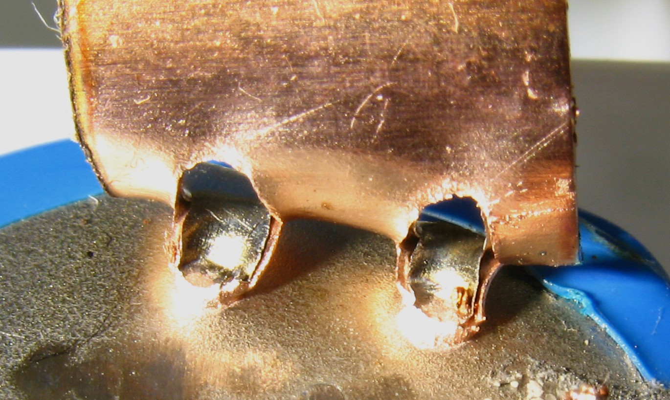

I will try 0.2mm copper, 0.1mm stainless no flux, this evening.

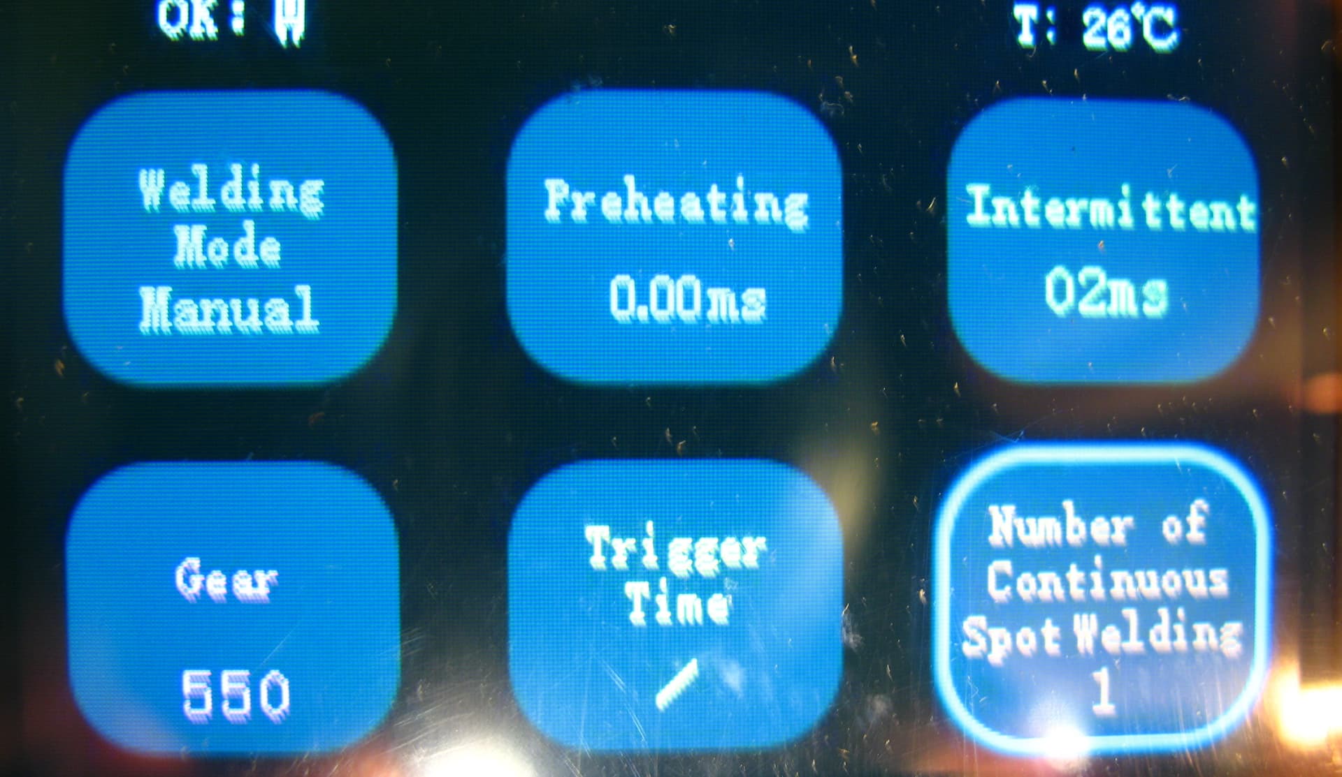

I lowered it to 1 pulse and no preheating.
Gear 550 = ~ 55% of the available power
0.2mm copper under 0.1mm Stainless steel
No flux.
Couldn’t pull it off, had to use needle nose and roll it off.
Vey strong weld.

For 0.2 probably you need to go with 030 or less, 0.10 pre-heat 2ms dual shot.

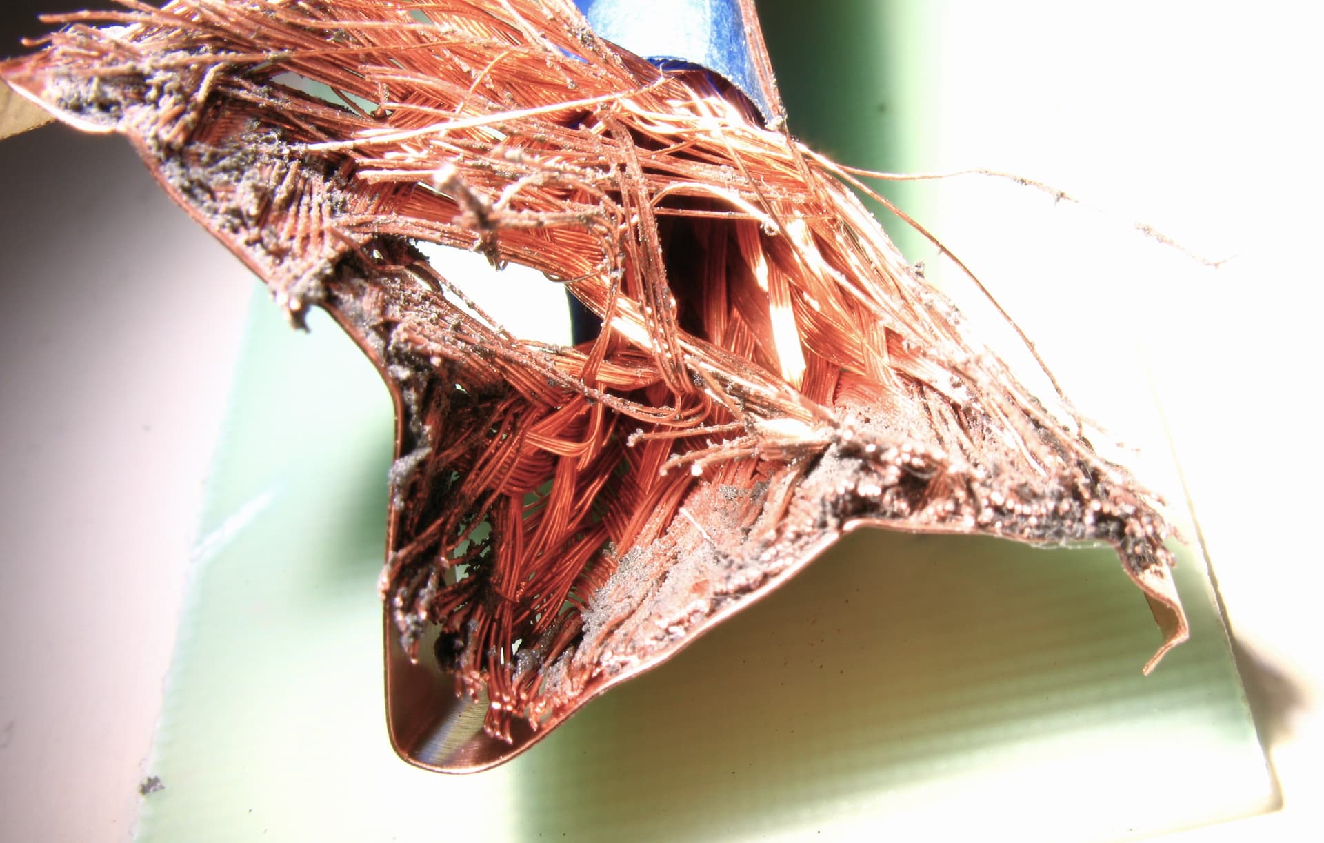

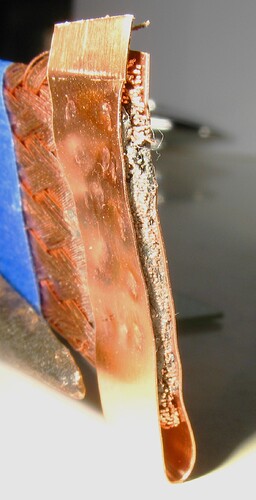

My 1.5mm x 15mm copper braid came today, and in my grubby paws is much different than expected.
My thought was If copper to copper welding is possible, how about eliminating solder, and the wicking and potential brittleness and the significant amount of heating the cell must endure when soldering braid to the tabs.

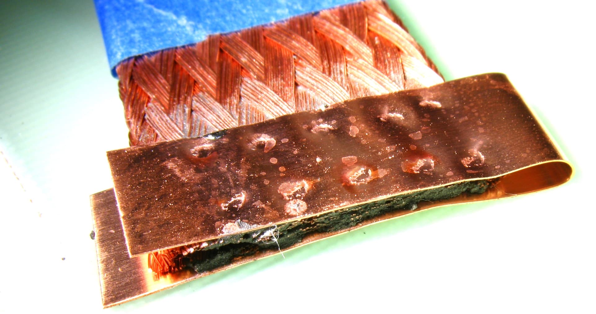

So I cut a strip of 0.15mm copper, squeezed some flux into the braid top and bottom and sandwiched it.
5 pairs of welds each side, no preheating, single pulse, gear 550.

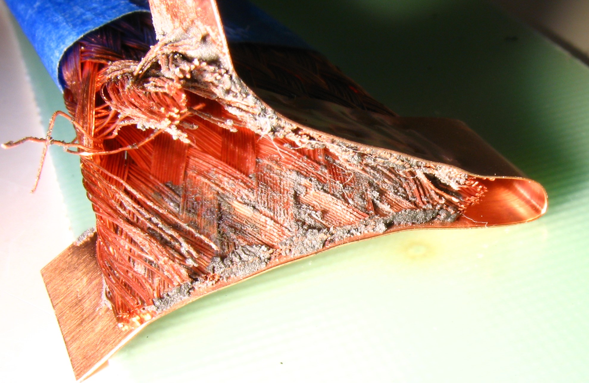

When I pulled it apart, I realized the flat copper braid is basically hollow sleeve.
The stranding in direct contact with the welds is certainly welded firmly.

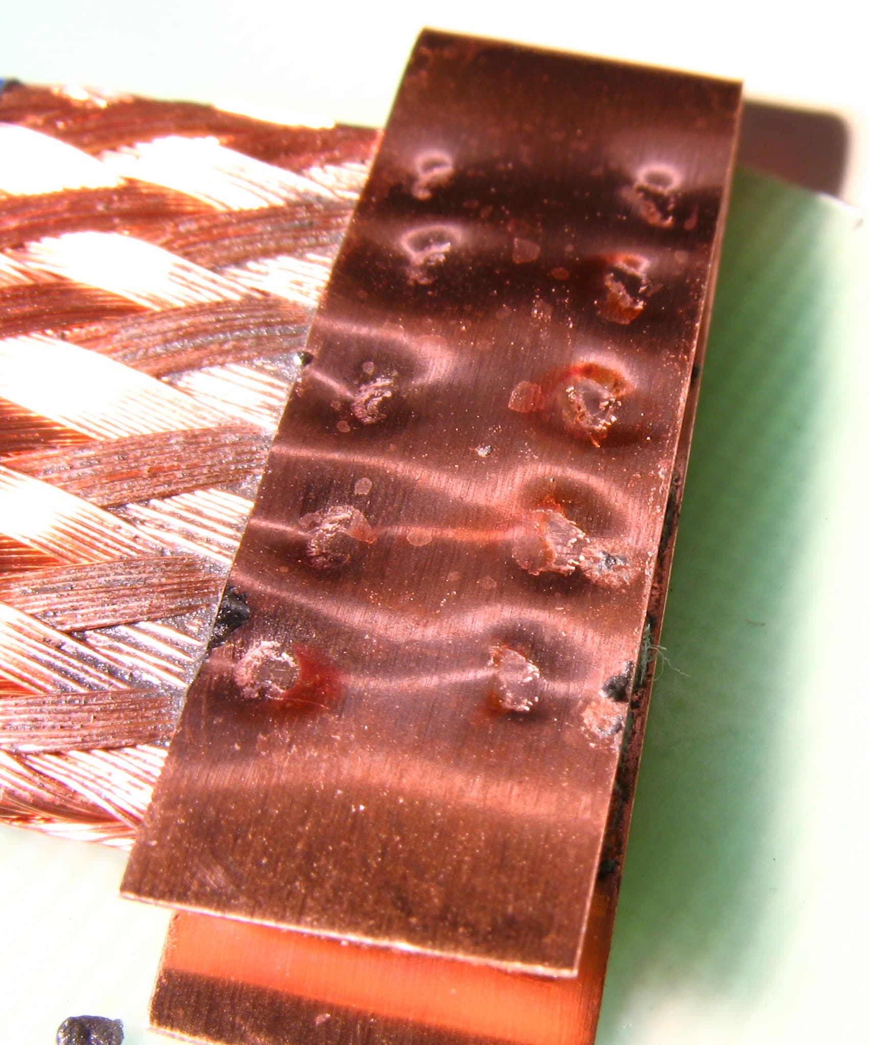

I closed up this test piece, and positioned my electrodes on Either side of the 0.15mm copper, I didn’t add any more flux.
Added 0.15ms preheating, single pulse, gear 550, and hit the pedal three separate times in total after repositioning the electrodes.
I didn’t pull very hard, but it did not want to come apart very easily.
I obviously didn’t nail the technique or settings, but as far as proof of concept, I don’t think it can be ruled out.
The opposition welds did not make much if any flux smoke compared to the 6 pairs on each side of the 0.15mm so it was probably ineffective on the opposition welds
However I don’t have my HEPA filter set up properly to capture the smoke and do not wish to experiment with this more until I do. Also, the 1.5mm x 15mm braid seems quite excessive.
I have no experience with braid.
I assumed it was all flat, but mine is like an expandable sleeve.
I have some more ideas to try, but I think wide flat Braid and no solder flexible series connections should be possible
In my experience, all braid is a flattened (expandable) tube/sleeve. This allows it be used for shielding/protection around a wire (tube) but also as a grounding strap or main lead (flat).
I’m happy to test a couple configs of that to see the connection’s resistance and how a braid weld handles current.
I looked at every picture on the first 4 pages of Ebay hits, and came to the same conclusion, they are all hollow, and wonder if it is a necessity of manufacturing, that it would unravel otherwise.
I have a horrible hydraulic crimper that I tried to use to flatten the braid, and cold weld it between two 0.15mm strips. The cold weld seems highly unlikely, but compression flattening , then spot welding a copper sandwich to that Flattened portion could be a possibility.
