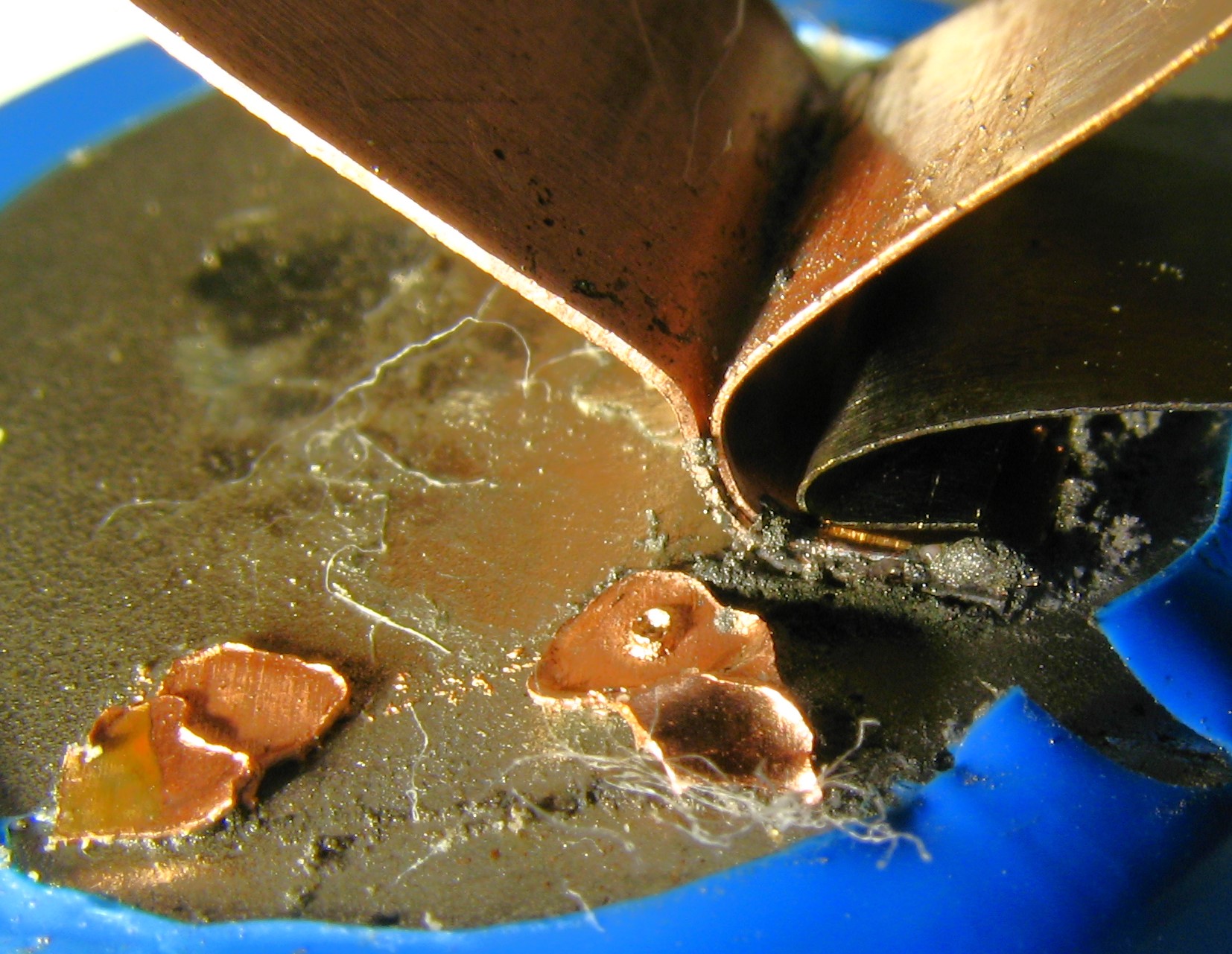

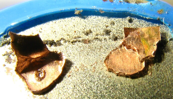

Once again, grabbing all three layers in both sets of thumb and forefingerss and pulling straight up, no wiggling or rocking, with all I have reveals the above photo. The 3 strips are deforming around the welds.
Busting out the needle nose is required and some slight wiggling and rocking is required to start tearing the bottom layer of copper, and then the stainless pops off and then the copper continues tearing, getting easier and easier to tear.
The flux tinned the area between the spot welds and in a even circumference around them.
The welds are not going anywhere, but the SS is not welded as firmly as I would like to the copper layers below.
But I have No idea if this even matters.
I’d bump up the power a bit if trying this weld again.
The probes are not feeling like they sink as much when the capacitors fire, as they do when using nickel plated steel.
The 2 layers of copper are throwing another variable into the mix, but I think if one uses 0.25mm copper under 0.1mm stainless it would be stronger than stacked.

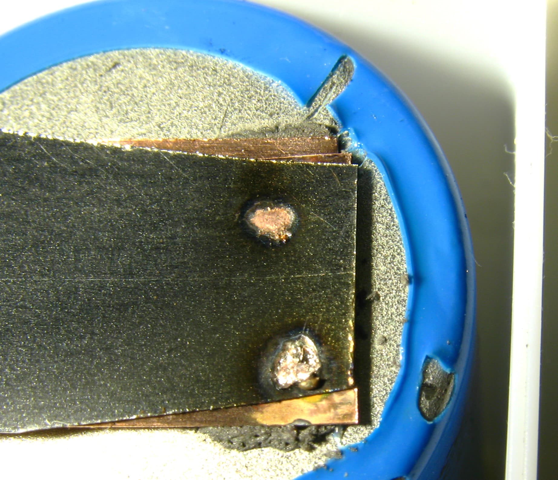

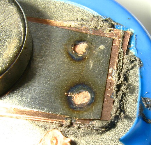

Onto dual 0.15mm stacked under 0.1 SS
Dual layers 0.15mm copper under 0.1mm Stainless
Gear 550
0.10ms preheating
double pulse
2ms interval

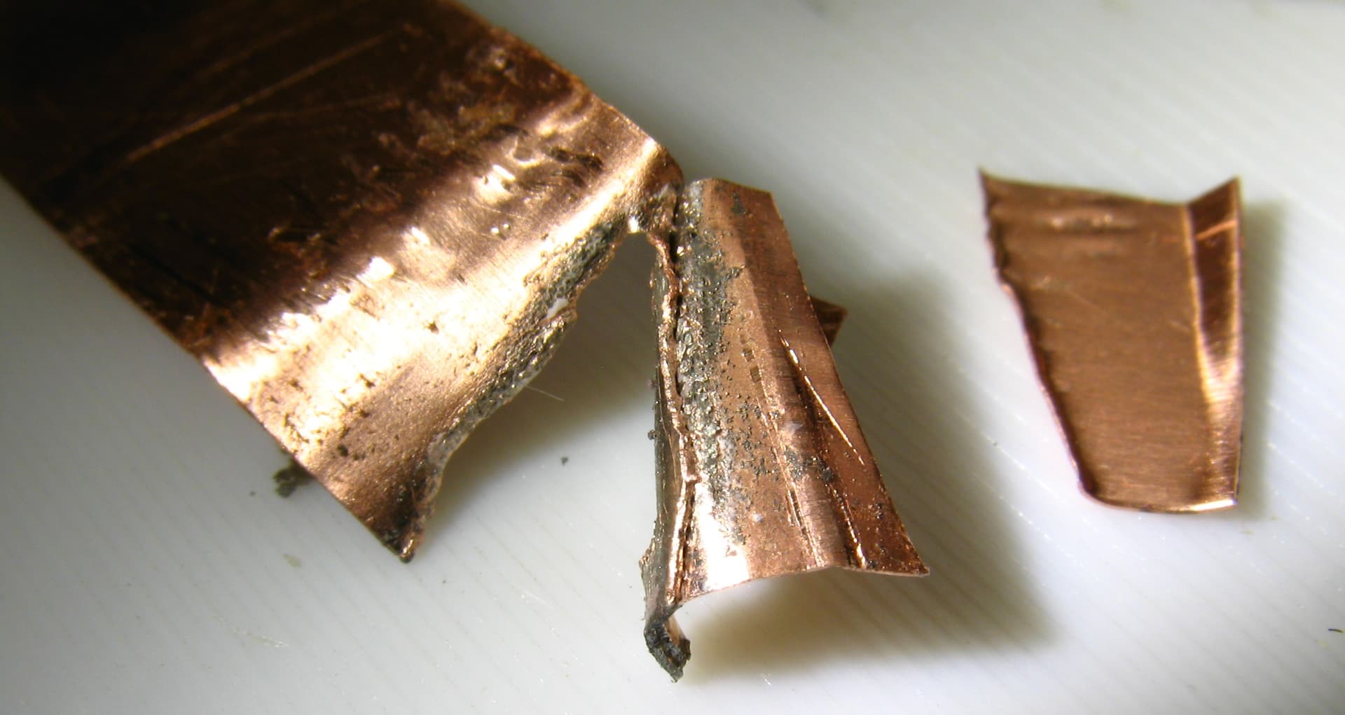

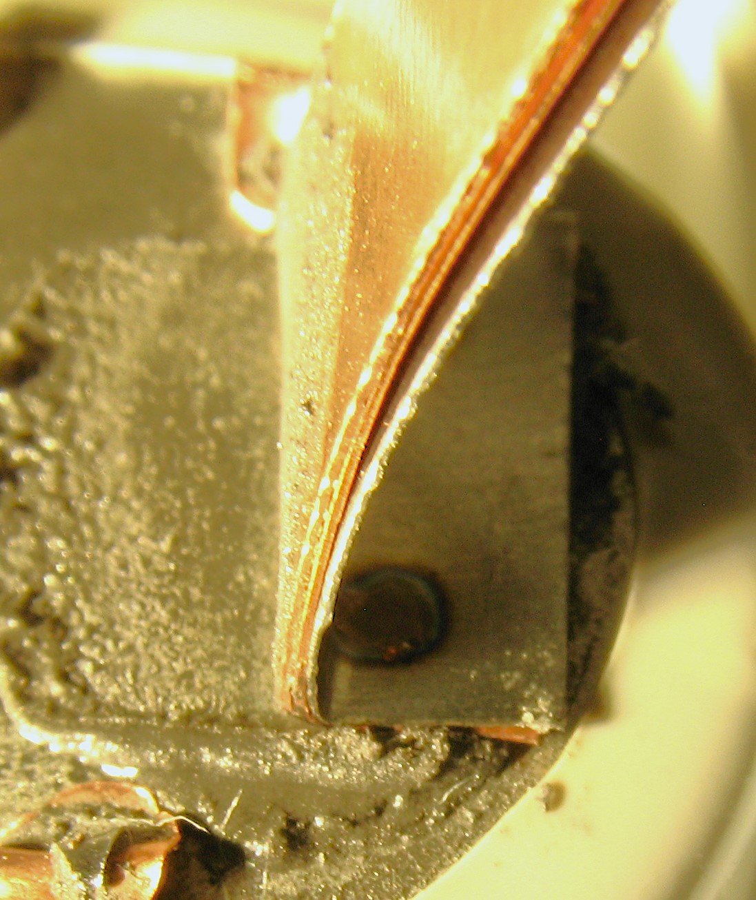

Once again there is no way to remove this from the cell with bare fingers, doubled on each other grasping strips and prying knuckles. upwards. The Plyers are required to start tearing it and even then some wiggling and rocking is required to start the copper tearing from the weld
both layers of copper are firmly welded to the cell , and the weld on the left has a bit of stainless stuck to it, but the weld on the right has a mere Dot.
The exact forces I exerts with the plyers and how they grab the 3 layers, play a huge part in how this appears. I am trying to be consistent, but there are variables at play here.

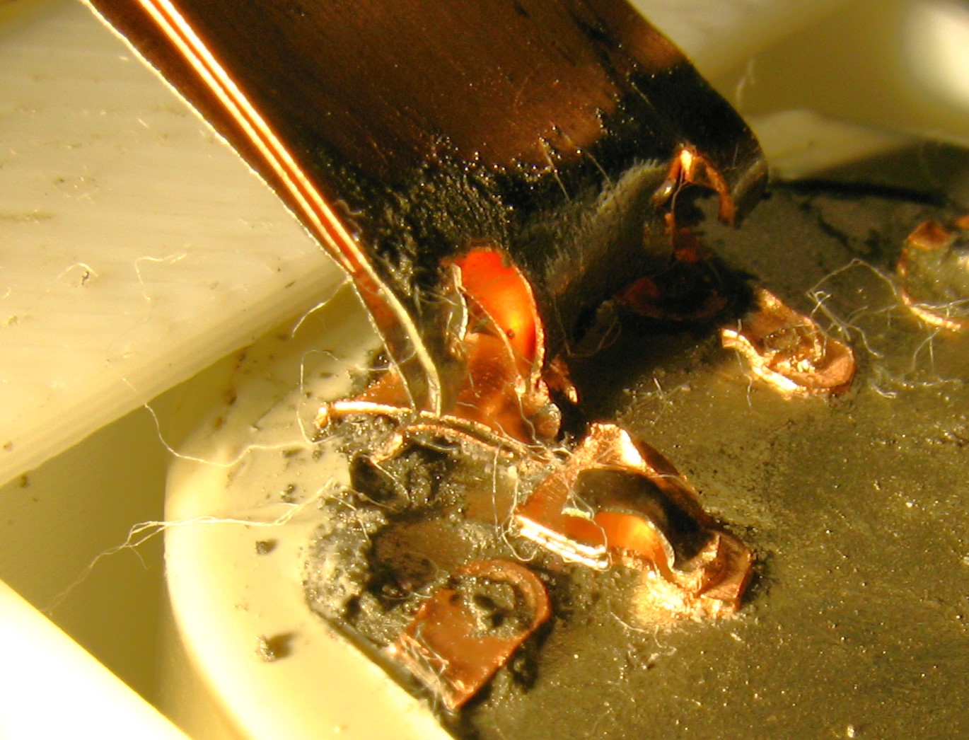

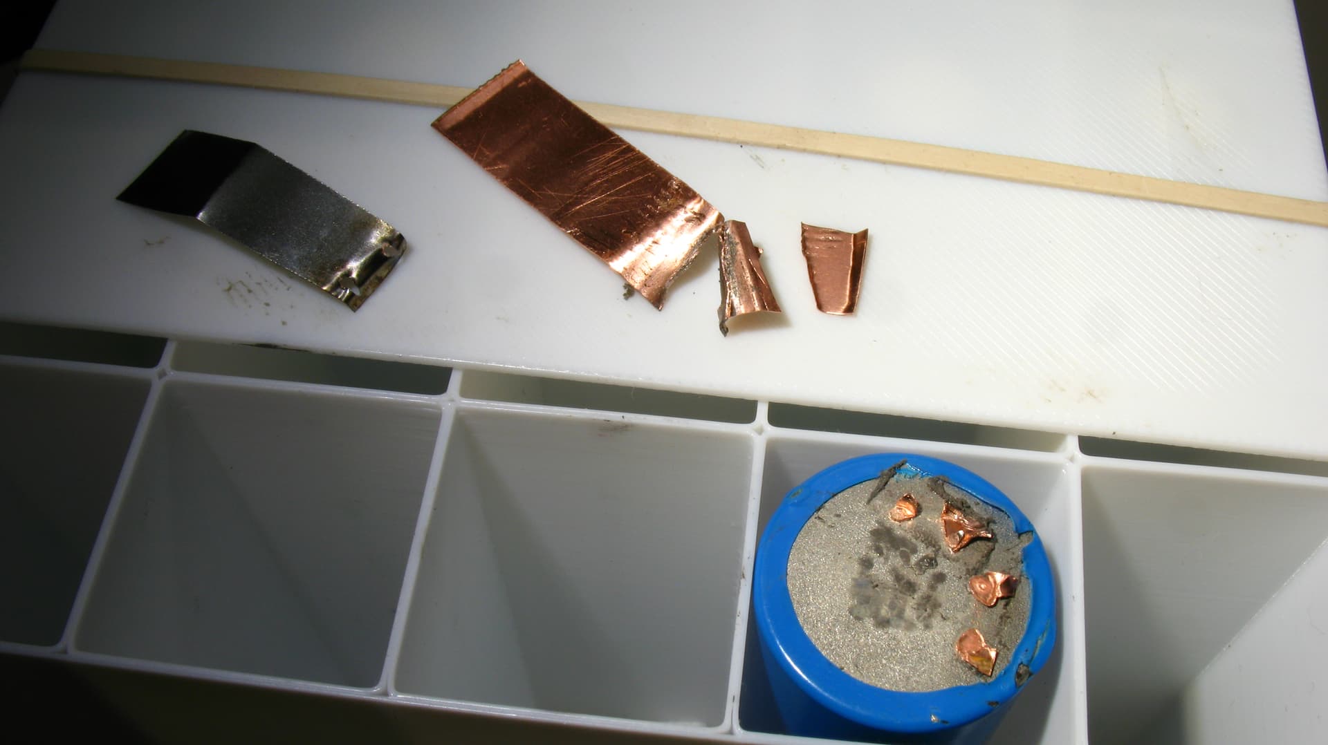

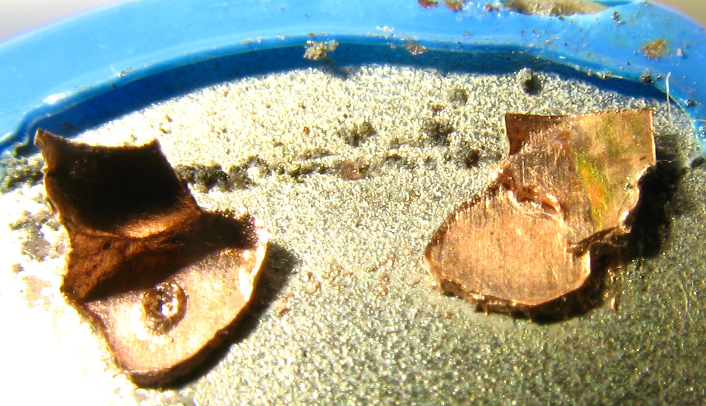

Ok, I tried dual stacked 0.2mm under 0.1mm stainless and gear 800
No chance
Tried again at gear 900, bumped up preheating to 0.15ms, and triple pulse. At first I thought it was a good weld, and it took a fair amount of force to lift off, but then abruptly let go and left only the slightest smidges of copper on the cell.
I was using a Wintonic Anode I had not yet welded to previously. It was one of the punctured cans that I’d had filled with some e6000 a few days ago.
I did not want to go Dremel off the 4 tiny remnants of previous welds on a 50E. My dremel is behaving poorly. it cant hold a steady speed.
I think 0.4mm copper under 0.1mm SS is perhaps just within reach of this welder with gear 999 and triple pulse and maybe 1ms interval, or maybe 5ms interval. I’ve not played with the interval much. or preheating for that matter.
I can say that I see no purpose in welding anything thinner than 0.2mm copper and 0.1mm stainless steel sandwich

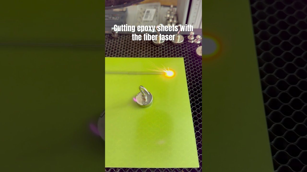

Dude… I can cut 2mm of copper. I cut a coin that is 1.5mm in seconds. Check this epoxy sheets.
Cutting nickel
This is moving beyond the scope of this thread… i will meet you in pms :joy:

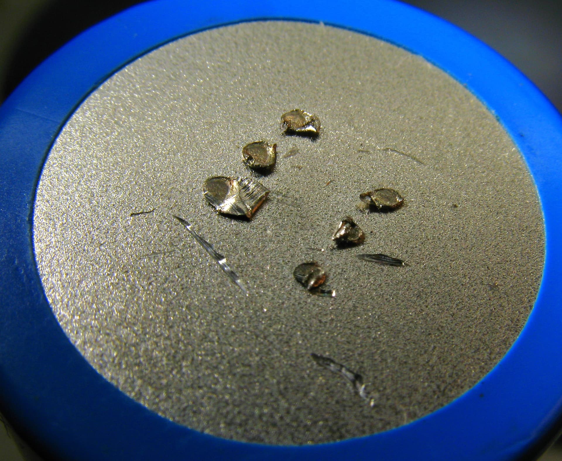

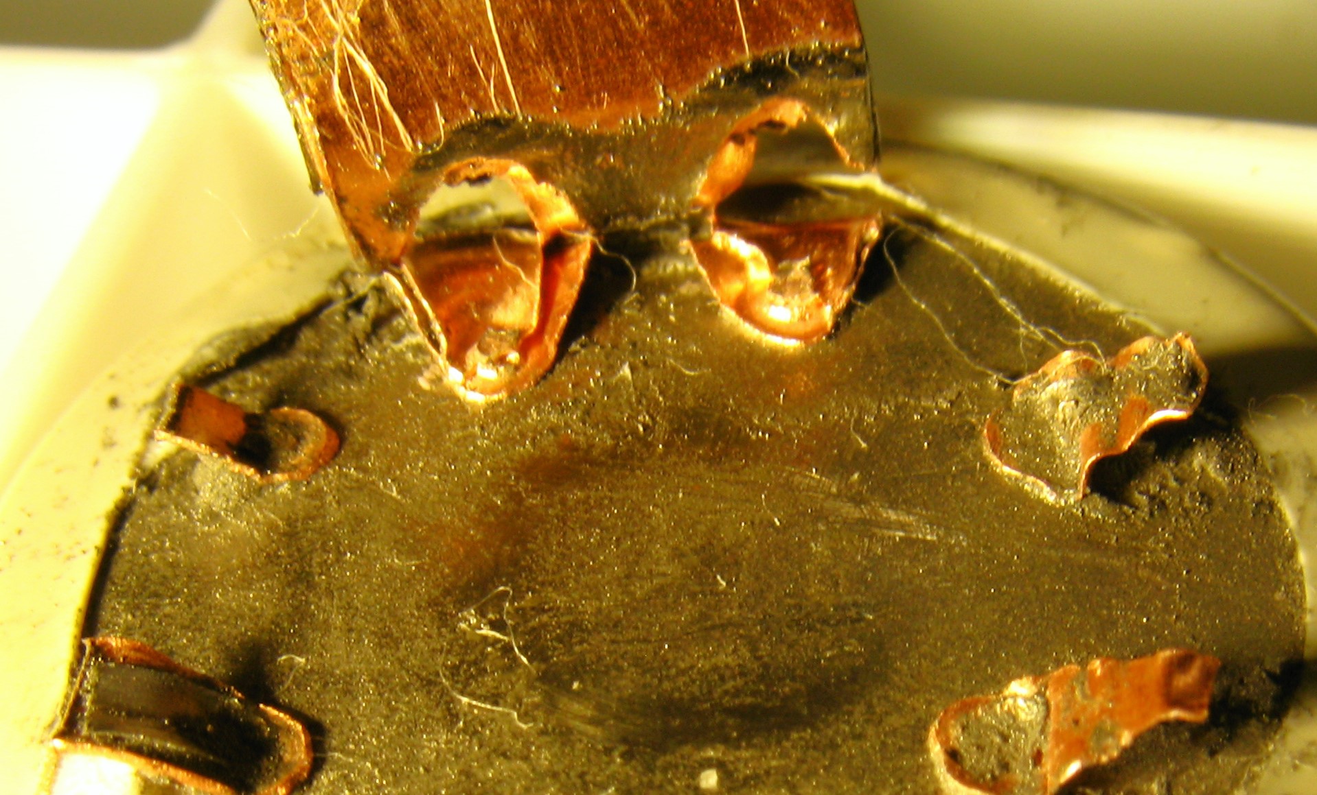

I took the lowest voltage Samsung 50E, and took it to the dremel with stone wheel, well, to the can anyway. I did not want to get conductive dust under the +, or take the precautions so that it could not. I guess there is a chance this cell becomes part of a pack again, and I don’t want to ruin it if I don’t have to.
A bit of a reminder how welds are done in some other other applications. Nelvick, Do you know what these cells came out of?
Note that this is not the cell I dremeled and welded to, as shown below.

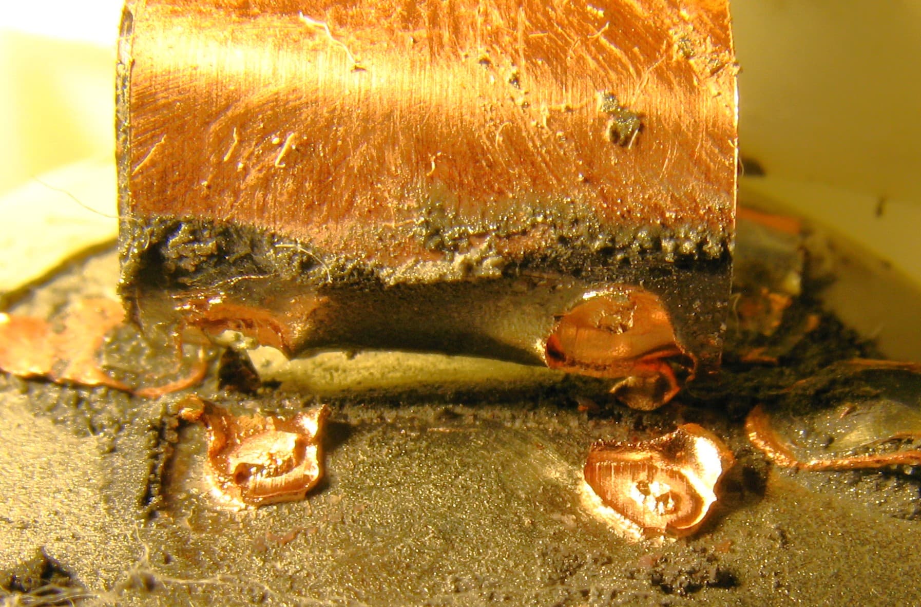

This is 0.2mm copper on cell, under 0.15mm copper, under 0.1mm Stainless steel. Triple stack.
Gear 900,
Double pulse
2ms interval between pulses
0.15ms preheating.

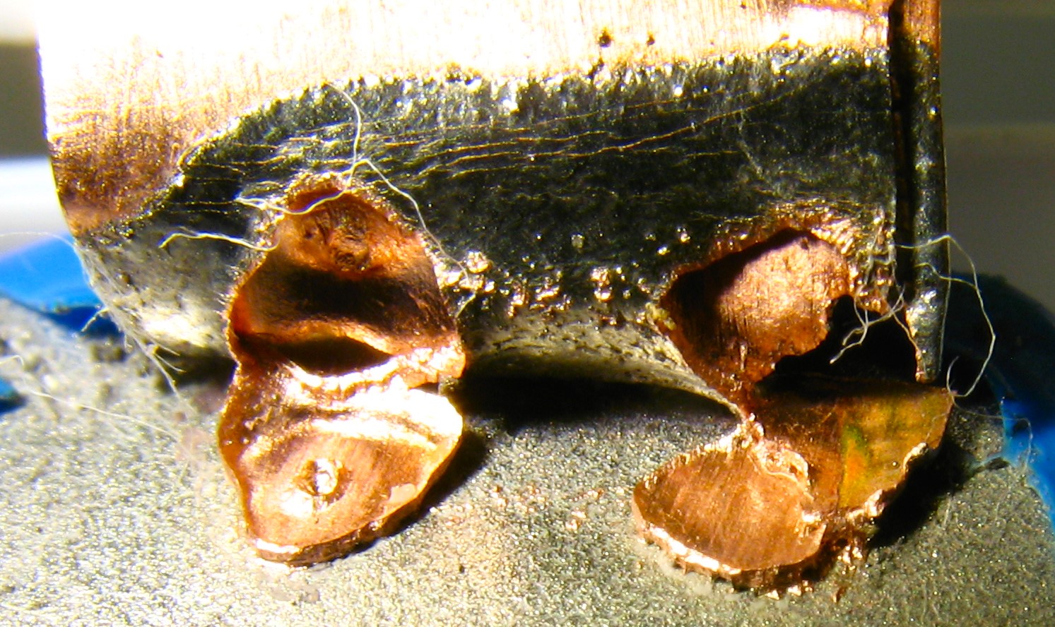

I messed up, and forgot to use the magnet to help align and immobilize the triplestack, then got the electrode too close to the edge of the stainless. There was the most sparks yet of any of my Stainless welds, But not really all that many. My old welder with 0,1 Nickel plated steel atop 0.1mm copper shot more sparks by far, every weld.
The damage to the heatshrink was not there previously.
Once again, bending the 3 strips straight up, clamping with both hand’s thumb and forefinger atop one over the other, with all my strength, and lifting, this triple stack was not coming off, and even some minor rocking wiggling and a circular motion was denied. I had to bust out the needlenose plyers, and start rolling it off, and then the 0.15mm copper separated from the 0.20mm below it. The stainless stayed bonded to the 0.15 on the left weld, and to the right weakly, immediately adjacent to the spot.
Notice the larger bits of ā€˜grit’ in this photo, and what appears to be copper stuck to the can itself in between the welds.
I wish the stack didnt slip, from a proper looking weld perspective, but that flux tinning and bonding the two layers of copper on the sides is interesting.
Overall, I think this stacking of copper is reducing the tear off strength of the weld, but it is still taking a significant amount of force to roll the welds off. The weld on the right, there is a lack of dot tearing off, but the second layer of copper is stuck outside with weld circle, likely as the flux wicked between the two layers when the stack slipped.

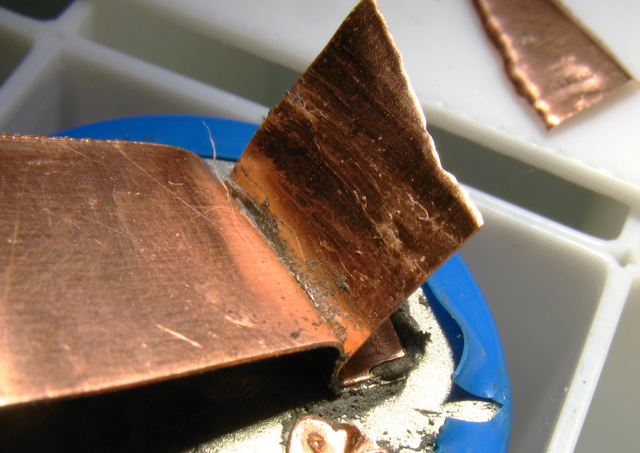

Ok, this one is interesting.
Gear 850
Triple pulse
0.15ms preheating
02ms interval
0.15mm copper on top of 0.2 copper layer
0.1mm stainless on top of both.
triple stack.
Flux between 0.2mm copper and cell can
Flux between copper layers
I was trying to be frugal with the amount of flux, and spreading it wide and flat and evenly, with the 0.15mm piece.
This photo nicely shows the 3 different material thicknesses.

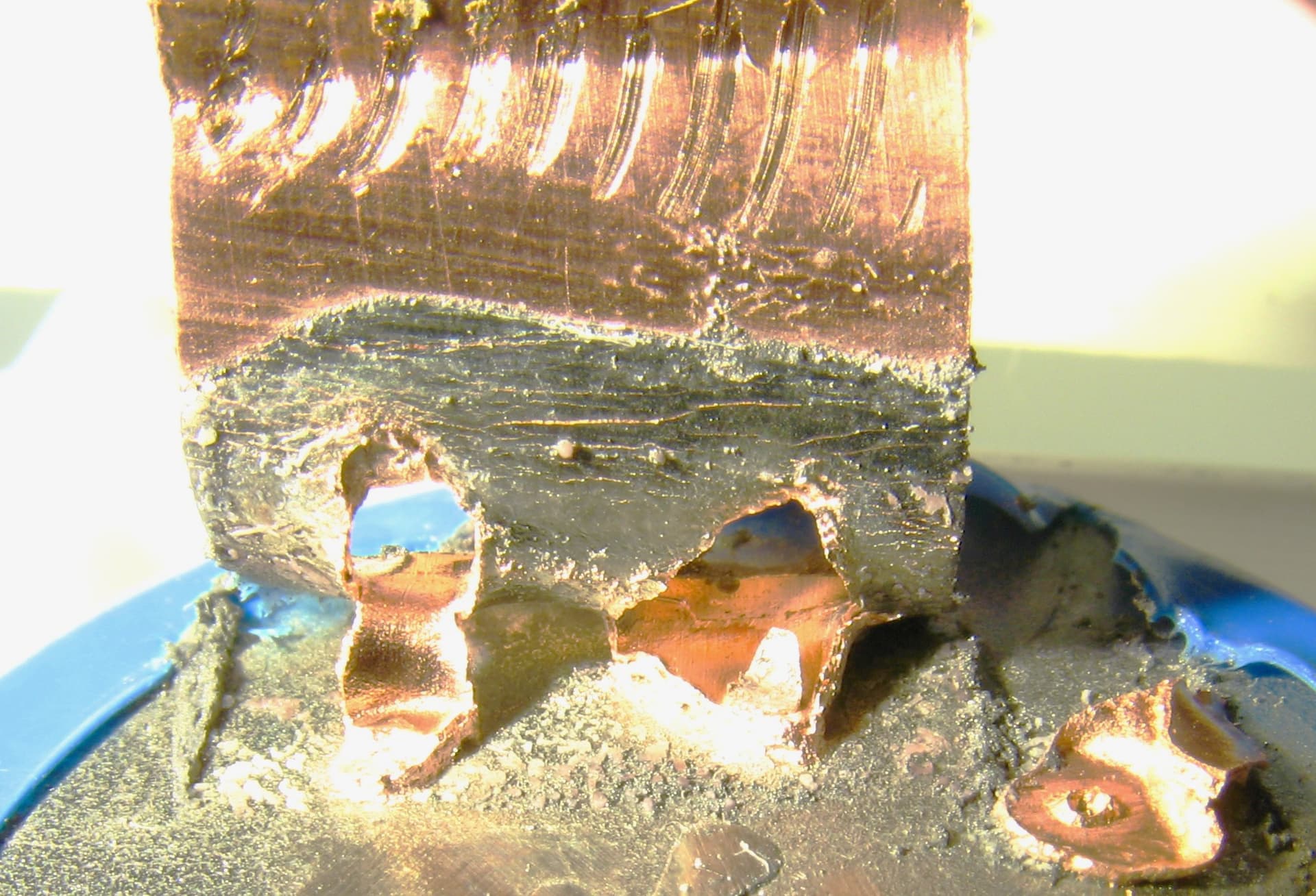

I’d pulled all three straight up again with pinched thumb and forefinger, and once again there was no removing them without plyers.
When I lifted them, I heard and felt the crunchy noise one hears when one allows solder to wick too deeply up silicone jacketed wire meant to stay flexible.

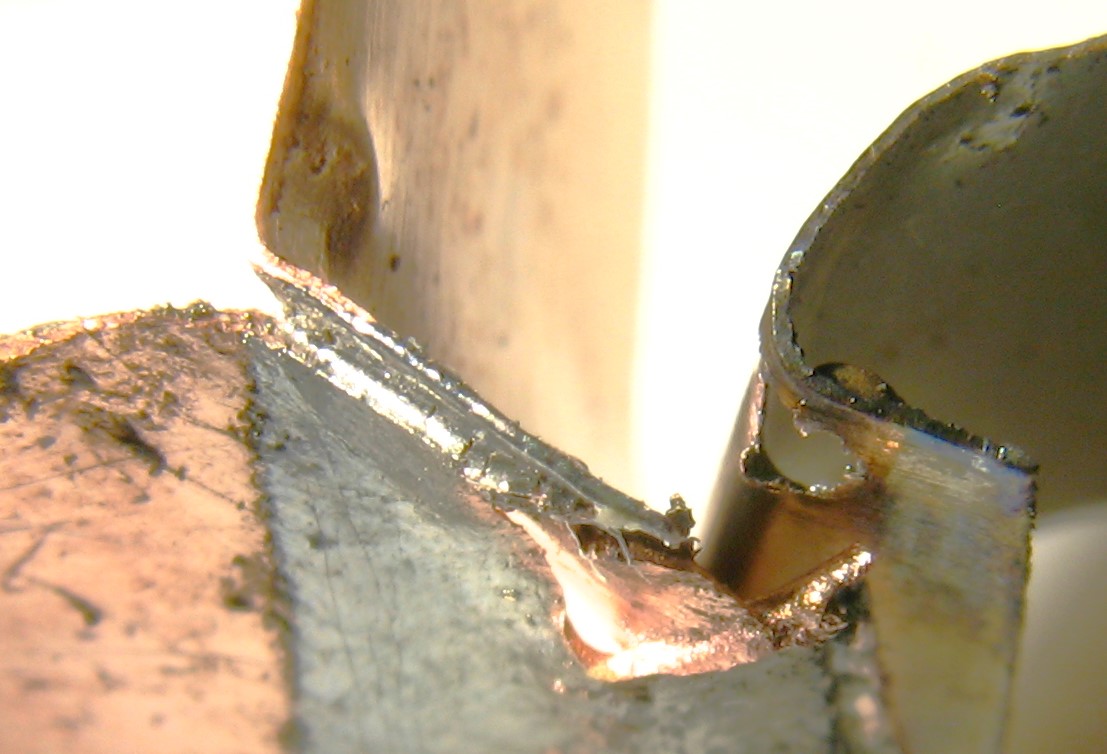

I then grabbed the stainless steel with fingers and tried to rip that layer off by itself. Not happening, had to use Pliers and copper stayed put.
I then tried to pull off the middle layer of 0.15mm copper, but it tore at the edge of the plyers.
I then grabbed the 0.2mm bottom layer and pulled straight up, with plyers and they slipped. I regrabbed it and rolled until it started to tear.
Look at the horizontal cracks in the tinning. I’ve not seen this on any other flux’d weld
After ripping the two stuck layers of copper off, I tried to separate them, grabbing the 0.15mm with side cut plyers, but not intending to cut the copper, but it tore at the cut line.
I tried again and the 0.2mm copper just ripped. This is the flux’s tinning holding the copper together, not the weld points.
After a triple pulse at gear 850, the 15 amp 9 volt power supply’s fan runs for significantly longer than a gear 900 double pulse, not just a third longer.
I think it is safe to say if you weld two pieces of copper together with this flux between, they are both welded, and soldered together.
i think it would behoove one to insure both pieces were as flat as possible with as much flux squeezed out as is possible.
This stack was welded strongly to the cell, but the copper dots left behind on the cell are lesser diameter than the previous weld.
