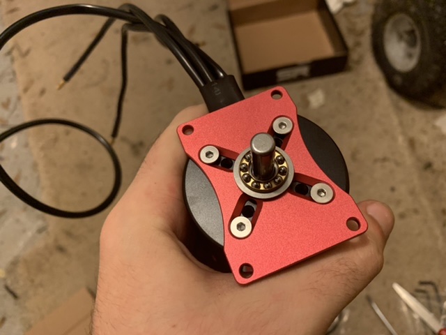

Find the red motor mount plate, it is individually wrapped with the bergmeister adapters. Place the shaft of the motor through the central hole. The grooves should be facing up. Align your motor so that the cables go towards the small side and the motor mount holes align with the grooves. Take 4 #9 screws and secure the motor to the mount plate.
Step 6: assemble the motor thrust bearing
The first thing we need to do is mount the thrust bearing to the shaft. The thrust bearing comes in three different pieces, the ball bearing holder, a tight washer and a loose washer. One of the washers will go on the shaft easily and the other will not. This is very important, so make sure to get the order correct.
The loose washer goes on the shaft first with the circular raceway facing out. Then the ball bearing holder goes in. Then the tight washer goes in with the circular raceway facing the ball bearings. The tight washer can be very hard to get on the shaft, the seems intentional.

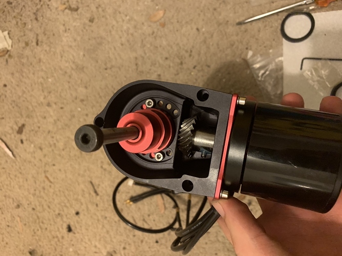

Step 7: mounting the motor gear
Tools: loctite, 2mm hex
Now that the thrust bearing is in place, we can mount the motor gear. Take one of the #7 keys and carefully place it into the motor keyway with the flat face up. Slide the motor gear onto the motor shaft until it is flush with the thrust bearing. Apply loctite to the grub screw hole. Use a #3 grub screw to secure the motor gear in place.
Step 8: mounting the motor part 2: electric boogaloo
Tools: 4mm? Hex
Take the whole motor assembly and place the motor gear through the large circular hole. Turn the mount plate so that the cables go over the top of the housing, and the holes on the plate align with the holes in the housing. Use #8 regular washers on #12 bolts to secure the plate to the housing.
Step 9: aligning the wheel gear
Tools: eyeballs, gear lubricant
Apply lubricant to the teeth of the wheel gear. Take the wheel gear that we assembled in step 3 and slide it over the axle and caliber adapter with the gear teeth facing towards the motor gear. Pus it in until it stops while turning it slightly. To check alignment, hold the motor still and rotate the wheel gear. It should rotate just a tiny bit back and forth.
Edits: photos, corrected washer instructions
No pictures?
I was writing it during my lunch break on my phone, let me go back and insert some.

Read them and weep. I updated it with pics.
