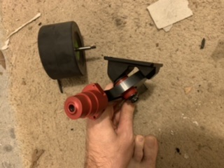

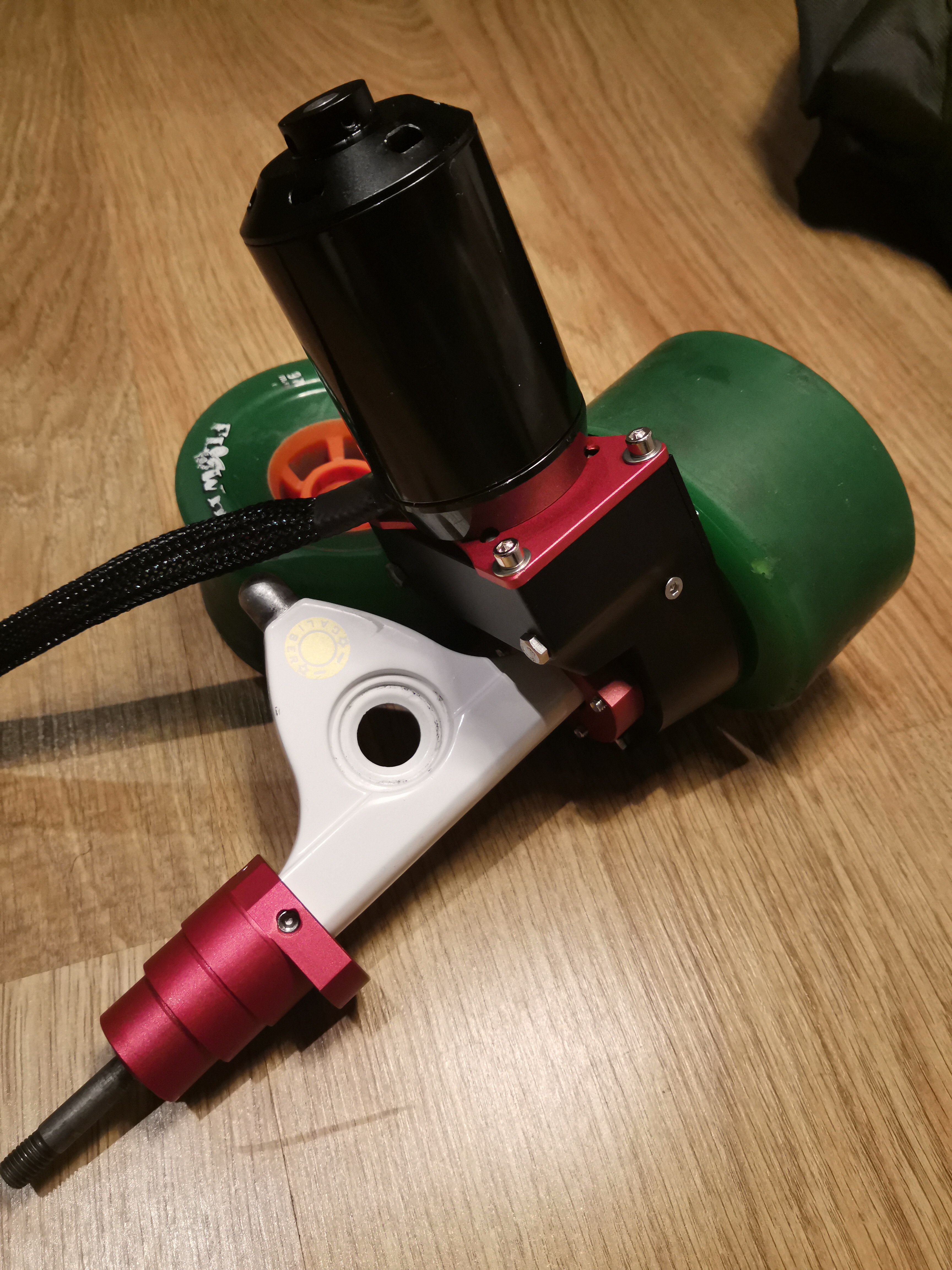

For those of y’all getting ready to build these drives, I highly recommend bracing the two top facing flat sides of the mount against two top facing flat sides of the truck, and green loctiting the flat contacting surfaces. I also recommend red loctiting the mounting grub screws. Also I recommend you get stronger hardware than the standard hardware. Seal the left over box mounting holes with silicone and grease all parts of the thrust bearings and internal gears regularly with white lithium grease. Fill the enclosure up if you can (I didn’t only cause testing).

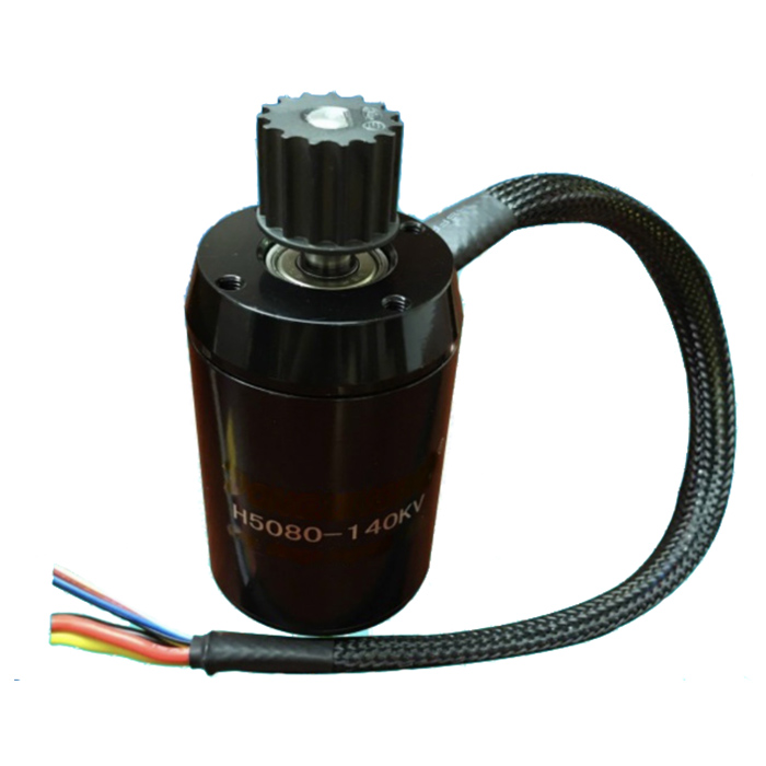

What motor?
Was thinking about slapping some 5095s on there, but it was like more than twice the price for an extra bearing and 15mm :woman_shrugging:

Note that I have a set, so if you have a single, divide the parts count by 2. In addition, I’m not using standard calibers because I like being special. I’m using @Boardnamics 220mm precision trucks, which match the caliber profile. They use shoulder bolts instead of axles, so some photos may not match an install on normal calibers.

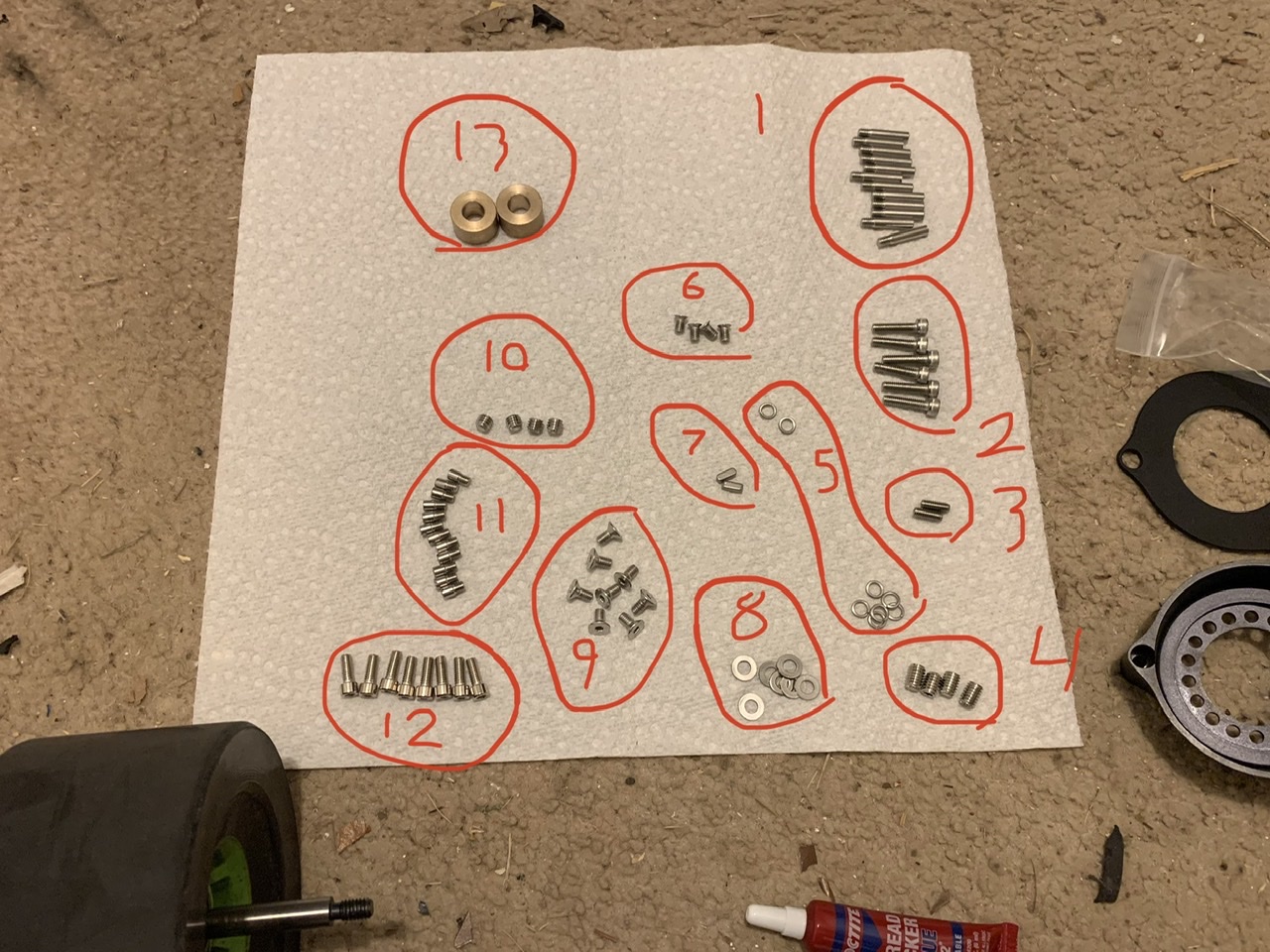

Step 1: Identify and sort your small parts
1: long inserts for flywheels
2: longer m4 bolts to hold the housing to the caliber adapter
3: long thin grub screws for motor gear
4: long thick grub screws for caliber adapter
5: lock washers (not sure where these go yet)
6: Tiny little bolts to seal up alignment holes in enclosure
7: motor gear key
8: washers (not sure where these go yet
9: motor mount bolts
10: short thick grub screw for caliber adapter
11: short inserts for bergmeister adapter
12: shorter m4 bolts to mount motor plate to housing
13: brass spacers (not sure where these go yet)
Step 2: Install the caliber adapter
Tools: Eyeballs, 3mm hex, loctite
Line up the adapter so that the bit that sticks out faces away from the kingpin nut.
Once the adapter is on the hanger, it’s time to secure it. Each adapter gets two short fat grub screws and two long fat grub screws. The short ones go in the shallower holes. At this point, you should align the adapter with the axle as best that you can. Use the grub screws to hold it in position. One by one, remove the grub screws, add the loctite color of your choice (mines blue because I screw up), and screw the grub screw back in. Once the grub screws have loctite, and the adapter is aligned with the axle, put some force on those grub screws to secure them in place. Now for the hard part: letting the loctite cure a full 24 hours before continuing. I get to cheat, my motors aren’t here yet so I can’t continue either way.
