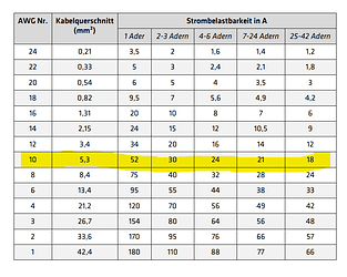

The Battery cable is this nothe so smal AWG10 ?
10awg wire can handle 150A for several minutes ! and nobody use this kind of power :wink: for a esk8, only time you can get this power is for 1-2 or seconds so don’t worry , sure you can use 8awg but its a bit overkill but yes it will get less heat because the electron’s is flowing with less resistance in a bigger wire
but again it depend on lot of thing , if they use tined copper or aluminium , etc,…
