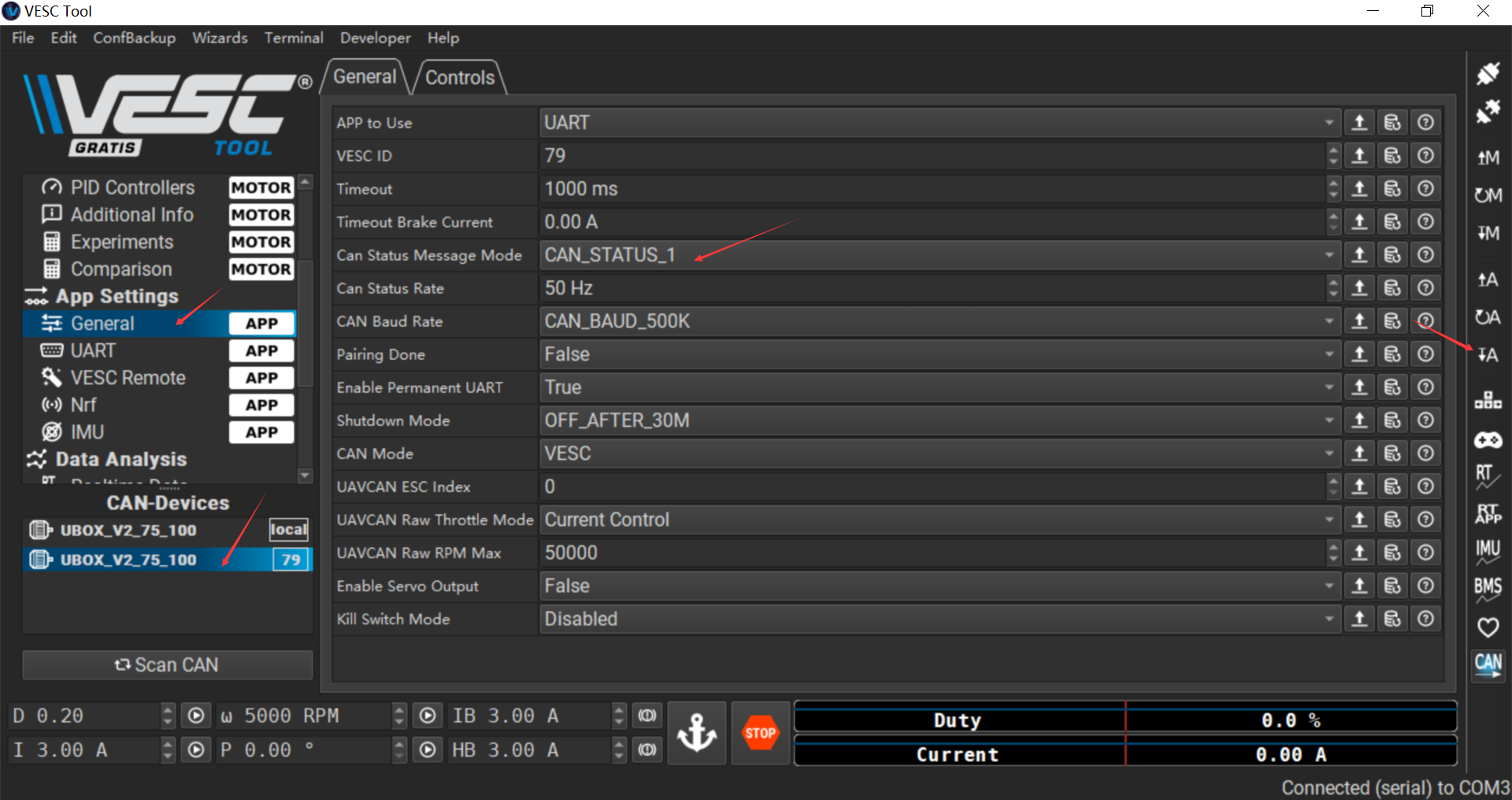

Dear Friends,
now ubox customed 5.3 firmware are available now in our website.
kindly reminds, after your updating to 5.3 , your uni1 remote has no response(it may happen to other remote, too), need to do setting in vesc tool , then it can work via UART mode.
