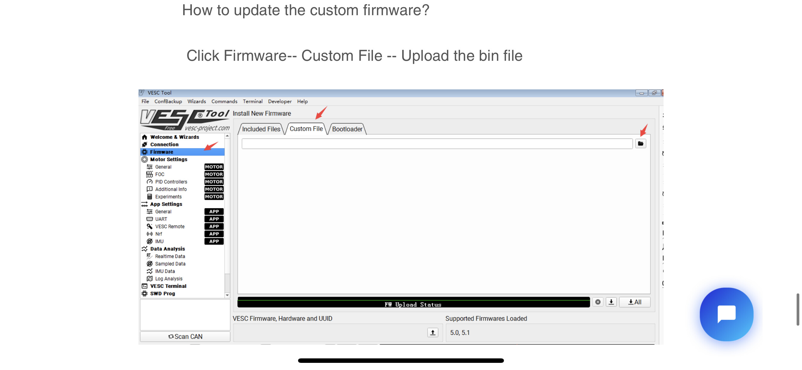

Can someone please help me with updating the firmware. I have downloaded the recommended firmware from the spintend site but I don’t know what hardware vertion to use as ubox is not in the list. Thanks jamie
What do you mean what hardware version to use?
It’s that easy. Just download custom firmware from Ubox site ( use the recommended one) and follow the instructions from the image above.
It’s this one from the Spintend site:
Where it says hardware and lists ‘stormcore, 60, unity,ect’.
I’m new to this so please excuse my ignorance if I’m being stupid.
You don’t have to select anything from that list. Just take a look at the last two posts from me and @BillGordon.
Great thank you so much, I got a warning message when I tried to up load the firm ware so I didn’t want to damage anything.
Thanks, I really appreciate your help.
You will still need to set the max values for motor and battery amps, cutout voltages etc…
Let us know if you need help with that.
