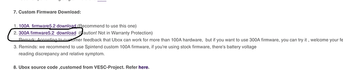

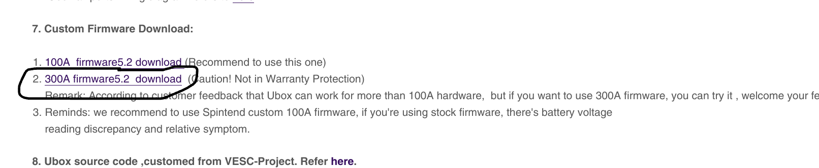

The custom firmware is supposed to fix this. It’s on the product webpage.
not since the 5.2
on the 5.2 no limits from the page and have the same issue

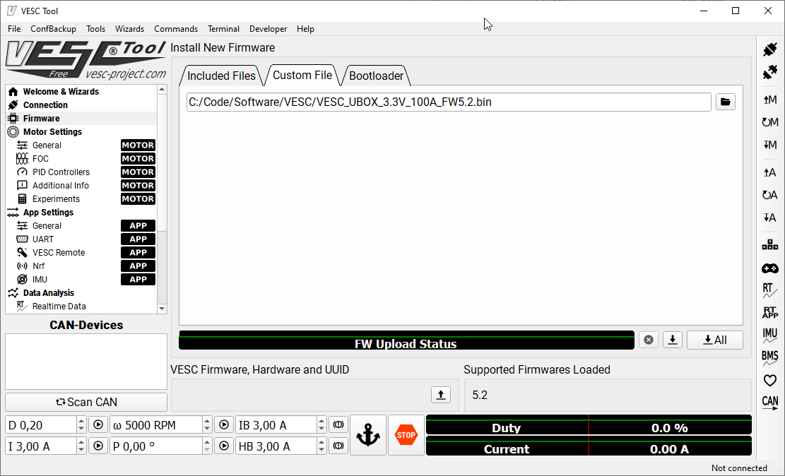

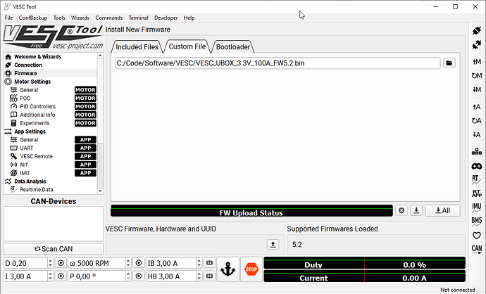

Please measure the voltage by multimetor, I did test and check the 5.2 custom firmware, no such big tolerance. please let me know the result by multimeter. thanks!

will try the custom firmware
currently on stock
What, he warned everyone over 9000 times to only use the custom firmware. :man_facepalming:t2:
which is this?
its what im using
What is it now, are you running the firmware the Ubox came with (custom) or stock VESC firmware?
the one shown above is what i am running. i dunno if its custom or stock
it calls it 75/300 firmware on the vesc tool app if thats any help
If you selected a custom firmware with 3.3V in the name, then you are good.
k will check and try again
thanks
Use the one that says recommended
will do thanks
gonna change it later

@Halbj613 cmon lmao how are you going to use stock firmware and wonder why there are problems
