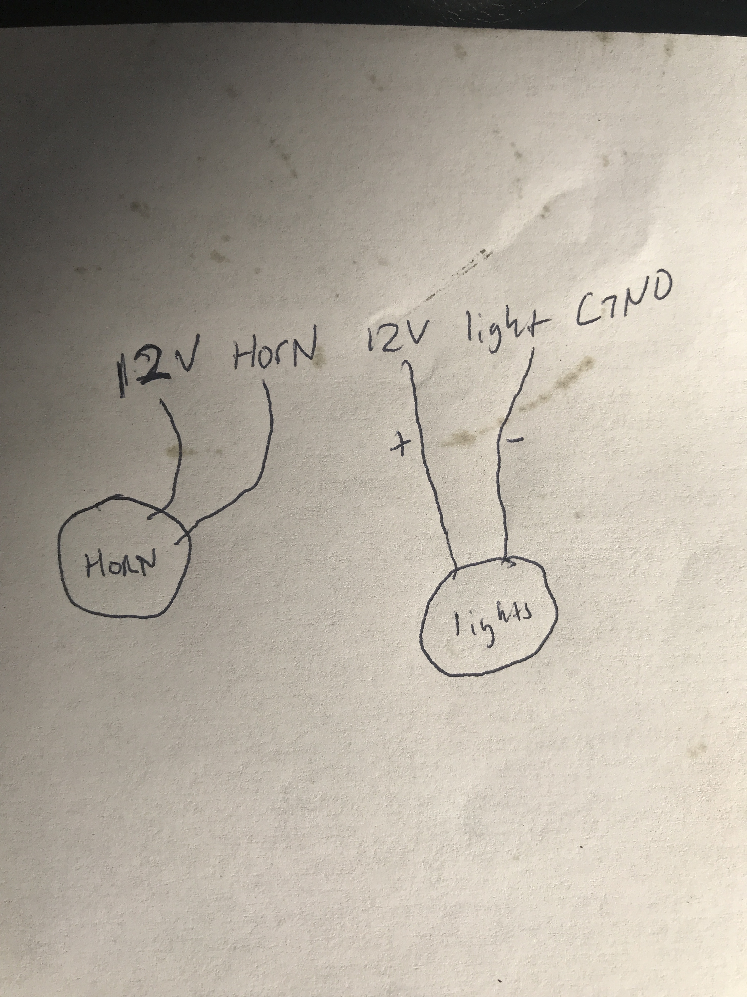

Anyone know how much current the headlight pins can carry?
Yep, just make sure you have the UART channel clear on the remote. You can only have one thing connected at a time.
Product description says that light and horn together must be 3A or less.

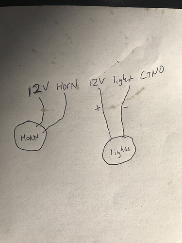

Correct. I have my positive wire connect to 12v part of the esc and my negative wire on the “light”. My horn just is connecter on the left two pins. Here is a horrible render!!!
As connector on esc only has 3 amps shared for set of lights (single light Max 0.6A) and a horn (which I will be using as well). I want to have an option to connect more lights (rear light, maybe some led strips) and 3 amps are not enough. This is why this additional Converter to 12V is needed - for more amps.
