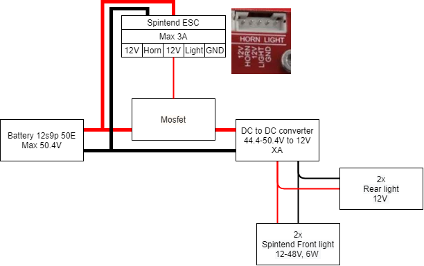

I have Spintend horn and U2 Laser gun light and want to connect more things to control with a remote light button (rear lights, maybe some LED strips), however the plug is only 3 amps on the controller. How should I implement some kind of additional converter, relay or something, so it could be switched via controller and I could have more amps to play with? :grin: Horn would still be connected directly to the controller.
Building in Fluxmotion so have some space to spare.
Yes. Mosfet. You send 12v esc signal minimal amps through the gate and it will act as on/off switch for battery connection wire to lights.
yes
Yes, you could use a logic level MOSFET to switch the pack voltage and drive whatever you wanted with it.
I used something like this before to switch lights via servo:
https://www.dimensionengineering.com/products/battleswitch
That one does work with 5V as switching voltage and can switch up to 10A.
You could have a look if they do sell something for 12V switching voltage as well.
It says 10a at 28v dc? We use about 60v
If you use 12V lights right now, it wouldn’t be a good idea to install them on 60V with this relax later anyway :sweat_smile:
Oh so you would put it after the dc dc converter? I’d rather use a mosfet before the converter so that when it is off the converter isnt draining the battery with quiescent draw
I would add a step down converter directly to the battery and just switch with the 12V output from the esc, but as I mentioned, this relay does switch with max 5.5V according to the data sheet, so 12V would be too much as switching voltage anyway.
But “bigger” mosfet is needed then as it needs to switch higher voltage? I have 12s9p 50E, so voltage is ~44-50.4V. As I understand I need DC to DC converter up to 50V as well, but can’t find anything reasonably priced in local shops in sensible form factor.

It would look something like this? And what to do with Light and GND pins on ESC?
board wiring
This is exactly what I’m going to do and I have the same question
Im curious why you have a 12v converter on a 12v? Is this for a specific reason? I personally just connected by positive on some moto lights to the 12v and the negative to the lights. If you connect the negative to the ground, you cannot control the lights with the remote… they will turn on and off with the vesc. I did this and every other time i turned on the vesc, my lights would come on in the different modes they allowed. Connecting them to the “light” pin allows you to use the remote to turn the lights on and off
So what your saying is in the diagram to control the mosfet, it should be connected to light instead of 12v
