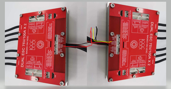

so is just put switch in parallel
what about gnd?
ground would be shared between the VESCs so you would only need the two positives of the switches and one ground, or maybe you need both grounds not sure. Don’t parallel the switch’s LED power is what he said I think.
ah ok perfect
what does the ground actually mean with a vesc cause it cant actually ground it?

thought you just said gnd doesnt need to parallel?
prob doesn’t yeah, might tho.
the LED power from one VESC is the only important bit.
does it matter if the gnd is paralled
as in will it do any harm?
hmm thinking now… the two wires need to be shorted on both VESCs so both red/black wires are needed from both VESCs
ok will try but if it blows up your to blame… jk

Ground will be paralleled anyway as both vescs are connected to gnd of the battery. Wont do any harm connecting both grounds.
If you wanted you could just use 1 wire to turn on the vesc (without the switch) , just connect a wire to the switch contact, of the other vesc
